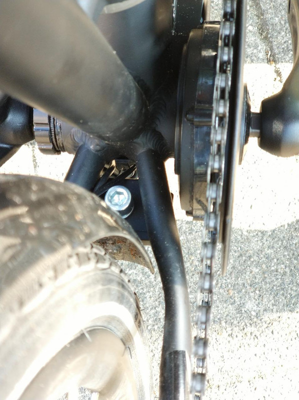

Stock chainline doesn't look too bad. How many teeth and what BCD is the stock ring? Looks like there is potential to run a smaller than 42t ring which would also play into setting the torque levels.
Just curious though how the drive side seated against the bb shell with the chamfer?

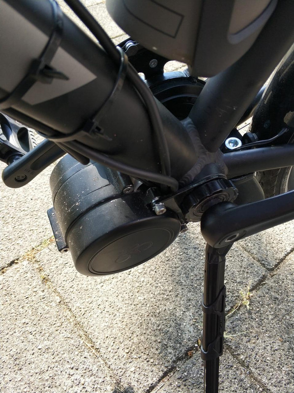

It's pretty good at my bike actually. The 42t ring is exactly in the middle of my cassette. I was expecting much worse. I'll measure the BCD when I get back to my bike again. I'm sure you can run smaller rings, plenty of room.
I'm not experiencing any problems with to those teeth at the drive side. The bb shell of my bike has a small chamfer and it bites in it. I have removed the motor several times without problems and I don't see any damage to the thread(only some bite marks on the shell's chamfer).

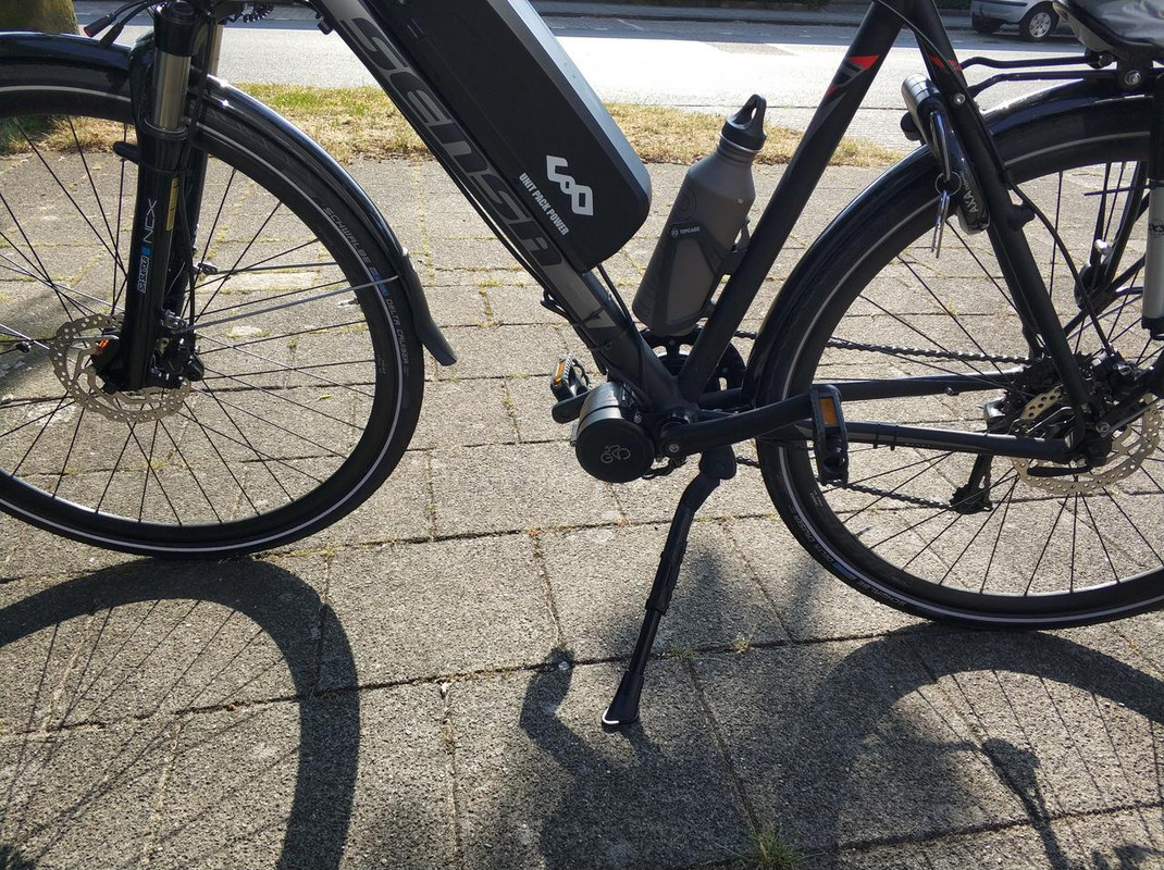

Some pictures of my bike:
mooi ah tas!,
its good to find more people doing themselves with touring bikes, i did a rear hub with a Gazelle Kathmandu , i would also lke to jump working into adding this mid drive, very curious about it
Haha, yeah, waiting for some decent bike bags.
Touring bikes are awesome for commuting. I do 15km one way and it's just faster and more comfortable than a city bike.

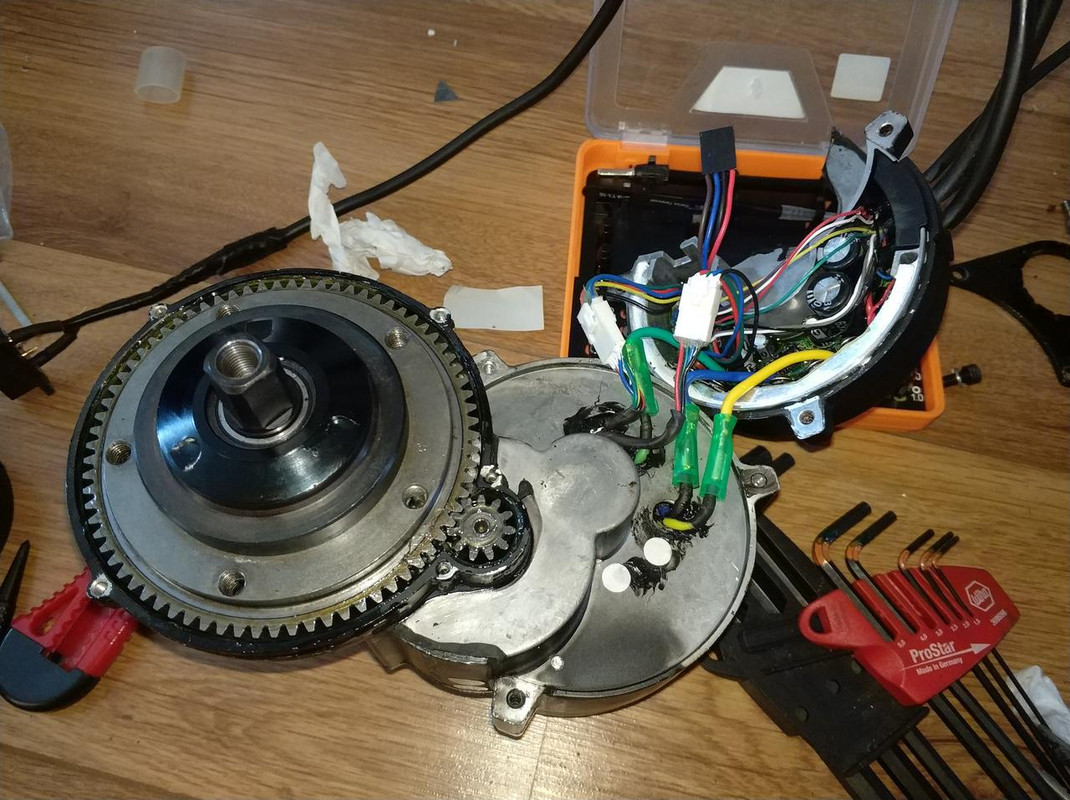

I need to correct some information based on today's findings:
- There are three hall sensors inside. The motor does not run without them(and so it is not sensorless, allowing for higher torque and smoother driving). They are latching type H4601. This is the 5 wire connector.
http://www.haierxikj.com/en/UploadFile/Photo/2016-4/2016041810390984128.pdf
- There is 4 wires for another sensor. I have seen bafang having 4 wires for the PAS sensor but the supplier claims it is PAS+torque so I wonder how this is connected? VCC, GND, Signal PAS(hall?) + signal torque? Strange.. The supplier is trying to send me a manual to disassemble the shaft so I can take a look.
- The microcontroller is the STM32F031C6T6. 32-kByte, 48MHz. Was hard to read on initial picture, now I got better light :)
So the error 24 I had in the display turns out to be a defective hall sensor. One of them was not responding causing the motor to make vibrations on high cadence speed. I sent a video to the supplier and they will send me a replacement on Monday. Very happy. :D
I explained them that the current torque and PAS balance is not optimal for every type of bike. They understand and are now going to discuss this with the factory and try to get a programming cable and software from them so I can tweak the motor for different bikes.
My next step is to map all the wires to the microcontroller so we can start on writing new software.

Inside the motor looks almost exactly like a Bafang. The controller looks very similar too. I wouldn't be too surprised if the Bafang software worked with it.
The motor is made by ex-engineers from bafang. They probably took the design with them when they left the company. Wouldn't be the first time. :lol:
The controller is not the same(they added torque control) and there are some dimensional differences. But yeah, it looks pretty similar!
The BBS software doesnt seem to work with it, there are alot of differences... of course someone more savvy may be able to make it work, but I think a complete re-work of software would be in order, considering the torque sensing differences etc...
