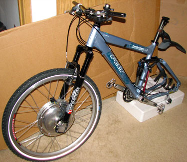

P1 started out as a humble bare frame.
Fortunately I had been working away quite diligently early last spring on a 2WD replacement ebike – trying to get it ready for my summer road trip. Somewhere along the way I became a little bit frustrated with the 9C motors by the lack of support for disk brake and idled further construction in lieu of new motor development, a project that is taking longer than expected.
With one broken bike, another stalled bike, and a free weekend I made the prudent decision to retire original ebike and part it.
<Queue theme to Six Million Dollar Man: “We can rebuild; we can make it better…”>
Like a horse with a broken leg, P0 was put down. :cry:
My old sig… :cry:
Into the Fire:
Starting at about 6:30 PM New Year’s Eve, I rolled up my sleeves, put on some good old rock music from the 60s and 70s when they made music worth listening to, with a pile of Cliff Bars & coffee, and just went for it!
The original idea was to assemble a rear-wheel drive but then I recalled all the issues that started it all with the ill-fitting rear 9C hub, and that thought was given way to creating a FWD nearly identical to the old bike. The first task then was to transfer over the front wheel. Although I had several new hubs available it was decided to keep the tried & true wheel and run with it, saving time from not having to goof around with swapping tires.
P1 (The Phoenix) is like a foal trying to get on its’ feet...
Most of the rest of the components were already loaded on the frame; pretty much starting with a good base of top-of-the-line Shimano, SRAM, Avid, and Tru-Vativ parts to pick and choose from. Intially this was going to be a 7-speed for the 9C hub, but then I got to thinking about making a FWD with a freehub in the rear as an 8-Speed, then a 9-speed, and they led to a well-stocked parts bin (and I’m still sorting this out). The bike as imaged below has the rear wheel from P0 mounted with an original 7-speed freewheel, and a new 7-speed Shimano chain. The rear tire doesn’t have a disk brake, and the new frame doesn’t support rim brakes so this would be a work item on Sunday Jan. 2nd when the stores open.

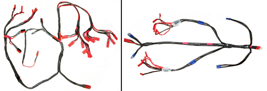

Also migrated over where all the electrical features of P0, such as the CA, throttle, 3-Way current switch & Cruise Control, HP-LED lights, Modified 6FET controller, DC-DC converter, and Blinkies. New for this ebike was the mounting of the controller; I fussed about with this until I conjured up an idea of straddling the controller directly in front of the handlebars. This effectively removes all the nastly web of cabling out from the triangle except for power and rear lights: Simple.
Another change was how the front wheel was mounted. I didn’t have the Lawyer’s Lips (I have no idea why since I have just about every other little ebike doodad on the planet), and therefore had to figure out a way to make the quick-release fork work with the motor. I resolved to use heavy-gauge solid copper wire which would deform and fill the void; I just have to be attentive and tighten the nuts periodically the first week. Two torque arms were used; the clunky steel on the wire-side and the fancy adjustable stainless on the bolted side. Two would have to be enough. Since the clunky metal side pointed down I was puzzled on how best to secure it; this was resolved by scavenging an old pedal for metal which is clearly displayed in the photo above… See it? A pedal cut in half… Yes, yes, cheap thrills here in the hovel of Kingfish.
Close-up of the controller integration from the front; functional though not pretty.
Close-up of the controller integration from the back side; an inglorious rat’s nest.

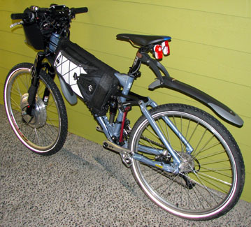

Mounting the saddlebag batteries was a bit of a chore mainly because the top-tube has a more severe rake to it and the bag had a tendency to slide towards the rear. Beneath the down tube is a free cable heading towards a derailleur; this I covered with ½ inch poly-tubing borrowed (albeit sacrificially) from my brewing equipment. The tubing was split lengthwise and placed over the top of the cable creating a makeshift protective tunnel, and then was covered over with black duct tape. The bag could then be laced in place. Afterwards the free-spin test was given and the electronics tested; everything passed without a hitch. One small note: I did not transfer the eBrake; the magnetic reed switch is problematic and for the birds. I am instead opting to give a mechanical leaf-switch a try.
The Saddlebag mounted.
It was now Sunday and I wanted to make the ebike a bit more presentable on its’ maiden voyage to REI. Since the frame is a metallic sky blue, I thought that the Canary Yellow faring would appear to garish. Therefore I decided to revert back to the White and Black theme which was already partly constructed. The forward faring almost became all-white, a wild hair developed and I settled in on a black stealthy faring with a white rally stripe as being more fetching. In addition, I added an internal deflector that provided the faring with shape as well as reducing the front tire spray. The fenders on this beast are nearly shite and wobbly; something else to fix or replace.
Side View
Rear-Quarter
Front-Quarter
Front-Quarter View dim light visibility test (meaning my flash didn't go off)
Front View in dim light (durn pesky flash...)
And that’s the way I drove it over to REI to get a new wheel made: Rear wheel is crafted from a double-walled 26-inch DA16 Alex Rim, using DT Swiss Competition Spokes connecting to an older Shimano Deore XT Freehub (about two generations old). The Freehub is 9-Speed 11-34T late model Shimano from 2009. The disk rotor is an Avid 203mm. I also purchased a Shimano 9-Speed chain; surprisingly one of the few items I didn’t have in my inventory. The studded tire was transferred over to the new wheel.
After the installation I rode the bike home in 20*F weather with tires gripping quite well. The final details included moving the Wellgo BMX pedals over (I don’t want to deal with clip-ins during the winter), adjusting the disk brake, and fine-tuning the pressures in the two shocks. It’s not finished by any means; I still have to fabricate a rain-proof faring specific to this frame, and I have a 7-speed shifter than needs to be swapped out for a 9-speed. Details details details…
But enough already; it'll do to get to work and beyond. There will be more improvements on this frame and bike as time marches on.
Cheers to my Phoenix, P1 by another name. :wink:

Nice full suspension frame. What kind front fender are you using it and I need get one for my new ebike building.
Kingfish
Feb 3, 2010
4,064
Redmond, WA-USA, Earth, Sol, Orion–Cygnus Arm, Mil
Fenders, both F&R are X-Blade, purchased from REI. I saw an interesting set over at another bike shop, might have been the Specialized dealer (yeah, it was ‘cos I had to fetch the Specialized Rim Tape) – they were made by Topeak.
The part that I don’t like about mine is that they are not straight and true: There is a noticeable twist from front to rear – like they didn’t make the mold properly and when the plastic was released it still had pliability to it and cooled with a contorted twist. If you’re mudding it won’t matter.
I would see if you could get one mounted before you buy it to see how it looks if looks bother you (like they do me) :roll: :)
Cheers, KF

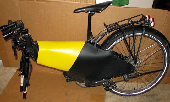

dV, da happy face was for da yellow bike! Dis bike is gonna git mustang racing stripes! YAAAAA! :twisted: I already boughts a padded handlebar wrap that says “Hot Wheels!” - you know, like the little Matchbox-cars logo :twisted: 8)
Frame: That came off of eBay in November 2009 methinks with the idea of building a 2WD for winter. I also bought two hubs, F&R from ebikes.ca – but as a lark I decided to use P0 as the test bed victim instead of messing up a perfectly good new frame. The MSRP on the Felt Compulsion 1 frame at the time was about $1500 or $1600 dollars. The eBay price was much less; when received the frame looked as though it was previously assembled – like someone parted out a floorshow model. Beyond that there were no obvious signs of use. I thought it was a heck of a deal!
The key factor in my search was the open triangle, and the Felt design opens that right up as much as one could hope in a quality FS bike. The only thing I don’t like about the frame is the color; in 2010 they switched to white. But this is a tiny issue – even though it prevents me from using Canary Yellow, causing frightening levels of insomnia finding a proper matching color of HDPE, and, and… <yawn>
Here’s the link to the technical details about the frame.
Pedaling: It feels like a boat front and back. However this is because I have little experience with this bike, and have yet to properly dial in the front Marzocchi Shock and the Fox rear shock both in terms of pressure and rebound. I plan to carry the pump with me for the next few days though. :wink: As far as downward force goes – the bike already has a dampening mass called a battery pack weighing in at 23 pounds. I haven’t really got on it yet, pumping hard like an ox climbing a hill because the streets are wicked icy and frankly I am very glad to have studded tires so that I go straight and forward instead of flipped-over and run-over by crazy people. :shock: But let me get back to you on that when it warms up and thaws this week (fingers-crossed). :D
Rear-motor pushing: I couldn’t say because I didn’t feel comfortable mounting the 9C RH – it was too wide for the frame and scratching it in a nasty sort of manner. This is why I am seriously considering designing my own motors, and if I am going to go that far into the mechanics of the design I might as well fix a few other goofy oddities as well – aside from making it more efficient… but I digress. I suspect that the motor will shove the frame up and that I shall have to reduce the sensitivity somewhat to avoid pogo. The good news is that I can always swap out the shock for a more modern version with remote adjustments should it come to that.

Ja! A black pin-stripe down the middle would do it; have to hit an auto parts store today, wipe it down with alcohol, and plaster it on. I’ll have to take the “2694” number back off ;)
For the sides, I was thinking a solution similar the yellow-jacket; a black wrap with white HDPE sewn in, followed with a black stripe down the middle like the mustang photie. Probably won’t get to that until the weekend... I think that white does nearly as good a job as a reflective band. 8)
Also – I need to put a grill and duct-work right about in the center of the front faring:
The controller is directly behind the center portion; it’s fine right now in the dead of winter, but come summer it will roast. I am thinking some reflective aluminum tape on the inside surface of the faring, a horizontal U-shaped notch about center, maybe 1 x 4, construct an ABS channel (or use any numerous pre-existing Home Despot moldings), and place it so it directs the airflow directly upon the controller’s FETs (which on my unit are pointed upward). This will create a laminar flow of cool air pulled in by low pressure opposite of the faring, likely in a dual vortex pattern, and cascading over the Heatsink. Eliminates both drag and heating issues. The front of the grill would need to be inventive: Chrome anyone? Or blackout webbing? 8)
BTW – I mounted a SPST Submini Lever Switch in place of the Magnetic Reed Switch for the eBrake and gave it a spin: Works like a champ!
The 3-Way Current-control and Cruise-Control unit may give way to Directional switching: L/R/Horn. I never really did use the 3-Way, and the Cruise was only useful for cross-country. I definitely want a horn for cars. :twisted:
<sigh> Toys for boyz…
<Diabolical snicker> KF

Ah lads, today was the first day on the road commuting, and yam here to tell you with the temps rising to a balmy 37° it was a right bloody mess with all the snow and ice melting into various states of slush, gunk, grim, and who knows what else was in the mix. I discovered a new “feature” about these studded tires: They do an excellent job of catching the crud and hanging on to it as the wheel spins around till just when it hits the optimum angular velocity at 180° releasing straight into the wind and flipping so it heads back at eye level… all the way up to my destination for a meeting with the Boss & Team. The spray pattern upon my fantastically lemon-neon jacket was absolutely perfect for blending in with the gutter; I couldn’t have done a better job if I was trying. And at 33 mph the distribution pattern definitely increases in width and breadth, although at a wimpy 18 mph it’s just a tiny squirter and not worth the bother. No, go for it with gusto to get that grimy smile and make points with the Team! Yeah… 8)
<face shield down>
Speaking of smile, after I got back home – it was dark and all, I was about to pull the bike into the secret hidden urban bat cave when I spotted this sly grin:
Would you look at that! I done think P1 had a better time today than I, and that’s pretty dang happy if you ask me! :D
dV, I can now quantitatively express how the ride went today most completely. At slow speed the ride is a little bit soft; possibly could use another 10 psi in the rear shock just to keep it from bottoming out. However at WOT this bike is an absolute dream and it really levels out – sort of like how a boat comes out of the water and planes nice and level at higher speed. It is nimble, responding to the slightest notion with ease and comfort. I was so distracted by how smooth it was that I actually enjoyed the cushy ride and before I knew it there I was 11 miles later at my destination.
The road rumble and studded tire razzle melt away and are hardly noticeable, whereas divots and pebbles are still felt, but then greater drops and larger bumps are smoothed out – which leaves me to believe that the pebble-size is a hole in the attenuation spectrum; I’d wager a gravel road would not be so cushy. Beyond that, the ride exceeded my expectations ~ but then I went into this with an open mind and frankly didn’t know what to expect.
Other observations:
  • I did not experience pogo or up/down dampening issues; there is however a slight side-to-side wobble from pumping hard and shifting weight at high speed/WOT – but it is a minor thing and not a bother.
  • The bike feels light; it strongly feels like the front end is going to come up, like there isn’t enough weight forward, like a gazelle trying to leap out of the reigns. I found myself struggling to put it in horse terms: If P0 were like a Quarter horse – strong, versatile, agile, durable – then P1 is like a stallion, it wants to race and be driven hard, yet it is responsive and gentle; truly as John put it earlier - a complete step-up. I no longer doubt the utility of the bike; it will make an excellent platform for the AF tests.
  • There are some issues to work out – other than the mud-slinging wheels. The X-Blade fenders are a pain in the rump and not worth putting up; I am well motivated to take the fenders off P0 and make them work on the new frame.
  • The gearing is too slow and low: P0 was using a ratio of 13:54 ≈ 1:4.154, whereas presently P1 is 11:44 = ¼ and wearing me out. I have a 48T chain ring but the derailleur is too short; work item.
  • There are no mirrors; the handlebar-end-mounting won’t work because the carbon-fiber type handlebars evidently get progressively narrower on the inside. A typical motorcycle mirror uses a 10mm screw whereas scooter mirrors are 8 mm. Not sure where I can put these though. My first though was to screw them straight into the Shimano Shifters; they have a 5mm screw that holds the assembly together right in the center, and that would make for optimum placement. Possibly work-item: 5mm Male to 8mm Female adapter.
  • I’m in the process of replacing the hacky ½-pedal torque arm with a modified heavy-gauge 5x5 angle bracket I snagged at Home Despot tonight. Actually I bought two; one for each side. There is security in having solid torque arms, don’t you think? :)
That’s me; done. Ready for dinner & a movie.
<Mmmm…> KF

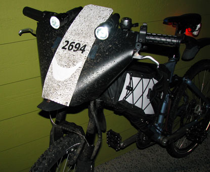

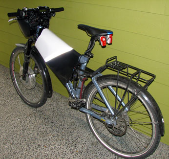

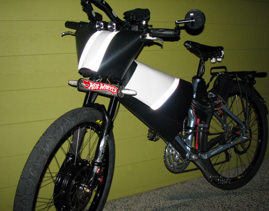

Been a short while since I last posted an update so here it goes…
The Blacksmith’s hammer & anvil have not been silent, no. Like a Damascus Sword, the ideas have folded over and over again to forge a better beast from raw material and off-the-shelf product. In the past month there have been four prominent changes:

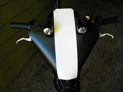

The faring is the one topic not yet covered and has been the last modification applied. The image below is how the battery bag & bike previously appeared.
Black & White Faring
This new frame has a slightly different triangle shape with wider tube members, especially the top tube which has a taper that is widest at the front and narrowing as it heads aft towards the seat post. Technically the distance between the steerer tube and seat post is farther away to accommodate the rear shock. Where P0 had an exposed cable running across the top tube, P1 has the opposite condition running along the bottom of the down tube. The problems with the battery bag were pretty much the same as with P0 before adding the faring:
  • It was wide enough to cause chafing of my winter trousers
  • The batteries were getting wet (although for a time during the sub-freezing weather this was less of an issue)
  • Excessive road splatter created a cleaning nightmare.
I knew it was unfinished; something had to be done, and I waited until an opportune weekend to do it. After stripping off the plastic bits and rope, the (formerly) top flap of each camelback bag was cut off, essentially slimming down the profile by nearly a ¼ inch per side. Next I added protective tubing to the bottom cable in precisely the same manner as with P0 using old Homebrewer’s spare tubing and Black Duct Tape. I also took the opportunity to restring the battery bag forward about 1.5 inches so that I could access the front shock air attachment for future adjustments. The image below displays this part of the story as completed and before the application of new faring materials.
Stripped, clean as a whistle...
I detest water spraying up onto my batteries. Borrowing material left over from the Epic Battery Bag Story, I took a large shingle of black 42 oz. Vinyl-coated Polyester and cut out matching Left & Right pieces that would cover the exterior, like flexible water-proof armor. Each side was uniquely fitted to completely cover the exposed front, bottom and sides, requiring minimalist sewing to create the conformity with three modest seams. Extra material was provided at the top where the halves met so that the two pieces could be sewn together. The remaining edges were punched and secured with grommets. Sturdy shock line was used to fasten it into place. Except for the bottom where fastened, the bags should now be well-protected from water. This heavy vinyl covering looks in the pictures as if having a diamond-plate pattern; that is in part deception upon the manufacturer for the reinforcing weave is heavy though the pattern is faux. It is tough stuff to punch through and does not easily rip or tear!
The next part of the armoring is the HDPE. The Black Vinyl does a great job at protection but I needed some bright color for better visibility. Yellow doesn’t look right on this bike, though White does. The covering is slightly smaller than what was used on P0, mainly due to geometry and best fit. Once trimmed up, it too was punched and secured with nylon line.
The last bit of HDPE took the most time. I used Black to create a better-fitting forward cowl and was able to keep it in one piece along the entire length of the bottom. The top of the cowling wraps over the top tube and is modestly secured with zippies whereas the the bottom uses Velcro. Funny stuff Velco; the forward section where it meets with the White plastic is stitched in place whereas the rear section is super-glued. I think if I had to do this again I’d forgo both methods and use Urethane instead. Regardless – there have not been any issues to report; the faring assembly fits flush and is quite aerodynamic: it feels like I’ve picked up another mph in the slipstream as wind rolls right over it.
The final addition to the faring is the 1-inch wide Reflective Striping. For some reason I only had a yard of this stuff so I put one along the trailing edge of the White faring to visually mask the overlay, and the remainder went on the front faring. It’s very reflective in all lighting conditions. The sticky-back is likewise very grippy even on Polyethylene.
Catwalk Gallery: Take a bow. Apologies for the filth – it is winter and I do ride the bike nearly every day.

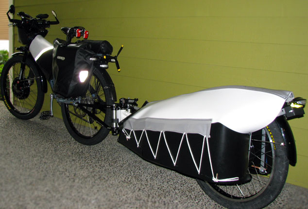

Oh time to update this project! The last picture posted was the FWD version that was used during the Winter and Spring of 2011. In May, I began the redesign and construction of a Push me–Pull you FWD eBike and pusher Trailer in preparation for my next road trip to California. Below are pictures of that assembly prior to launch.
FWD eBike with two controllers to support the pusher-trailer when attached. This version is technically labeled P3 because I have completely rewired the whole bike from end-to-end with new handlebar controls, new motors, new 12-FET controllers, indicator signal lights, active taillight, integrated eBrake & Stop light, two CAs, and trailer cabling interface. All battery-operated components run from one battery, and use the DC-DC converter to power the auxiliaries. I also employed a key-lock switch to completely disconnect the electrical power. In addition, I replaced the Meanwell S/SP units for bulk-charging with the faster HRP-600 Series which required zero-modification. New hardware included disc brakes, custom torque arms, and a new Brooke’s saddle.
Later I swapped out the chainrings, crank, and bottom bracket for a Campagnolo 53-39-30 Road Racing chainring & crank, a Phil Wood BB, and a Campagnolo Braze-on Derailleur. In order to mount the derailleur I designed a custom MtB Braze-on adapter. This provided an available gear ratio as high as 53-11. The views below include this modification and are taken just before my first (false) start on my journey to California.
Top View: Note that the right pannier is not mounted (cos I have the camera out).
Rear ¾ view. In 2011 I changed out my Ortlieb panniers from yellow to black to match the B&W theme.
Alas – there were problems with the pusher-trailer, namely the framework twisted axially and created an extremely unpleasant situation above 5 mph. This configuration was therefore abandoned. However – I was able to keep the pulse alive on the road trip by removing the hub motor from the trailer and mounted it instead onto the eBike, creating a 2WD in the process. The trailer frame was stiffened by injecting foam into the tubing (this is all covered in the trailer thread). After a couple of weeks or reintegration and bug-solving the assembly was ready again and I launched a successful road trip to California and back as a 2WD eBike pulling a traditional trailer covering 2500 miles over 28 days. This eBike configuration I label as P4 because I had to make and hardware wiring changes that were unique and specific to the activity. The design continued to evolve On the Road as I resolved persistent nagging issues one-by-one. Below are pictures of this assembly from the road. Each motor has 2 hp programmed into the associated controller.
July 26th, 2011 - Spanaway, WA: First day on the road to California. Look how spiffy it was! Difficult to believe I am hauling 100 lbs. of LiPo.
Changes include the addition of fenders front and rear, rear torque arms, rear freehub was replaced with a hub motor with an 8-speed freewheel. The front wheel is 26 inches using the Mavic EX 729 Disc rim, the rear and trailer wheels are 24 inches using the Kris Holm Unicycle rims. All tires are 2.5 inch wide Hookworms. The Harley-Davidson tool bag is mounted over the rear tire, although I moved it over the saddlebags a couple of days later to reduce the handling problems and wobble: The rear suspension can’t take a lot of weight mounted above the axles.
This is picture of the assembly just before I crossed the Columbia back into Washington after 27 days On the Road. The rear fender was a pesky biotch the whole way cos the bike frame was not designed to support fenders. The modification I created split the fender into two parts: Rear over the tire, and a short front splash-guard which protected the linkage and front derailleur. When the suspension would pivot in the extreme, the rear tire would crash into it and make a horrible grating sound; most annoying. Eventually I had to remove the front section and that eliminated 80% of THAT problem, although there were many other issues with the rear suspension et al. Though essentially useless, the aerobars made the bike look even more badass and were a convenient place to hang my helmet :lol:
August 22nd, 2011 - Bremerton-Seattle Ferry crossing over the Puget Sound. Regardless of the pesky issues, this design worked very well. Although I had one flat tire, there were no show-stopping failures; lots of mods – yes, lots of tinkering – sure, just no failures. :wink:
At present I have the trailer disconnected and the Ebike is used for commuting. It will do 42 mph on a flat, although I prefer to ride at 32 mph.

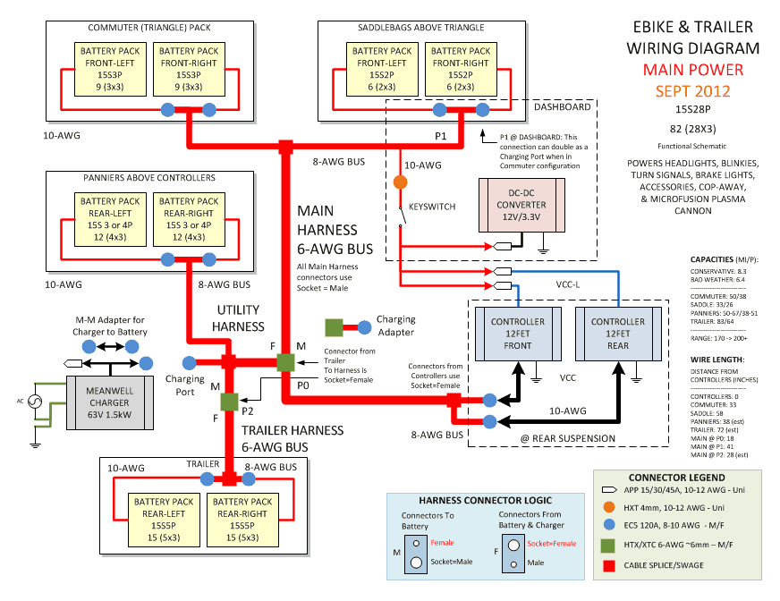

  • Battery Harness completely reengineered: The primary goals were achieved for the Commuter pack although some details remain for the secondary packs.

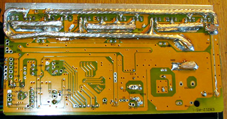

  • FH Controller Current Mod (was Master) Evidently I missed upgrading the traces, so these were beefed with 10-AWG twisted wire.

Battery Harness:
The next big mod to the bike factored in my continued frustration with Anderson Power Poles, and I decided to replace the entire lot with regards to power distribution. The APPs are acceptable for the Phase connections; with contacts removed from the plastic case, they are the only connectors I know that can slither out from the nut, washer, and hub cover. All APPs between the Batteries and the physical controllers were replaced using EC5, HXT 4mm and XTS150 6mm Barrel Connectors. Previously the Main Harness was a kludge of 10- and 8AWG. No more: The Main Harness, the Utility Harness, and Trailer Harness are now all multi-strand Marine-Grade 6-AWG. All connections to batteries are via 8-AWG links, using EC5 connections. The Harnesses themselves are interconnected using the XTS150 6mm connections, and there is one HTX 4mm connector that uses 10-AWG wire to mate with the DC-DC Converter which supplies 60W of 12V & 3.3V power to the bike accessories and lighting. The 8-AWG links are mechanically swaged onto the 6-AWG harness using a Hydraulic Crimp Tool. The swages are actually 0.03 thick wall copper tubing; it’s stronger, faster to assemble, and more conductive than the tedious solder methods I have previously employed. The weight of the harness is about 3X of the original, and yet, I am certain that the resistance of the new harness is likely 10X less. My hope is that this will end the voltage sag issues that I’ve been experiencing when On The Road.
On the Left, the old nasty kludge of 10- and 8-AWG. On the Right, the rebuilt robust & streamlined Battery Bus.
There’s a second part to this mod in that each battery unit consists of a small assembly of three 5S batteries connected in series to make 15S. These “units” are then connected in parallel as assembled packs, and they connect to the Harness via the newly minted 8-AWG wires. The wires that connect the units together I call “collectors” for lack of a better term. The wire gauge from the batteries has been 12-AWG, although somewhere in the last year or two of production Zippy FlightMax changed to 10-AWG. For whatever reason, all my collector wires are 12-AWG and they are unified into a 10-AWG wire which connects to the harness. All of these collector-unions are this way; the physical union is wire-wrapped together and soldered, then covered with heatshrink in an incredibly long and tedious and laborious process. I need to change these all out to have the maximum benefit of the new harness as: 10-AWG silicone wire collectors into swaged 8-AWG unions: Altogether a work item of 28 collectors and 8 unions. Doesn’t need to happen right now, but certainly could be a rainy day project.
The Battery Harness is part of a larger system for the entire ebike and designed to serve me for cross-country. Below is the master EBike & Trailer Wiring Diagram for Main Power. (Apologies for the large picture.) I like drawing up my ideas and refer to them frequently during construction.
It can be viewed separately here...
Front Controller Current Mod:
For some reason I had not completed this mod before heading out last summer. The FWD never had issues; it was the Rear that would drop out during the most extreme loading. Very odd. Anyways, this mod was completed using 10-AWG stranded copper wire on the power and phase traces. The battery wires were upgraded to the same 10-AWG, although the phase wires remained 12-AWG: The FH is down-rated slightly from the RH by about 20% to prevent the front wheel from spinning during inclement weather.
Shiny Happy PCB
