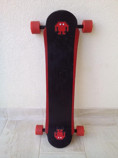

After some days spent planning and modeling all required stuff I went shopping. I bought some hardcore paint and wood putty and repaired my worn deck. Mountaingboard was MBS Atom 85.
Before:
After:
Don't even ask how much sanding and painting is required for a good long lasting result. About 5 layers of water based wood paint, few layers with red paint and three layers of clear lack for parquet on top. Took a bit less than two weeks.

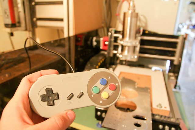

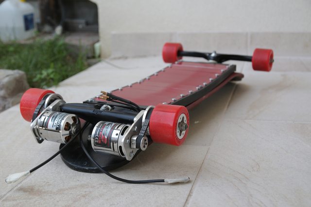

Then I machined motor mounts, pulleys and pulley mount for wheels. This part was somewhat easier because it didn't involve sanding on hot summer days. I machined all of the parts with my diy mini cnc.
Wheel with pulley:
My machine in the background (another on the far left). Yes I have Nintendo controller for jog. :mrgreen:

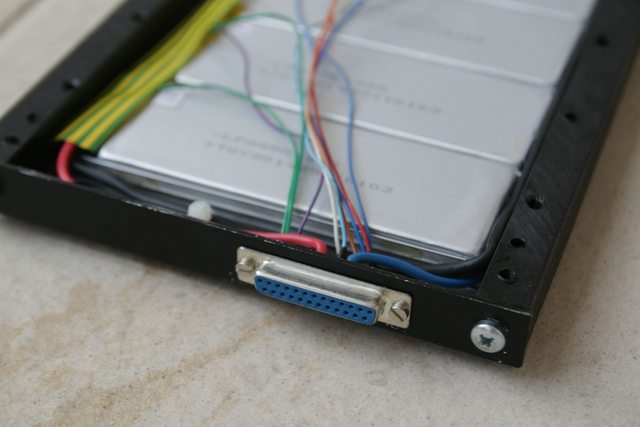

Then I built a hardcase for the batteries. Two 15x20mm plastic rods on each end connected with 2mm flat aluminum profiles had the job done. I used DB25 connectro for charging and balancing. It has 25 pins and each pin has 2A current capacity. So I used 16 pins for main charging wires (which gives me 10A of charging current capacity with some reserve) and 9 for balancing. 1 pin is left unused. Cells are Turnigy 5000mAh.
Cells inside the new pack:
Charging connector:

Motors mounted. I'm using HTD 5M 12 and 32 tooth pulleys.
