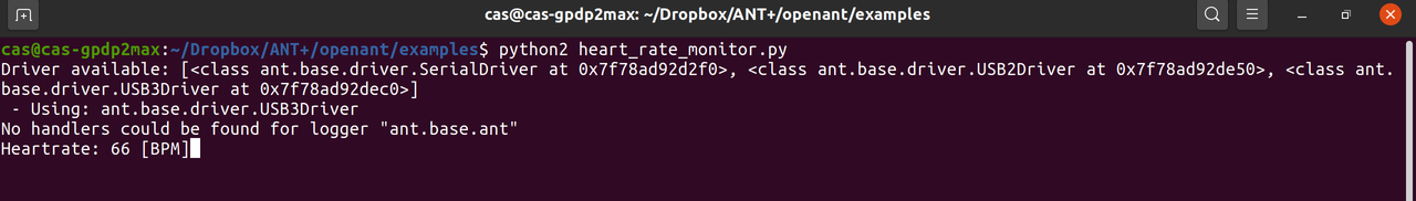

I connected an ANT usb dongle to my PC. I used the Python https://github.com/Tigge/openant and did run the examples/heart_rate_monitor.py , which worked and could read my heart rate value which my watch broadcast:
This option is nice because means I can use my PC as an ANT+ LEV ebike, which will be much faster to test and develop than using my Garmin Edge for it. Still, this means I would have to implement the LEV profile on this Python library.

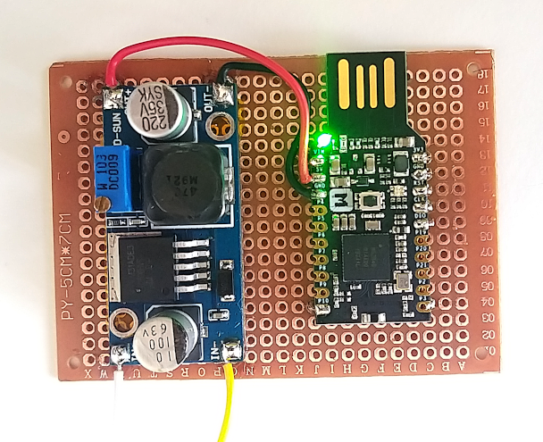

I got the board and did solder it with the DC-DC converter board:

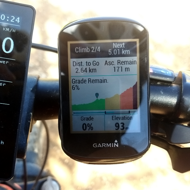

We did a trip on last 5 days, 3 ebikes with TSDZ2 and 1 ebike with a Bosch motor. I really hope to use this project for our future trips and have less cables / risk of something fail:
Also I love the feature Garmin Climb pro that shows ahead the next climb - I want to remove the 860C display from my handle bars as soon as possible:

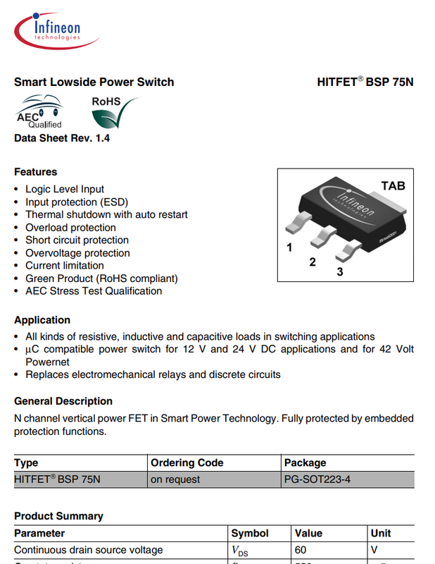

Thanks for the suggestions. After looking at the solid state relay on ebay, I found one that seems better and cheaper: BSP75N.
I want something that is small, light, cheap and uses very low power for not drain the battery. Also one that is simple as possible to solder because I think that this board will be DIY as I do not plan (I don know how to do it) to design a board and sell it.
The BSP75N should use something like < 100 micro amps.
(Seems there are other alternatives like BST117).
I hope they can really work with the 60V:

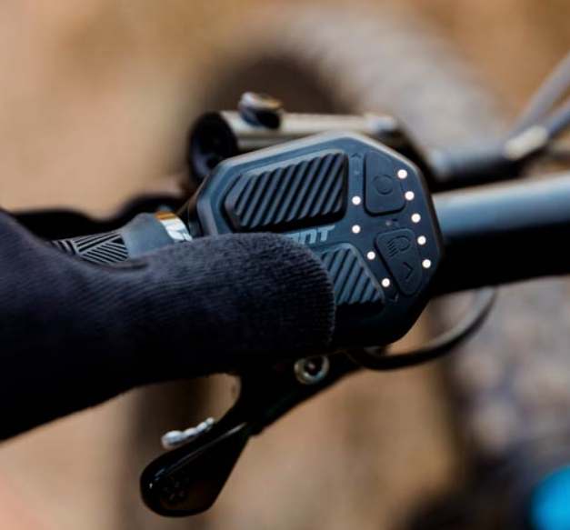

Because the idea is to replace the current on/off button of display to a on/off switch controlled by the wireless board, so the system can be turned on/off using a remote wireless button or the mobile phone.
Like this one, fully wireless: https://www.liv-cycling.com/global/campaigns/ridecontrol-handlebar-system/23297

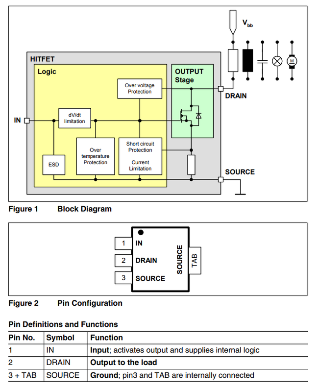

The BSP75N and the BST117 won't work to switch the 60 volts. They are low side switches (to switch the ground), what you need is a High Side Switch like the BTS4140N for example.
Hi Casainho,
Unfortunately I think Giant has the buttons wired.
It appears that the 2020 version of the RideControl one buttons also has ANT +. The 2019 version only had bluetooth.

I have good news:
- I got the ANT+ heart rate sensor example code working, that my Edge GPS cycling computer immediately detected. The issue was very simple, I was not setting up the ANT+ keys. The 4 wires seen on the picture are the JTAG SWD for flash and debug the code.

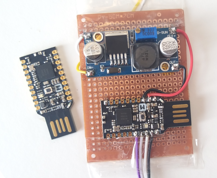

- I received my second NRF52840 board as seen on the picture. I want to cut the USB connector area because it is not needed and will make the board small. That space can be used for the switch to power on/off the TSDZ2 motor controller.

The board is this one: https://wiki.makerdiary.com/nrf52840-mdk-usb-dongle/
The power board is the one bought on ebay, the most cheap fro 60V input.
Draw a simple schematic. Include the BTS4140N to power on/off the TSDZ2 power, see the previous discussion here.
Give me your github ID so I can add you with write access to the repository and then you can push your files of the schematic to: https://github.com/OpenSource-EBike-firmware/TSDZ2_wireless

@casainho - do you want the whole KiCAD project or just the .pdf? I also have the supporting datasheets I can upload.
The BTS4140 control input floats for off and is pulled-down to be active - I have included a mosfet as per the datasheet. This can be omitted is you are happy that no glitches will occur on power-up. I assume you would change between High-Z input and Low output?
I also included notes and wiring for the brakes, but not the throttle. I have tried to get the Tx/Rx the correct way round and guessed the GPIO to use - please let me know what you decide on. BTW, the pin-numbering for the dongle is insane, but I stuck with the documentation! :lol:
Let me know where you want it uploaded.

I gave you write access. Put the full source files on the schematic folder as also all other files like the PDF or a JPG. A JPG is better for then show here on the forum.
The idea is to make a quick and dirty board, less components possible and soldering required, so less barriers for new users. This board will be DIY so the success of the project will depend on the easy to source and build!!

I'll make a note to add a diode to Brake Input and remove the mosfet on the next version. Anything else? It's pretty simple so far!
I noticed that the nRF52840 dongle has an RGB LED which could be used to flash error codes? If you go for a truly minimal set-up you could protect it in "transparent" heatshrink so you can still see the LED, and seal the open ends and motor-controller cable with hot-glue or silicon. As long as you're neat, you can slice the heatshrink open fairly easily if you need to do further hardware mods.

That's perfect!!
There is one thing missing that is the labeling for the flashing pins to the STLinkV2 (it will be just like for the SW102 display).
That blocks on the schematic can be divided on different images and put on the README.md file, where more detail notes in text can be added to help users understand all this.
The only piece of hardware I don't have with me is the BTS4140N but I already bought it, may take 2 week to arrive. So, this is almost fully tested.
And yes, that the hardware is very simple!!
