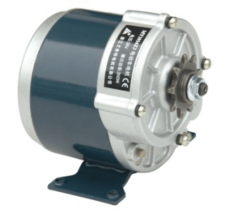

Drivetrain Ideas...
I'm doing some things on the other end of the spectrum (exotic road racing) but the ideas apply here as well. After thinking long and hard about how to get pedaling and a motor at the same time I've arrived at this configutation:
file.php
...by placing the motor directly in front of the rear wheel you get a straight pull on the chain. This should give near 100% efficiency. (about 98% is the standard figure for a clean chain)
The main thing is to get that first geardown. Most motors run at 3000 rpm or so and you need to get that down to about 100-200 rpm to get to near the pedal rpm. If you can afford $50 you can buy one of these:
http://tncscooters.com/product.php?sku=106115
