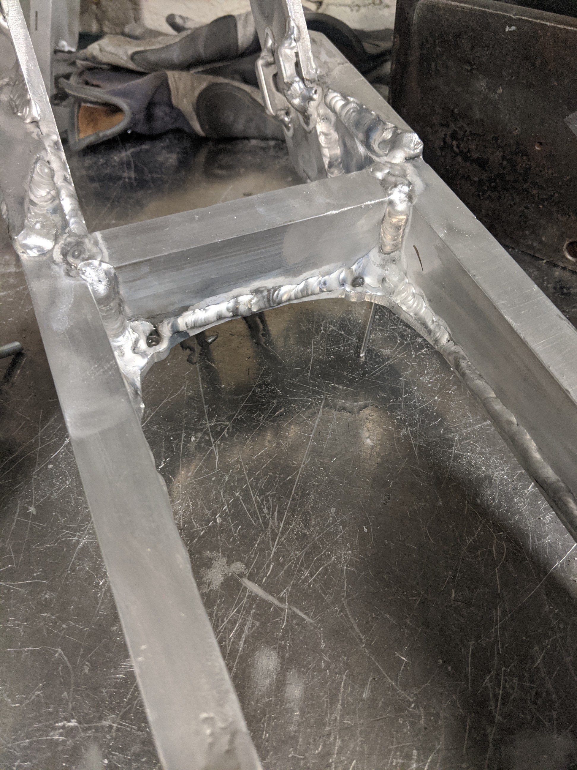

Rough, but WORLDS better. My frame is still pretty 'wobbly', hopefully it will go away once I'll bond everything with carbon (replacing some tubing with carbon along the way).

I failed to see if you mentioned the actual stock, name, and .. the gauge. How thick is that aluminum, in those multiple colors?

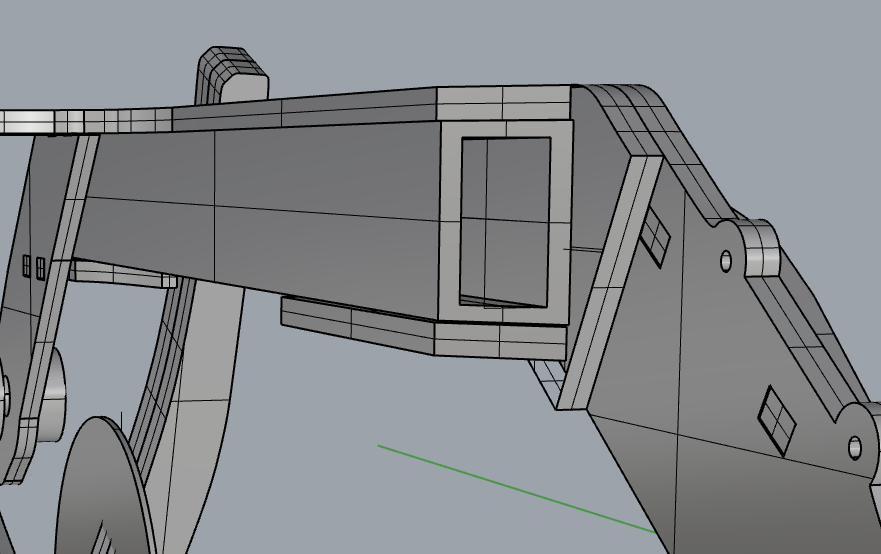

Are you gonna fix swing arm #1?
Wow. 6kg frame.. Wow. How thin is that stuff? Is it hard to weld?
I looked the picture of your swing arm, it's normal it's not stiff, you should joint the two square tube with another tube, not a sheet plate. ( Where you fix the shock). It will lock the rotation
