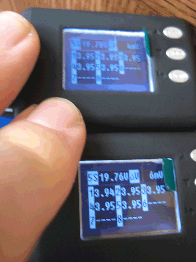

Here is my pack after 25 cycles of non-balanced charging, at it's storage voltage:

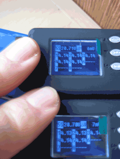

Here is the same pack, fully charged to 4.15v per cell, and left to rest for a few minutes:
Keep in mind this is a worse case scenario. Discharge has been at 4C-8C, getting the batteries warm. I've taken them down to 3.5v near the cliff more than once. They get warm when i hill climb. They are not in a parallel pack so if one cell gets out of balance, it is not corrected by other cells charging it.
I'm betting i can run for another 25-75 cycles without needing to balance these. I check the balance with the cell meter from time to time just in case.
