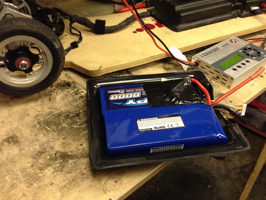

8000mah Battery upgrade done! pretty simple to do..u just need a 7S plug and remove the correct balance earth and connect batteries in series
