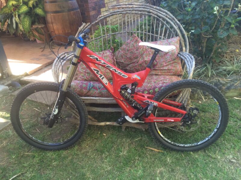

I really want the m6, its just a plain sexy bike.
EDIT
Just spotted an m6 on gumtree fingers crossed! big long drive to check it out but Ill do it as its cheaper.
http://www.gumtree.com.au/s-ad/yandina/bicycles/2010-intense-cycles-m6-fro-medium-downhill-bike/1083447314
just to quote myself - Yes I have added her to stable!
HOw much would you pay for this beast?
I just started a new thread here for the M6 http://endless-sphere.com/forums/viewtopic.php?f=6&t=71633 I hope all you guys subscribe and follow it too as I won't be posting anything on this thread apart from the Hasa bike build.

Since the Intense bike is unreliable in continual teething and since took a vital organ = controller from this hasa black build I have been with no bike at all recently.........
Finally pulled the trigger
