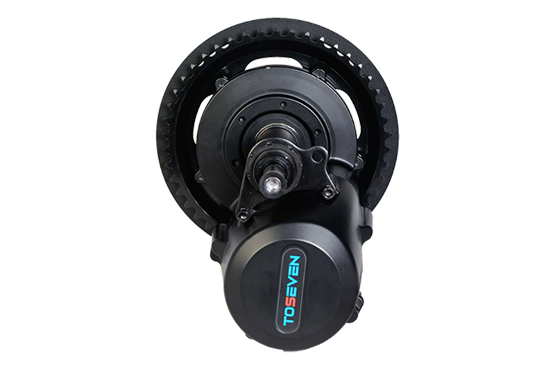

Hi, I'm looking to get a tongsheng tsdz2 and I came across this alternative from "TOSEVEN" on psw power website
I asked them the difference/benefit/pros/cons and they replied that it has a different torque sensor and sent the attached pic. I have no idea what this means or if it is better or makes it worth the risk of trying the lesser known/supported motor.
Any thoughts appreciated from those who know about these things, thanks!83373311@16D3BB22_F2E01264_png.png
I have also seen those motors recently. Especially interesting is the higher power model that could beat Bafang stronger model with torque sensing capability. Looks like the torque sensor is kind od more advanced type than TSDZ hovewer we dont know how the software is tuned and if it offer any advanced setup capabilities...

One funny thing about the DM02 is that it looks very similar to the TSDZ2, but they have changed the position of the controller : it is now facing the front of the bike. This doesn't favor airflow on the motor area, but wouldn't be a problem if they suppressed the air gaps around the motor (like they seem to have done on the DM01).
