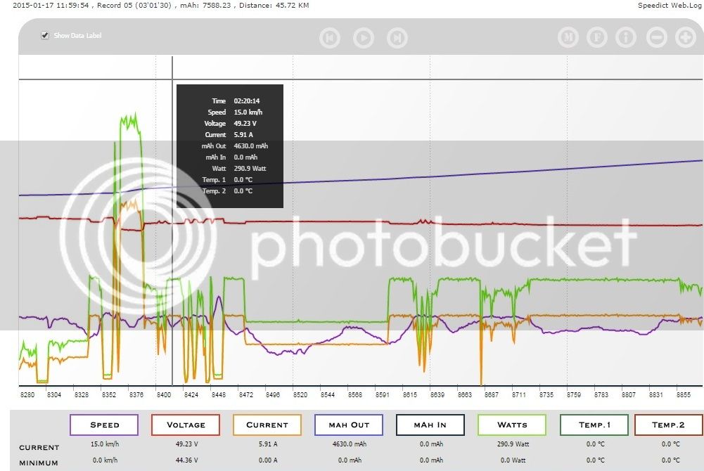

I've just started using my Speedict again. It seems to be much more reliable now with the latest software version. It's a really useful device because it logs all the data. You can then have a look and study the data without having to worry whether someone is about to step out in front of you. I don't use the live display while I'm cycling because I already have a LCD that shows speed and distance, etc. Here's the sort of thing you can see afterwards. The graph shows the very flat current because the controller uses current control. The peak at 15A is where the Xiongda engaged its winch mode (low internal gear) to climb a short hill. I got a much better picture of what the controller was doing this way, which the CA wouldn't have shown. The downside is that you have to open up the app on your phone each time, but then I just keep the phone in my pocket as usual.
The speedict logs all your data, so you don't need to use you phone at all, except to download it all at the end of the week or whenever you want. The Speedict also has loads of other features that some might find appealing. It has a map mode for live navigation. It can mix PAS and throttle signals, and it can regulate the speed or power of your bike.
