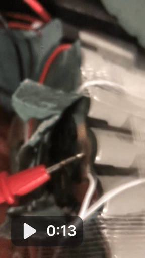

The charger is showing the green light, for fully charged battery. I have no idea why. Because when I test it with a multimeter it is charged only up to about 40 volts right now. And this is a 48-volt battery.

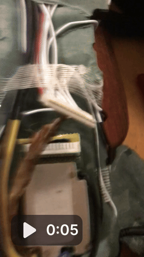

Like others have suggested i'd partially disassemble battery enuf to take voltage readings of each of the 13 parallel groups. See if at least one or more have voltage readings lower than 3.00 volts while other parallel groups voltage readings above 3.07v (13s average
voltage = 40v). Even with bounce back voltage there still should be a significant voltage variance between any weak/bad parallel groups and the remaining useable parallel groups. Check to see if one of the BMS sensing wires is no longer connected.
BEFORE you replace the BMS you first need to check the current resting voltage of all 13 parallel groups.

Also, I checked the battery with a multimeter when I got home. It shows around 40 volts. And fully charged(this is a 48 volt battery) I guess it shows around 54 volts or something like that.
Now, the strange part is when current runs through it and it is connected to the charger, in the wall, you can see all the green spots again and it shows 50volts with a multimeter.
So I guess the battery do not "contain" or receive the current that is coming from the charger. But at the same time it seems the cables are not interrupted(?) since when connected to the wall it shows current flowing through the system. And I could even start the bike when the charger was connected to the battery via the wall.
Just open the battery and measure the groups as they are now? See if any cell or cell group looks strange/different?
What tools will I need to check these groups and the bms? (just so I know I have them)
You guys mean open the battery, remove the cover and then measure the individual cells correct? (multimeter?)

Your battery is composed of several cells put in parallel groups and then these groups are put in series with each other. Given the description of the issue, my guess would be that a least one of your cells group died, either because the individual cells that composes it died, or because they got disconnected somehow.
First thing: do not ever charge this battery until you fixed the issue. Seriously. There's a high risk of it catching fire if you do so for too long. Normally your BMS should prevent individual cell overcharge, but you can't blindly rely on it.
First, I suggest you to binge watch as many battery build tutorials as you can on youtube, in order to have a better understanding on how this whole thing works as well as the possible risks, necessary tools, PPE, stuff to do and not to do, etc.
Once you feel confident enough, you can start tearing up the battery.
Measure the voltage of each cell group using a multimeter. Then find the one that doesn't seem to match the others.
Then see if it's technically possible for you to replace this group of cells given your tools and your knowledge.
To be honest it's not as difficult as it might sound, but it is very intimidating.
Also, there's a good chance that replacing just a few cells will only be a short term solution until another group of cells bite the dust, because it's likely that the other cells are gonna die soon.
Take is as a fun project to gain experience with an otherwise dead battery, if you manage to make it work it'll be a cool bonus. If you don't then you'd have still learned a few new skills :)
