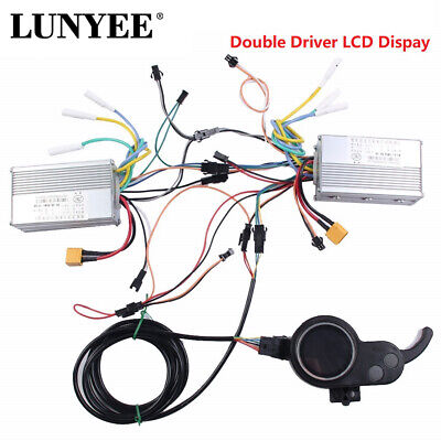

The most affordable & reliable dual motor controller on eBay is this one.
You still have to buy "single/dual" and "turbo/eco switches (around $25 for both)
Dual motors is an overkill for your setup. but eager to see the scooter setup when it is ready. Keep us posted!
The Dual motors is to get traction, since the front wheel slips/skits a lot, especially uphill.
Thanks for the link. With one of these I guess I should be able to control the hub front motor and one electric skateboard wheel in the rear.
