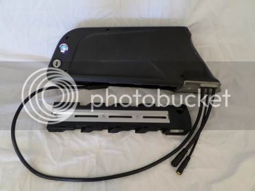

Nice build! Is the controller built into the battery box on the rear? Also, is the battery box standard from BMS?
Yes mate, controller is in the battery case. Makes it a clean install. I find this style of battery is mountable in many positions and flexible to work with. Here is the product
http://www.bmsbattery.com/36v/679-bottle-ebike-battery.html
Nice build! Is it the Q100H really? The Q100H is in black color normally and old Q100 in grey color, no?
I've been looking at that particular battery a lot lately. Can't quite seem to figure out how they manage to cram a s/w controller + 52 (if my math is right) cells in there though.

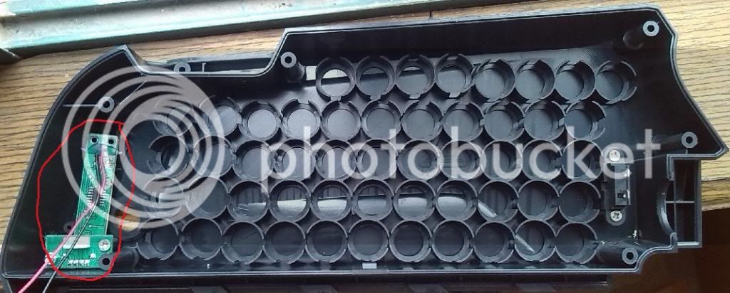

I can open up if I get time in next few weeks and have a look if you like. 52 seems a bit high though should be 2900mah cells.
actually, the controller is inside the discharging port at the back end of the battery base..
i've few picture for your reference..
i guess this case would fit 60 x 18650 battery (10P6S) if you takeout BMS and USB function.

Thanks for the pictures!
Paul at EM3 spent months figuring out how to use that case with a good BMS, and a few months after he developed something BMS goes and sells something similar with cheaper batteries. Go figure.
Paul's frame mounted battery packs are more expensive, but the batteries are better, and customer service is much better!
