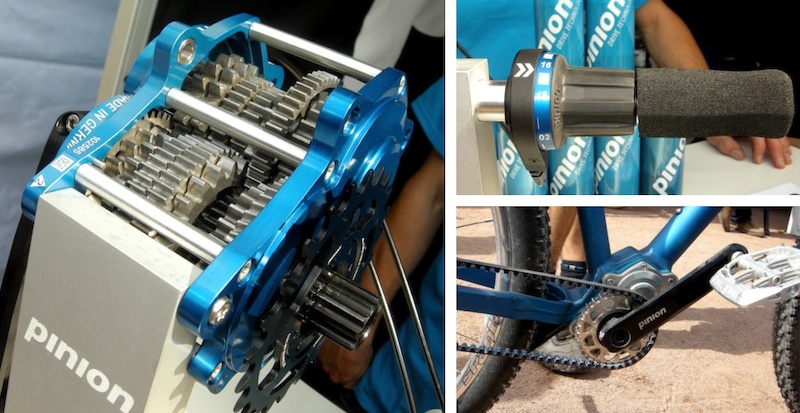

If I would use a small gearbox like this (with only 1 gear), this could save some space and belts and .. well, I'll stick to the two stage beltdrive for now.
