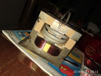

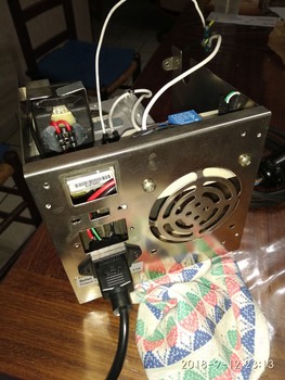

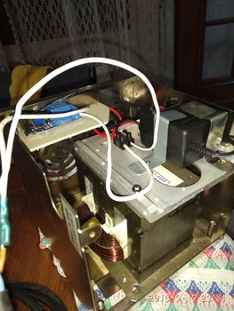

hello everybody, i'm new here and need some help.
i may build an e-bike some day, i'm still only collecting info for now but one big part of it will be to build a 18650 battery pack.
to do this i built a diy spot welder from scavenged parts including a microwave transformer.
but it is working "too well" or not so well in fact : i tend to pierce through the battery shells and nickel strips.
only testing on dead cells but i can't use it untill this problem is fixed :(

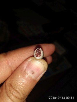

below are some photos of the welder. the problem with scavenged parts i used is i don't really know their caracteristics : the power of the microwave oven or the transformer (except it is 220v 50hz because france), or the gauge of the copper cable i used, .....
i used a timer relay from ebay thinking it would limit the damage but even with it on minimum time, i get sparks and holes.
what did i do wrong ? should i add or remove a turn on the winding and why ?
other ideas? i 'd like to keep it as simple as possible since i lack knowledge in electronics/electricity in general,
any help is welcome. thank you.
pictures :
Sounds like your pulse length is too long. Don't reduce the amps.... Shorten your pulse. Hot and short is the way you weld with minimal heat permeating the surroundings.
What sort-of timer are you using. How does it work and what pulse lengths can you achieve?
you can see the timer i'm usig on pic 2 an 3, a cheap timer relay from ebay as i said. i think it is this model : https://www.ebay.fr/itm/5V-30V-Delay-Relay-Timer-Module-Trigger-Delay-Switch-Micro-USB-1343Z/183863247036?hash=item2acf1a80bc:g:qY4AAOSw8ZhdFmM9
the pulse seems very short (way shorter than in some youtube videos i saw) but may be not enough ? i thought it is not precise enough to make extra fast cuts, resulting in too much amps punching holes. so i was thinking first about reducing the amps by removing (or adding ?) turns on my winding but here is my problem :
you can find many DIY MOT welder tutorials saying "take x AWG and make 2 turns!" or take y AWG and make 4 turns! " but i found none to explain clearly the relation between the number of turns and the desired amp output. and again, i don't even know the awg of the scavenged cable i'm using.
-> So, in my case, keeping the same transformer, the same timer and the same big copper cable, if i want something "less powerful", say less prone to sparks and holes, should i remove or add turns and how many ?
