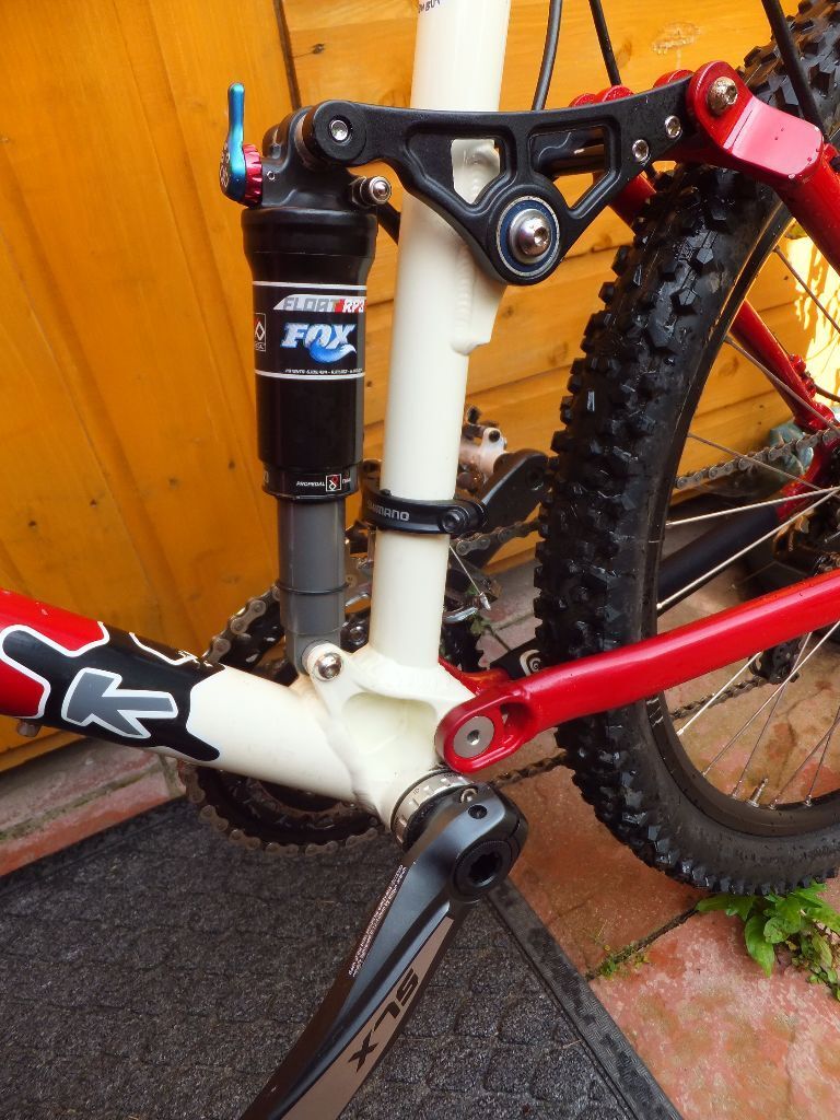

I recently purchased a Kona Kikapu FS frame of CL to build my next ebike on. Came with a Fox rp23 rear shock. I chose full suspenison because with past experience, anything faster than 24mph on a hardtail is uncomforting hitting the slightest bump. I also want the ability to do some very light off roading and have no problems hopping off curbs and not having to baby the bike. With this setup I am planning to use 4-6 36v 4ah batteries mounted in the triangle. How they are wired depends on which route I take on the motor. I want this setup to have good low end torque, and a top speed of 25-30mph (don't see the point of going FS if any slower). I'm also looking for the most efficient setup possible to maximize range. I DON'T want to throw thousands of watts into a motor, 500-1000 max, so it will definitely have to use the efficiency of using gears. Not trying to bust the bank either, this is a budget build. With that in mind, I'm looking at two options right now:

I've decided on a mid drive approach, this mid drive kid by SBP seems to fit the bill at a decent cost:
http://www.sickbikeparts.com/catalog/product_info.php?cPath=26&products_id=180
Has a 36-72v external controller vs the internal in the bbs02 that can't go past 60v.
Also seems to be more adaptable to my frame's bottom bracket.

For what you want, there are 2 good choices. The BBS02, or the MAC
How about this kit instead? http://www.sickbikeparts.com/catalog/product_info.php?cPath=26&products_id=180 Seems like the lowest cost quality brushless mid drive, and motor is rated at 800-1600w so there's plenty of headroom for power. Only thing I am worried about is installing the left side motor mount on the bottom bracket. This picture of the kikapu shows what I mean, the rear suspension pivot sits sticking out right above where the mount goes around the bottom bracket. On the chain ring side its just flush enough that it wouldn't interfere, but on the left side it definitely would get in the way what looks would be a good cm or two. Would it be possible to just shave down whatever gets in the way on the mount with something like a grinding wheel on a dremel? Its aluminum
Wish I had your bike, but I wouldn't want any bike built to your plans.

I think you would benefit by going back to the drawing board and work backwards, forgetting about the kits and batteries you have already looked into for five.
Make solid decisions about what you need starting with speed and unsprung weight, decide on hub vs middrive. Now choose your kit. That will determine your voltage and current requirements.
Then choose your battery. This should be rated about what you need in terms of capacity. Voltage and current output should match the kit.
Done.
I got a bit confused by your first post.
You mentioned 25-30 mph, the need for it to be full suspension to go that fast, etc. I definitely got the idea you wanted to cruise at 30 mph.
Then start talking about 36v 800w, which in general, gets you to more like 25 mph at the very most, speeds at which you may not need full suspension at all.
Then you say you are considering a 350w kit, which will struggle to go 20 mph. Hell, with the wrong winding, it might top out at 15 mph.
Now that you clarified your needs, BBS02 if you want to reach 25 mph on 36v. Not one person on this forum is going to advise any brushed kit. Unless you only want about 15 mph.
On 36v, you won't reach much more than 22 mph with a larger 500w geared motor like the Mac, in 10t winding. I DONT recommend a faster winding Mac, in a large diameter wheel running 36v. That would ride very sluggish and have terrible efficiency leaving stop signs.
That leaves only one option that even gets close to what you want, a bbso2 kit. And to reach 30, you'll be pedaling your ass off. More like a 25mph max bike. Which doesn't really need FS unless for off road.
IMO, you are still kind of in the attitude of "this is what I want" 36v. So you gonna have to accept what 36v can do. It should be fine though, a decent 25 mph full suspension bike is still a joy to ride. 25 mph cruise is plenty fast really. You may even come to prefer about 20 mph, simply because it hugely increases the range you have.
I test rode some nice bikes at interbike this year, with the bbso2 on them, running 36v. I think you will be happy enough with that, unless you really do want 30 mph some of the time, for that, 48v.

I contacted SBP and seems like the issue with the rear suspension being in the way can be simply be solved with some spacers they have for the bottom bracket. What I also like about the SBP kit is the controller is external, runs from 36-72v. That gives me many more battery options. 72v through the gears should be interesting even with a lower 15-20 amp limit. 72v in the lowest gear should produce some serious torque. With a properly aligned drive train and in the right gear, shouldn't this be even torquier (is that a word?) and with a higher speed than running 2-3000w thru a hub motor?
BTW, the batteries I will be using are the greenworks gmax 40v 4ah batteries. $90 each. 10s2p of High power 18650's with built in BMS. 4 provide a pretty decent range (36v 16ah), I plan on running 5-6 for 20-24ah depending how many I can fit in the triangle with the cases removed. Yes, you can probably get a higher voltage 48v pack at 15-20ah for the same price or maybe even cheaper, but I prefer the modular approach rather than having one giant battery. Something goes wrong with one cell in the big battery, it'll be a pain. With these you can replace or remove one 4ah brick that might go bad or if you feel it pulling the whole pack down. And mounting one big battery can be a hassle, i can throw 4-6 in the triangle in different configurations. More in a saddle bag or top tube bag if i feel the need. Plus one of these alone can put out 40-50 amps (they have a built in 60 amp fuse), a few in parallel im pretty sure can do 100+ amps easily. Strongest safest chemistry you can go without going lipo. I've overcharged these bricks(one time to 44v), undercharged them(mid 20's), even punctured a cell or two on these, and still never had any issues with fire or puffing or even a major performance decrease. Probably a good amount of luck involved too :lol:

Matt, I'm interested in how your middrive worked out. I put a BBSHD on a Kona Kikapu a year ago, but I took it off. Even though I didn't ride hard at all, the deflection of the bottom bracket made me scared the lightweight aluminum frame would break. What has been your experience?
