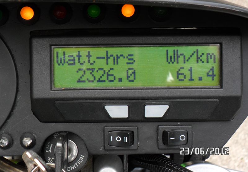

Average consumption is 55Wh/km. maximal was 61Wh/km and minimal was 42.

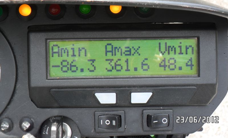

Max currents were around 360A and constant currents are around 150V.

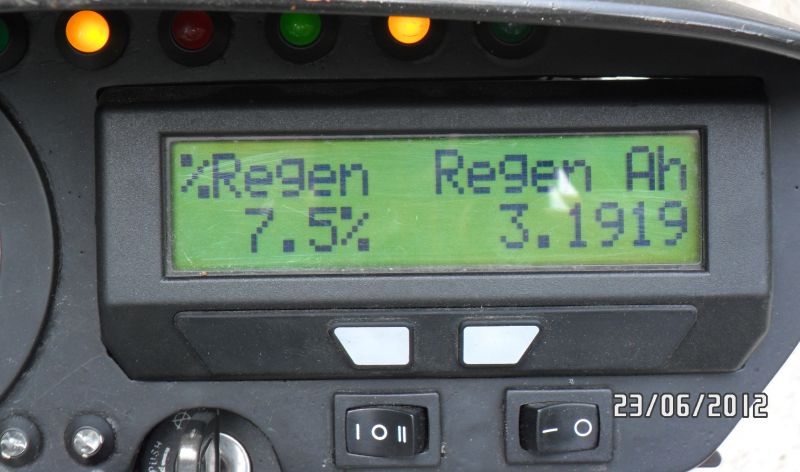

Regen is between 6 and 11%. First 1000km it was between 3 and 8% then I changed the parametars: Before it was on button and on 100% and after I put 20% on throttle relese and other on brake light. I have added small device that rises voltage from 3 to 5V in 3 sec and put it on analog input triggerd by brake light. This combination works great and feels like ICE engine.
