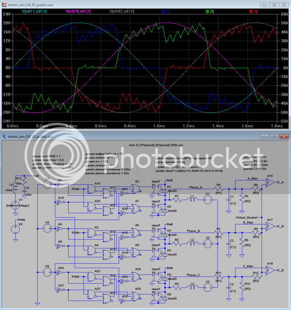

My LTspice model is getting pretty usable. I've made everything parametrized. If you for example change the parameter motorEMF, then the motor frequency and the simulation period is changed along. There are a number of parameters describing the motor and the controller, and their names should be self explainable.
If anyone is interested in trying it, I've attached it below.
When using PWM, there may be a problem. I've probably spent three times the time it took to make the actual model, to look for that problem. I can't find anything wrong. The problem is that the waveforms of the currents are a little unsymmetrical. The positive halfwave have a faster rise/fall time for some reason. The average currents are the same, though. The waveforms are also pretty rough, IMO. It may have something to do with how it is PWM:ed. It's done the same way as in some commercial controllers, that is, one phase lead is floating, one is tied to +, and the third one is PWM:ed.
The parameter usePWM is set to 0 by default, but can be changed to 1 to enable PWM.
Bearing, your model correctly simulates what is happening in some commercial controllers. I have experienced this during the development of my controller too. The asymmetry comes from the difference of current decay time through the inductor of the floating phase which is caused by always switching the same side of the bridge (Top or Bottom). This effect is worse for high load and low speed use cases where the PWM duty is low and current high. It causes serious sync issues, low efficiency of the controller and most cheapo RC controller to blow up...
The solution is to correctly alternate Top or Bottom side switching to maximize the neutral voltage since the rate of change of the "floating" phase inductor current is proportional to it.
See the optimized switching sequence below. Note this model also include synchronous switching which significantly improve efficiency and also permit regenerative breaking :)
Model attached here:View attachment motor_sim_0.8_ES_public.zip

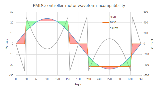

I may have another explanation why cheapo controllers blow up with low inductance motors. It's actually very simple.
And let's say we have a motor with inductance of 10μH... Now, we would typically get a very high ripple current, like 100A or so, just to spin it without any load. It would be heating up, but spinning fine. The problem, I believe, is in difference of waveform shapes.
Let's say our controller has a trapezoidal waveform with synchronous power stage and our motor is sine. Let's say we have a 48V battery, motor resistance is 20mΩ and inductance is 10μH. And our PWM is at 20%. Here is what we get:
At 50% PWM, motor is spinning at ~half max RPM, so blue line shows BEMF shape. Orange line is an integrated PWM shape (so half amplitude at 50% PWM).
Notice that BEMF shape does not match with PWM (controller's output waveform) shape: in some areas controller's output is higher, and some - lower than BEMF. What that means that motor is actually running in both modes at the same time - motor (green area) and generator (red area, regen). And these both modes are drawing huge currents, up to 500 amps.
With 16kHz 48V 50% PWM and 10μH motor, our ripple current is not so high - 22A RMS. Well, too high for reasonable efficiency, but not "damaging" high.
Gray line, however, shows phase current, caused by waveform differences. This goes up to 500A and RMS current is 263 Amps!!
I believe this explains why many controllers go bang even at no load conditions, or some time later.
This also explains what happened to "Golden motor 500A" controller during my test several years ago, when I hooked up to CA80-100. The controller was "pure sine wave" and motor was very close to trapezoidal waveform. I did not even put any load on it, just spun up several times and bang, controller had a shorted phase.
Does proper vectored control take care of this? That golden motor controller was marketed as "vector control".
