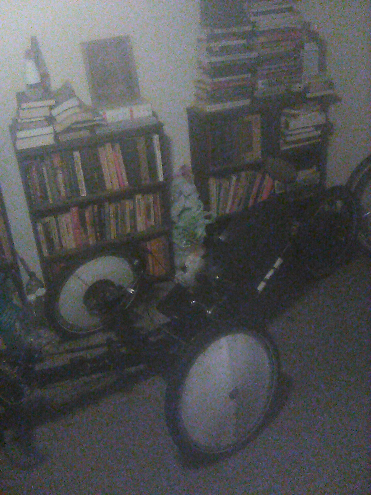

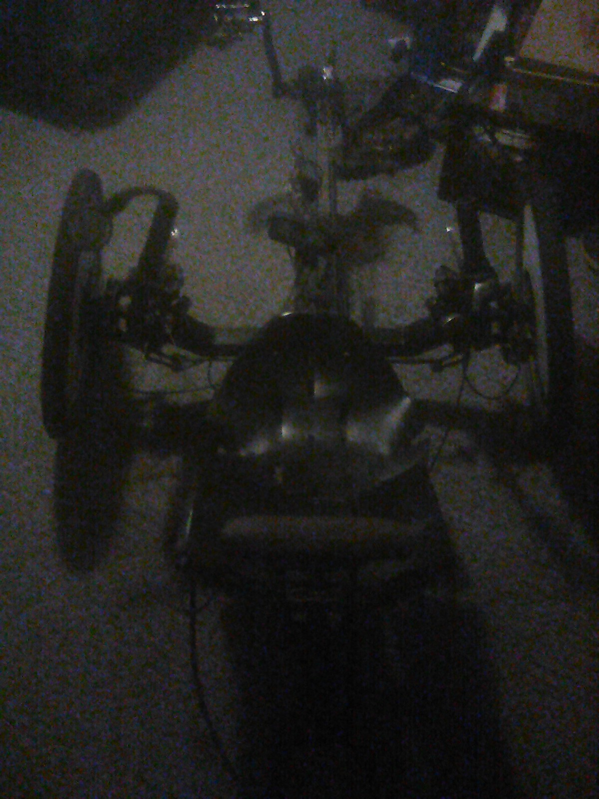

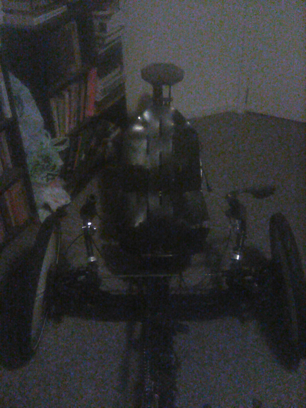

I dragged the KMX down into my basement bedroom so I could get some work on it done, since my job takes up all of my daylight hours.
Hydraulic brakes and ATV disc rotors are going on this weekend. Once the body design is complete, I can finally get to work building it.
