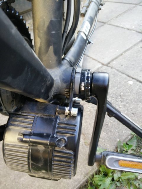

opperpanter said:
Recently I installed my 2nd BBS02 unit on one of my bikes.
It seems to have a bottom bracket between 68mm and 73mm. Can't make up what it officially is. If I measure it, it's 68mm. But considering the fact that I need 2 washers to be able to put the BBS02 on, it looks more like 73m.
Anyway, I can't get the motor to stick in position. It keeps moving (turning) a bit. I think it's because the washers are not of the exact perfect thickness, causing the mounting plate that is locked by the lock ring to be not perfectly aligned.
It's a bit difficult to see, but I guess it's a common issue. Just have to find the righ combination of washers to make the alignment right?
Or is there something else I should be checking? I tried fastening the grey lock ring very firmly, but that's not good enough.
No problems on my other bike with a 68mm BB. Sorry if this is already mentioned somewhere in the 170 pages before this one.
HE WENT DOWN FROM 2 to 1 WASHER AND YOU'RE NOT GONNA BELIEVE WHAT HAPPENED NEXT (clickbait)
I went down from 2 washers to 1... when you put the plate on without the grey lock ring, the angle just looks completely wrong.
But.... when you tighten the grey lock ring, it seems to all fall into place and connect nice and tight.
Motor seems locked into place now :)
I assume the motor force only wants to turn the motor forwards, against the bottom tube?
Only force that is trying to pull it back/down is gravity, when motor is idle?
In that case I should be fine now!
