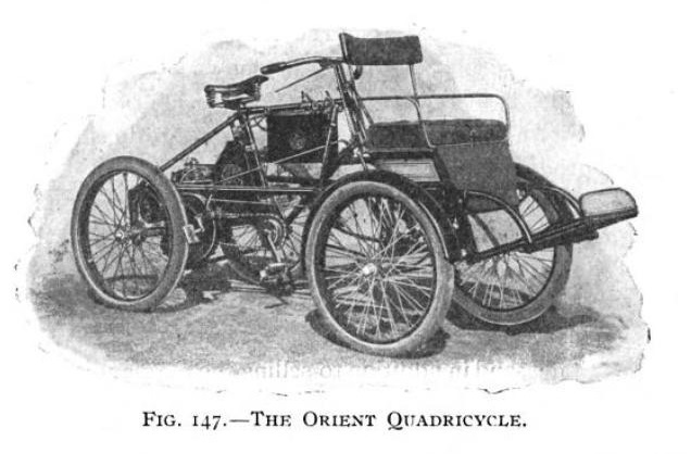

What's old is new!
You could start with one of these:
