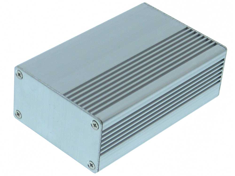

The burning question.. ha ha.. is.. how could a box like this be made in a manner that is light so that it could be used as a permanent battery box on a bike. A small steel ammo can is 4lbs at the lightest, before any insulating material is added. The resulting box may weigh 7lbs.. and that's quite the weight penalty, considering 1kwhr of lipo weighs about 12lbs.
An aluminum box of equivalent size would likely come in at 2lbs.. so we're talking a 5lb box carrying 12lb of lipo.. which gives us slightly greater than lifepo4 energy density.
A better option to reduce the weight of these boxes is to split the battery into 4 individual units and use a thinner lining in each box.. each box would only need to handle 1/4th of the thermal intensity.. even if the boxes are the same weight.. you cut down on the damage a single pack can produce by 1/4th.
