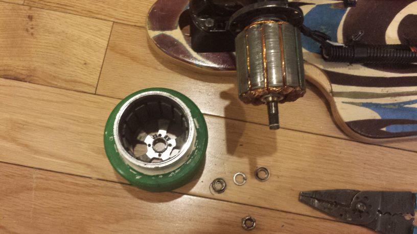

love the hub motors. Any issues with durability/longevity of the motor bearings yet? Or tiny rocks getting inside the motor?

Thanks. I built this April and have not replaced any bearings yet, riding them hard every other day to test them. I do see the wheels getting thinner though.
The outside of the of the hubs gets really dirty, but when I open them, the there is nothing inside and the stator is clean. The copper wirings stay as they are, the laminations are not scratched and there is nothing between the magnets.
I do ride only on paved roads and sidewalk though, not really rocky. But there are some where I go over small branches and leaves. I guess when you gun it, whatever is inside gets spitted out.

I have had a pair of pediglide's motors for over a month now and they are totally not able to withstand the forces. I have been working with endless member Mike Keefer since June 16th on improving this design. He has been a deeply involved in this project with me and is a great help. At this point it seems like Jacobbloy motors are much better designed for these conditions. Just wanted to warn you of the potential quality issues and see what input the community has to improve this.
- The first problem I had with these motors is the screws holding the can to back fan and skirt bearing are way too small and short they fall out almost immediately.
- Also The urathane was not epoxied to the can well at all. He did not use enough epoxy and it slipped off of both motors while riding on the first day. Be very careful with this since the motor will grind violently on the pavement and get damaged, when the urathane slips off. I had to reapply much more epoxy myself.
- Next the bearings are not sealed and cant handle the forces. After a week the bearings on one of the wheels was shredded (like nothing left, see the pic) and the motor locked up, stator grinding on magnets and threw me off the board.
So i replaced those bearings with stronger sealed ones. Now my other wheel bearings need changing. Its also impossible to change the big skirt bearing in the back of the motor when that eventually fails. listen to the sound in this video: [youtube]https://www.youtube.com/watch?v=ZdzENjKBevE[/youtube]
- Another issue since day one is bad crackling/cogging on hard acceleration. I came to realize this was caused by the stator being loose on the truck. The epoxy (only red loctite) is not strong enough to hold the stator in place especially at high motor temps. I don't think he used any kind of set screws either. You can see the stator jerking back and fort on hard accel/braking in this video: [youtube]https://www.youtube.com/watch?v=aZn7OtqCu20 [/youtube]
- I have continually had sync and timing issues with these motors using a variety of controller settings. This could be due to the stator slippage. This loss of sync/cogging from the loose stator will also potentially lock the wheel and throw you off the board.
- The bell housing of this motor is also too thin to withstand deflection or lateral forces. My wheels are way out of balance now this causes some instability. So much so that the bell is rubbing on some winding causing sparks and cutting a few of the wires (see the pic).
This got so bad once that on bumpy pavement the winding shorted and locked the wheel up at high speed again.
Besides all of these quality and safety problems worst of all is that Jerry (pediglide) even when he is selling them as a ready made product on ebay, will not offer any you support when you have these issues. He has not responded to any attempts to contact him post sale since June 15th.
These wheels are really a death trap. This is at best an alpha design.
Thanks for your input Mike. I'm sorry you had a problem with the Hub motors I sent you. I have added some improvements on the design.
I have put a set screw to the the truck aside from screw that was originally used to brace the stator. In this way, the stator can be secured and removed to replace the inside bearing.
The wheel slipping off, as far as I know, is only exclusive to the softest duro real ABEC11s. None of the clones have slipped off, as far as I know.
I believe you had problems with the bearings because you did not tighten them well enough and you did not program your ESC before riding them. You kept on riding them even with horrendous cogging as you said.
I would replace any Hub motors that have any problems, even pay for the return shipping where ever they are in the world.
Unfortunately for you, since you made a chargeback on your bank and Paypal gave you your money back without returning my product, even though Paypal instructed you to do so; I cannot give any more service.
So you basically have my product for free. But thank you for your feedback. I will learn from this and improve my product.
