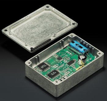

I blew up my controller yesterday, after a heavy rainstorm. I rode home, and the motor started jerking around and lost power. There was a lot of water still on the road which was thrown up.
So I switched off, pedalled home, then looked at the damage after I got inside.
Looked like the water ran in along the 3 motor wires. I mopped up the obvious water, blew some air through to clear the water, and thought I'd give it another spin. Silly me.
The motor still jerked backwards and forwards a few times, then a little flash from the innards and a funny smell told me that the magic smoke had been set free. :oops:
I then did what I should have earlier, and took the lid off. There was some muddy water wicked between the case and the pcb, and now some blackened looking components.
