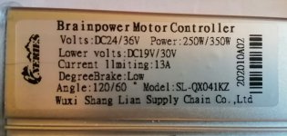

XLD Brainpower motor controller XunLiDa
If the motor is running poorly try using the self learning feature. It is 2 green wires. Connect them and turn on the controller. It will slowly spin the wheel till it has figured out the correct settings. When it starts spinning good, turn off the controller and unplug the green wires.
Also I just got one of these controllers off Amazon. Gonna wire it up today.
Edit: Got it wired up to my bike. For those who care you can use Alarm Power to hook up your lights. Also, at least on my model, there is a noticeable increase in speed from gear 2 to 3.
Also my controller is doing something weird. When I use the self learn wires to calibrate the controller, while learning it will spin the correct way (forward) but then when I disconnect the wires it and turn it back on, twisting the throttle causes it to go backward. Shorting the reverse function causes it to go forward... :lol:

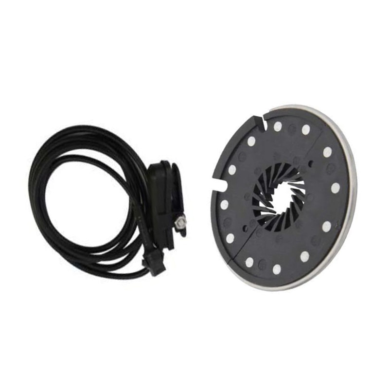

Hi guys, so I own a XLD Brainpower rated at 350w and a 12 magnets P.A.S (KT), this model :
It works with a throttle, but when I connect the P.A.S instead, the controller doesn't respond. are those controllers incompatible with magnet pedal assist sensors ?
thx
thx
Did you change the P10 settings?
