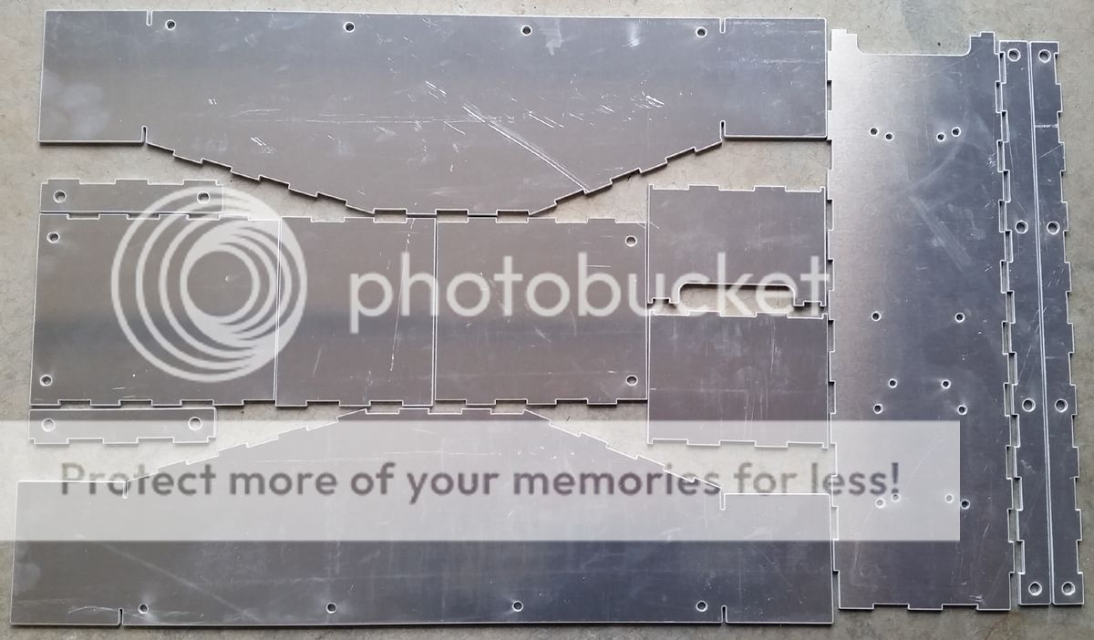

Water-jetting and laser-cutting can make a complex 2D metal part very easily. Like torque-arms, or mid drive motor mounting brackets. Some of the cost of the parts is the time for set-up, so...if you only need one part, it will be pricey. If you order five of the same, there is a break in the price for each piece, and 10 or 20 is even better. If you have a clever design, it might be easy to sell the other sets, so you end up with one set a better price.
I also want to kick off this thread with an open-source 3D-print in plastic, of my design. There are services that will print-out your 3D part in plastic and ship it to your home. But...someone has to draw it. Eventually I want to learn how to draw parts so I can 3D print them. I have heard good things about Rhino and Googles Sketchup, and recently I have had Fusion-360 and FreeCAD recommended for my project.
As this thread evolves, I will list 2D/3D drawing programs that are recommended, and also services that will print your 3D design and ship it to you. I would also like to list ES members who have a 3D printer, and those list members who have 3D drawing skills that they are willing to perform for a fee.
Here is aluminum plates cut to have interlocking fingers at the edge, which will be welded. I have also seen this method used for laser-cutting wood for similar parts.
viewtopic.php?f=3&t=12847&start=500#p1278057

For work I have things laser cut often. Just recently had a batch of 250 special wrenches done.
I use a shop in MI and have had a great experience with them. They have laser, waterjet and EDM. You need to send them DXF files. But their prices are good and they are super fast. I don't know if I should be posting their info online, PM if you would like their contact info.
As I'm sure is obvious, 1 of something is going to be expensive, due to setup and pathing of the part. Always better to get as many as you think you can use or sell, the part cost goes way down.
I never buy material either, I always ask the shop to supply it. 100% the shop I use has it and can get a better deal than I can. And I buy 1000's of lbs of brass and stainless a week.
Here are a few recent projects for my boat, all from 316 stainless, TIG welded by me and after having them electropolished
