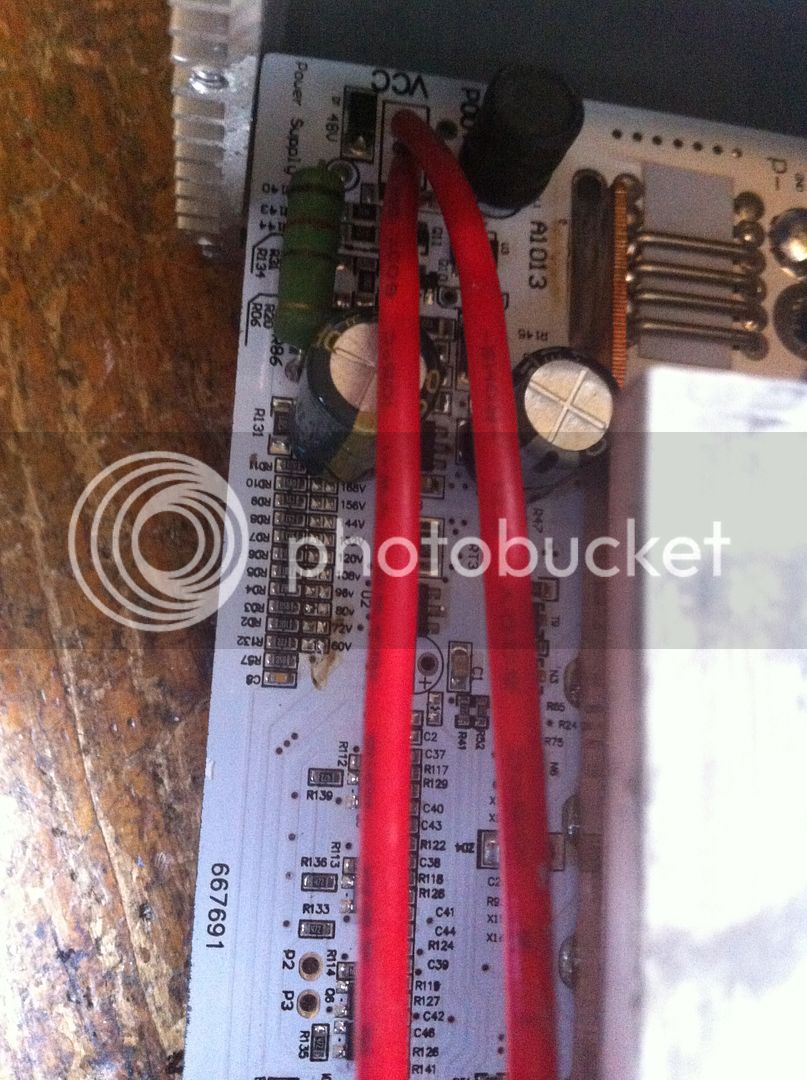

on the 2000w 80v i needed to lower the low voltage cutout. all you have to do is unsolder the blob on the pad and you have no lvc :D

While reading the translated page of the sunwin 500w empty motherboard on http://www.ddc.net.cn/offerlist/1031130/500952.html I noticed a few things, might be just bad translation but this is what I "found":
12, HI: speed or three-speed switch high-speed vehicle speed and strength increase, real afterburner acceleration. Three-speed switch is compatible with high-speed (three-speed switch connection: HI-speed, ground, TX low, default normal speed) effective ground. Afterburner acceleration (speeding) (the Hall mode is active, no Hall invalid)
13, LO: button three-speed or three-speed circulating default normal speed, click speed, low speed and click, then click the normal speed. Such rate cut cycle. Connection: ground, signal line (ground active)
So LO can be used as a button, tapping LO to ground (like a click) to cycle between modes: low, normal and high speed.????
Also this:
1, XX: motor learning mouth wires, power lines and feature cable connected, and learning lines connected, turn on the power (electric door lock), the motor will automatically enter the state of learning, such as learning to pull the motor run reverse at this time insert identification line, the motor reversal, or open learning lines have been transferred to the rotation, the motor will reverse. OEMs for ordinary use, you can not learn lines, direct labor adjustment phase. No Hall and maintenance staff based on personal habits, learning lines choose to use use. Special Note: After completion of study learning lines must be disconnected, and good protection, so as not to run into the frame malfunction, affecting the normal use of the controller. Connection: ground and signal lines (effectively grounded)
Does this mean that if the motor spins backwards you have to change 2 phase wires (doesn't matter witch one) and don't change the hallsensor wires, then do self learn aggain.??
This might be the reason for the delay some people (incl me) have. I had to reconnect the self learn to make it go forward fist time.
Then this:
32, 33: Current sampling ports normal standby This 2-pin voltage is about 1.26v
The first 3435 feet: current pickup signal amplification normal standby voltage of about 0.12
If the four-pin voltage may result in abnormal limiting current limit is too small or could not, (if the pin voltage is not normal, please check R9, R10, R28, R29)
So Instead of soldering the shunt wires you could also change the resistance of these resistors.
