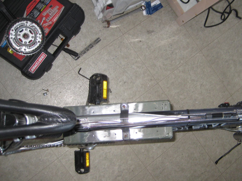

This is the box i was talking about. Fits 20ah 10s lipo, with room left over for another 4ah if i were so inclined. Kind of on the edge of the motorcycle look that i don't like.
Making said headway boxes out of anything other than wood is also kinda difficult and requires a shop with some serious tools, for sure. Increased weight means it needs to be sturdy, yet you are working with limited space at the same time.
That bike frame is an XL, but it's a down hill frame with thick Aluminum tubes. It's actually kinda of small.... It'd be easy to get an old 90's xxl steel frame, the type with wide open triangles, and have disc tabs welded on so you can run 20" wheels with motorcycle tires. At that point, It might just be better to get one of HAL's frames, but they only fit 2KWh worth irrc. the bike above is also only 2KWh. Plenty of range, but not at 50 mph.
