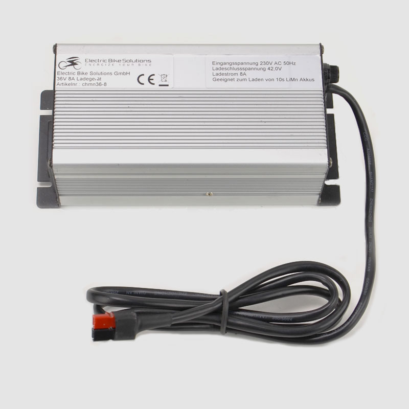

Charging:
I use one of these generic Chinese Ebike 36V/8A, 340W chargers to bulk charge my packs. They come configured to charge to 42V but you can adjust them between about 28V-65V and 4-10A. I adjusted mine to 41.3V at potentiometer VR2.
If you increase the voltage you have to dial down the current at VR1! My old 200W charger (42V/5A) got a bit hot at 61.5V at 5A and worked for several moth but died instandly when I raised the current to 10A at 61.5V. Oops! :oops:
Here you can find the electrical diagram, images, ect of a charger. Pretty much all of them have VR1 and VR2 to adjust voltage and current. Only the location on the board of VR1 and VR2 differ between the different chargers.
btw, my 900W charger from BMSBattery arrived dead. Don't expect to get a replacement fom them if they send trash or the wrong item (they send me a wrong hub motor as well). They don't care.
Since you're from Sweden http://www.ebike-solutions.de might be a better surce. Not as cheap as BMSBattery but if you encounter a problem with their stuff they fix it. Quick!
