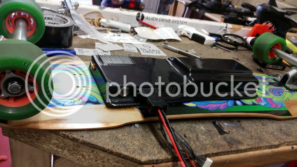

Hi all! New to the forum but been lurking for few weeks now.
Just finished my first electric longboard build and named it HELectric board. Have not seen any electric longboards in Helsinki I thought it would be interesting to be one of the first ones to build in DIY-spirit.
Some general information about the board.
Deck: Rayne Whip 41" (From Boardsport.fi)
Trucks: Caliber II Fifty (From Boardsport.fi)
Wheels: ABEC11 Flyweel 76mm 78a (From Boardsport.fi)
Drivetrain: Alien Drive System Freestyler-kit
Motor: APS 5065 Outrunner brushless 270KV 22000W
ESC: APS 120A 2-7S Mini ESC, 4.5 Firmware
Battery: APS 6S 6300mah 35C
Controller: HK-GT2B and Badwolf V2 3D-printed case
1442316260398
1442481505345
After few test runs im quite happy with the board, next step is to build Anti-spark, power button and some kind of easy way to charge the board without opening the enclosure (ideas?). Also it is interesting to see how the cold Finnish weather affects the board and its performance. Problem at the moment is that the Finnish law does not recognise small electric vehicles so there is risk of getting 160 euro fine when riding one of these in public :D

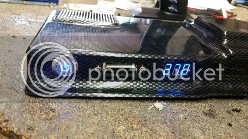

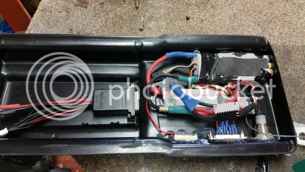

awesome build...looks very neat..
I have been using a a 15Way D-sub plug and socket on my latest builds..just solder a 7s extension cable to the 1-8 pins then use the remaining pins for the Positive and negative lead on the battery ( the pins are rated at 5amp each..and i use two pins for positive and 2 pins for negative).. works great.. and really cheap to buy on ebay..
http://www.ebay.co.uk/sch/i.html?_o...dsub+plug.TRS0&_nkw=15+way+dsub+plug&_sacat=0
Thanks beetbocks for the idea!
Can I charge the board without disconnecting it from the ESC? At the moment I dont have a power switch on the board.

well i use the power switch to disconnect.as the neg and pos are connected directly to the battery by SWG14 wire..
how do you turn it off now..just disconnect the battery?..use a XT60 or similar plug to form a kill switch on the negative lead maybe?
