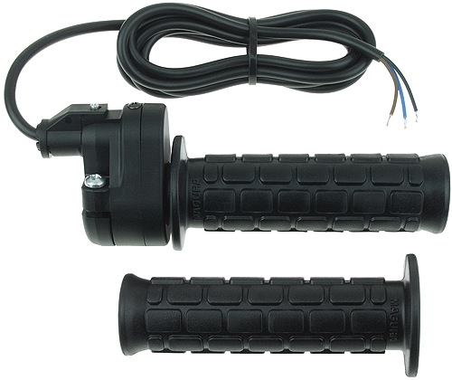

0-5V means it needs a potentiometer, unless you can change it in the program.
Hall would be 1-4V
It supposedly allows 4 different throttle versions. 0-5kOhm, 5kOhm-0, 0-5V and a 3-wire potentiometer 1-10kOhm.
The 0-5kOhm potentiometer is the simplest.

Seems I have to source this 5k potentiometer from somewhere indeed as I cannot get it to react to any of the throttles I have. Supposedly should be happy with any of them but none work. On bench I get no reading out of any and also when all wired up, I get no activity.
If they are hall-based throttles, and for a bench test you hook up a working 5v source (old usb charger, etc) to their 5v wire, and it's ground to their ground wire, but get no signal out of their signal wire with a volt meter regardless of throttle position/twist/rotation, then the hall sensors inside them are probably defective or not connected to the wires, or the wiring to the supply and signal and ground is not correct. Normally teh voltage range is around 1v minimum, and around 4v maximum.
If they were working normally, then the controller would probably give a "pedal high" or "stuck throttle" error at power on because of the non-zero output of the hall vs the pot it expects if the controller is set to that.
If the controller is set to a hall throttle input, it would operate as expected.

About the throttle - Curtis has 3 wires and the twist-throttles I have also have three wires. So I tried using these by just connecting positive with red wire, ground with black and the 'pot wiper' to green one but it does not seem to like these.
Manual says so:
WIRING: Throttles - various throttles can be used with the 1253 controller. They are categorized as
one of four types in the Program Menu.
Type 0: two-wire 0–5kΩ potentiometer throttles
Type 1: two-wire 5kΩ–0 potentiometer throttles
Type 2: single-ended 0–5V throttles
Type 3: single-ended three-wire 1kΩ–10kΩ pot throttles.
At moment it is the Type 0 and connected between POT wiper and POT low and this works.
It seems to me that the 0-5V that is also usable is a bit different than the e-bikes and similar have. Diagram is in attachment.
Maybe, as I now got it working and also the PC connection is working and showing diagnostics, I will test it a bit more but maybe not. Not at least until I have figured out a use for this kit :)
What voltage range do you get doing the test suggested above, from the signal wire of the throttles?
None of those are hall type throttles, which are ~1v-4v throttles. So if you use a hall-type then if the controller expects 0v at throttle off, you'll always either have a pedal high / throttle stuck error, or the system will runaway at power on if it has no safety against that.
If the controller has an adjustment for the high and low throttle voltage when set to type2, you can adjust it to your specific throttle. If it does not and requires 0v when throttle off, and 5v for throttle max, it would require a special throttle that has extra eletronics in it to translate the hall sensor output to the full voltage range. (or a box between them that does this job).
Try B- for hall ground instead of pin J1-4, the internal 511Ω may be the issue.
I have this Curtis in an old dirtbike and use a Magura twist 5kΩ, safety is worth a few extra bucks.
I couldn’t get rid of a low throttle step function regardless of throttle type or settings. Hopefully you’ll have better luck.
