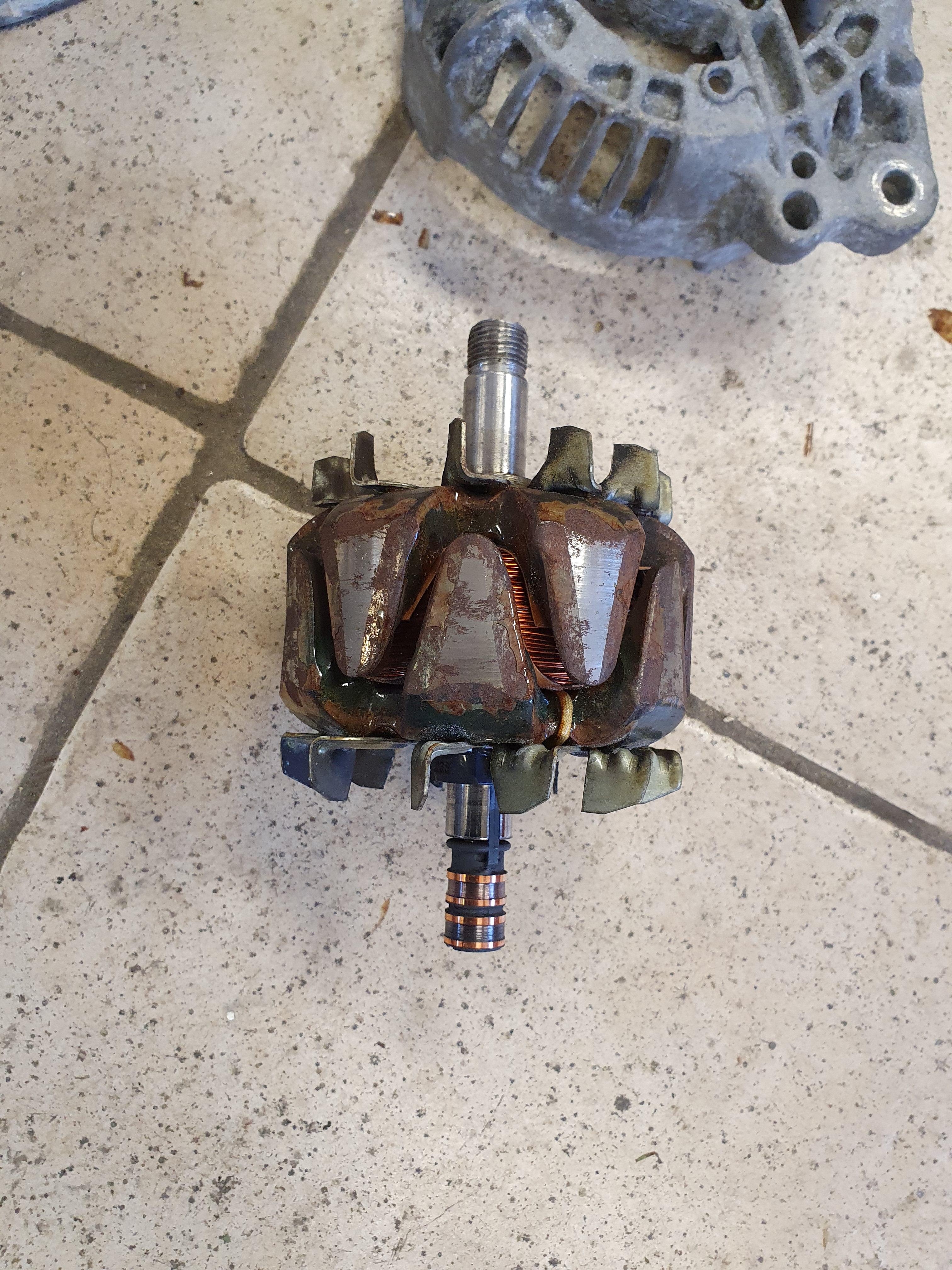

Mostly just for fun I want to convert a (or a few) alternators.
I first made an easy conversion that I played with a little on a Bosch 140A:
I tested a little in delta and Wye, but it is annoying to need power to the field winding and to run sensorless..

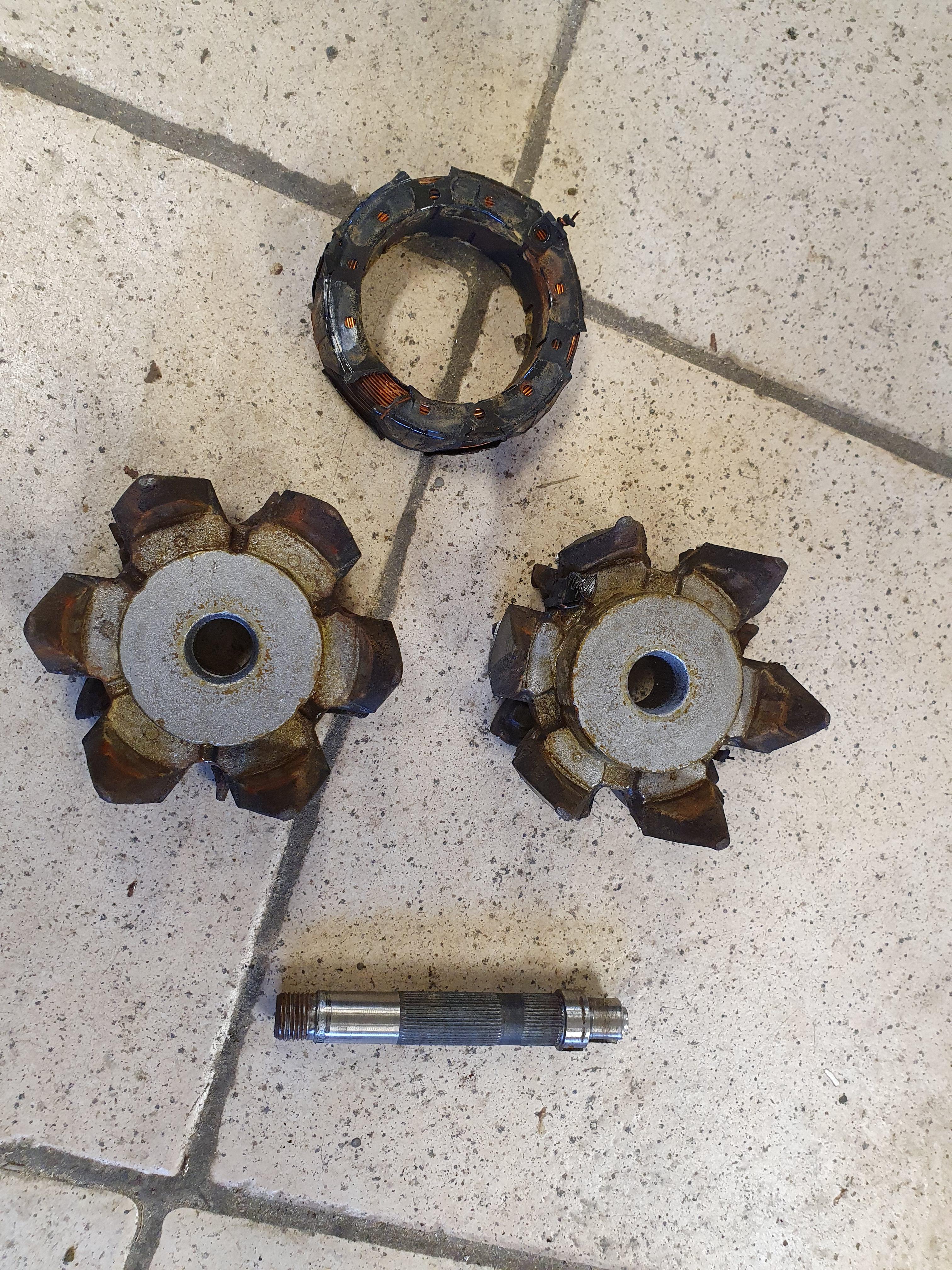

I took apart a valeo 120A alternator with a broken field winding, and tried to take the rotor apart. I eventually got it apart, but damaged.
I have one more, and now I can take it apart without damage.
The plan is to replace the winding with a magnet. To fit it should be 83mm dia, 60mm hole and 30mm thick.
I found a ferrite magnet that is 80x40x15, pulling force 9,5kg. I could stack 2 of them to get 30mm and take off some material on the rotor claws to fit the center hole on the magnets.
Would that work, or do I need stronger magnets?
I would like to use Bosch alternators, they seem to be better.
Valeo laminations:

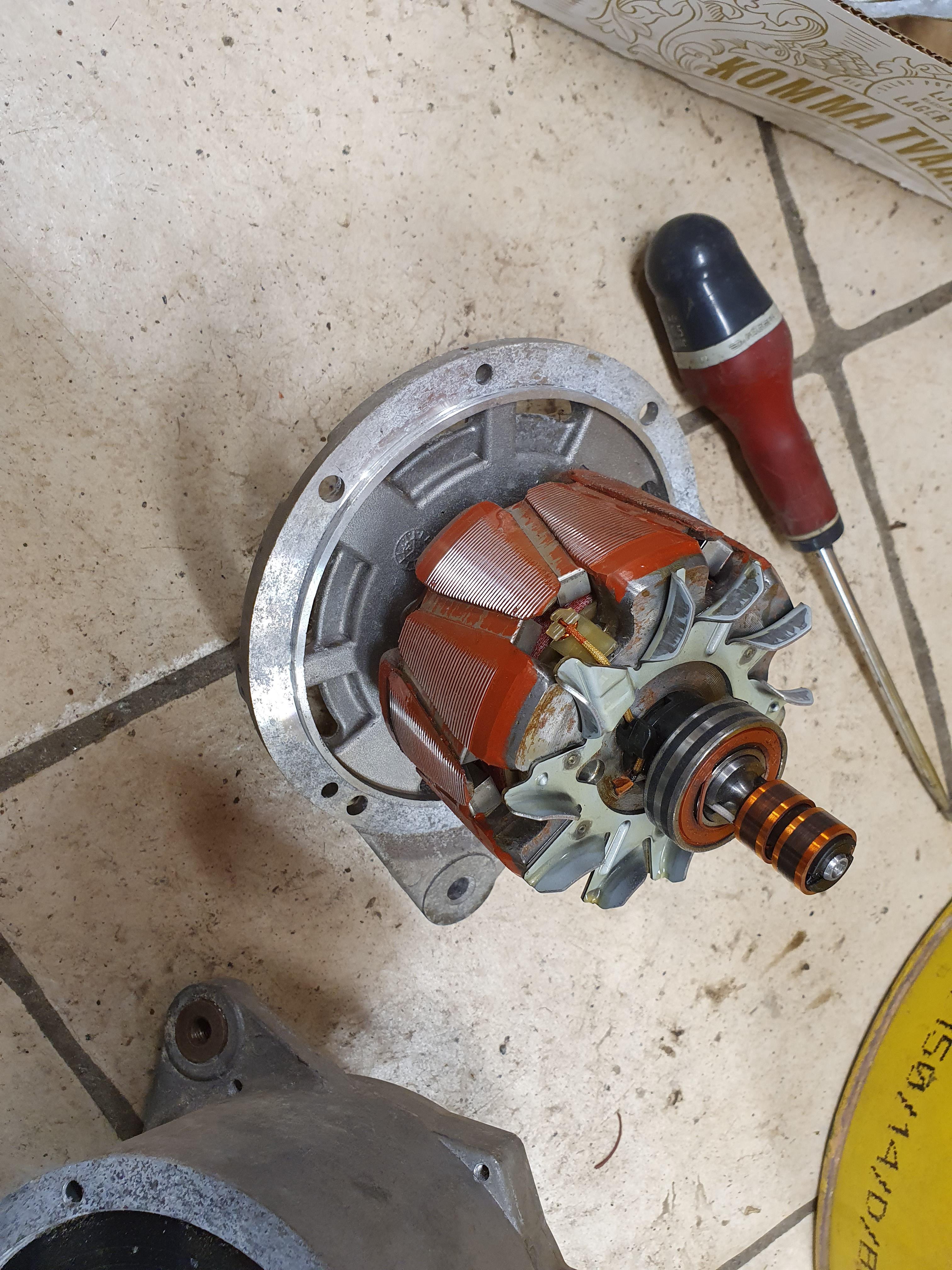

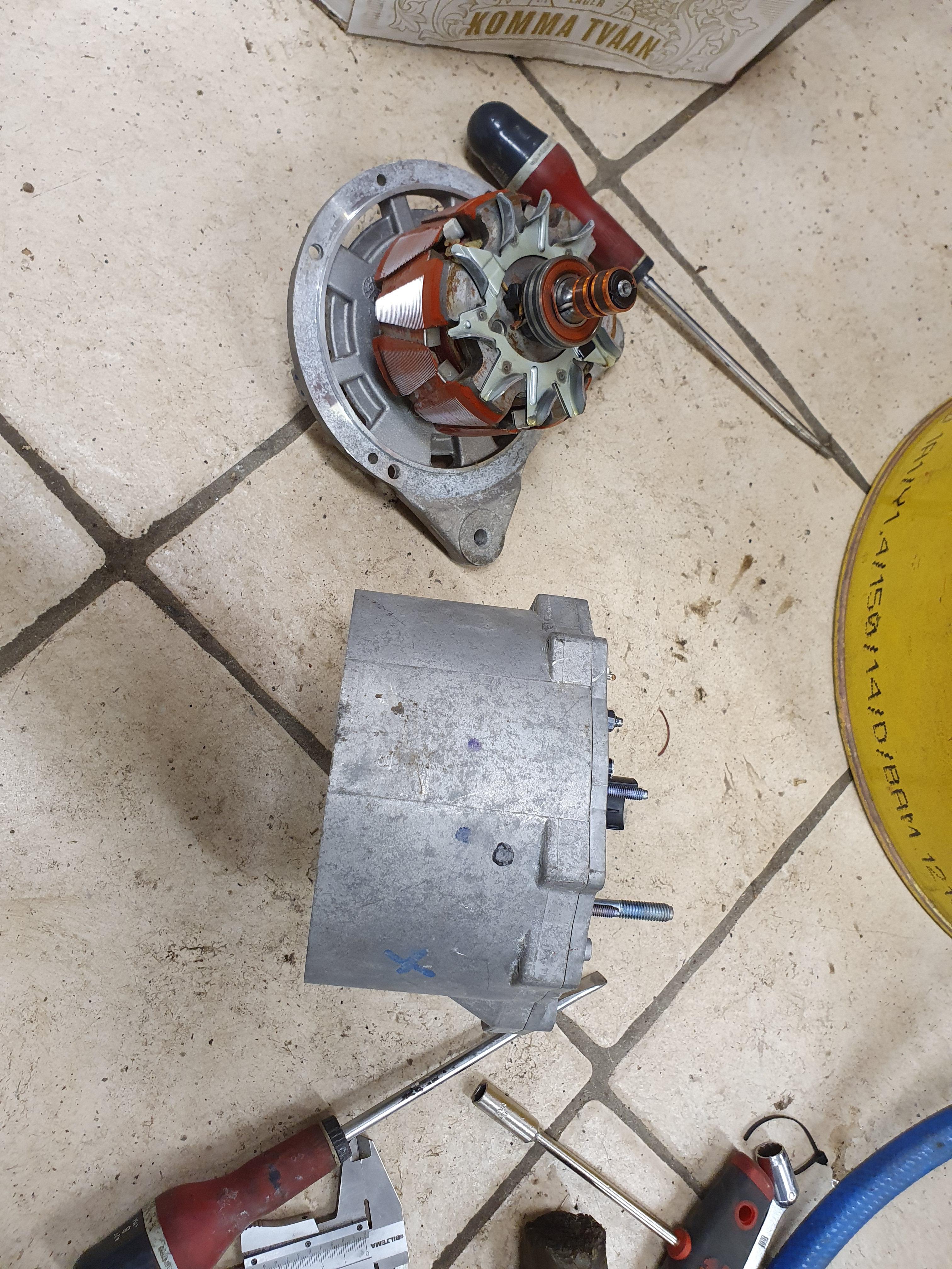

Bosch laminations:
But so far I have not been able to take the bosch rotor apart:
I have tried to press out the shaft in either direction, but so far no movement.
I havent tried to pull one half at a time. I tried that with a puller on the valeo, but the only thing that led to was damaging the rotor.
On the valeo rotor I eventually could press out the shaft from the rotor by pressing on the pulley side on the shaft. But that dont seem to work on the Bosch.
If someone knows how, I am interested. Otherwise I guess I take another bosch rotor and beat on till something gives, so I can find how it should be done.
If you haven't already, you might want to read around the forum for altermotor and/or alternator. There's a number of threads that may have useful info for you.
I have been going trough some threads, but none of them use permanent magnets.
I know there should be at least one, where they built a new rotor. But I havent found that so far, and I dont think it matters much because it is different.
I want to use the original rotor with a permanent magnet.
But I hesitate when I found out what strong magnets in these sizes cost :shock:

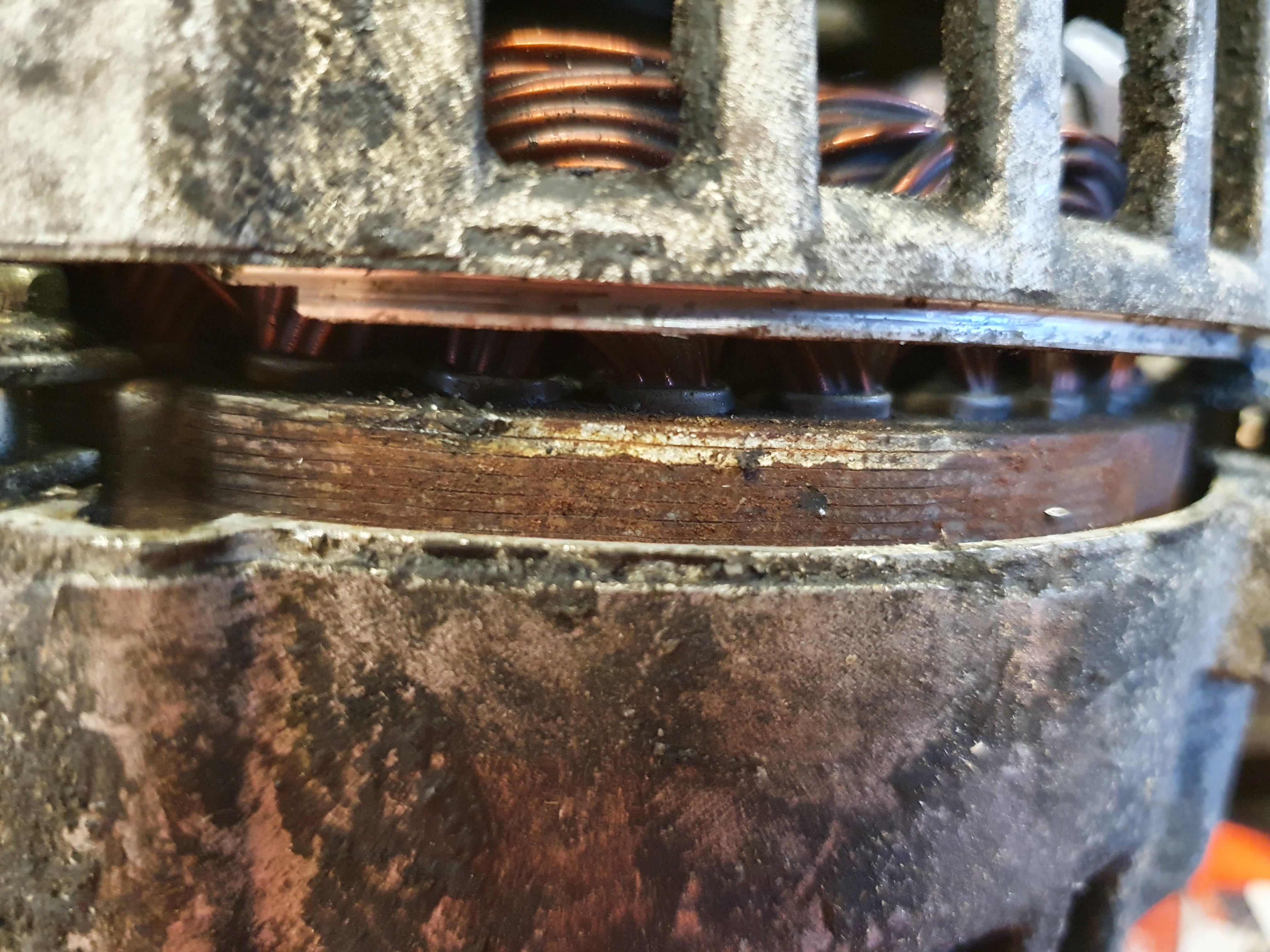

The hall sensors arrived:
41F, a picture dosent really show how tiny they are.
I knew the measurements, but was still surprised when I saw them.
But being small didnt mean it was easy to mount them..
I removed the top plastic insulator over the windings in the slots, and pressed on small rods in the slots, pried with small screwdrivers etc. to make room to be able to slide in the sensors.
The two in the middle are pretty good in position I think.
The one to the right is a little tilted and not all the way down to the middle in the slot.
I started with 12 sensors, but when I got this far I had broken a few. I decided to leave it and start with the one to the left instead.
As you can see that one is pretty badly tilted.
I am down to two extra sensors now.. I tested these I have mounted, and they all worked. I then decided to try it.

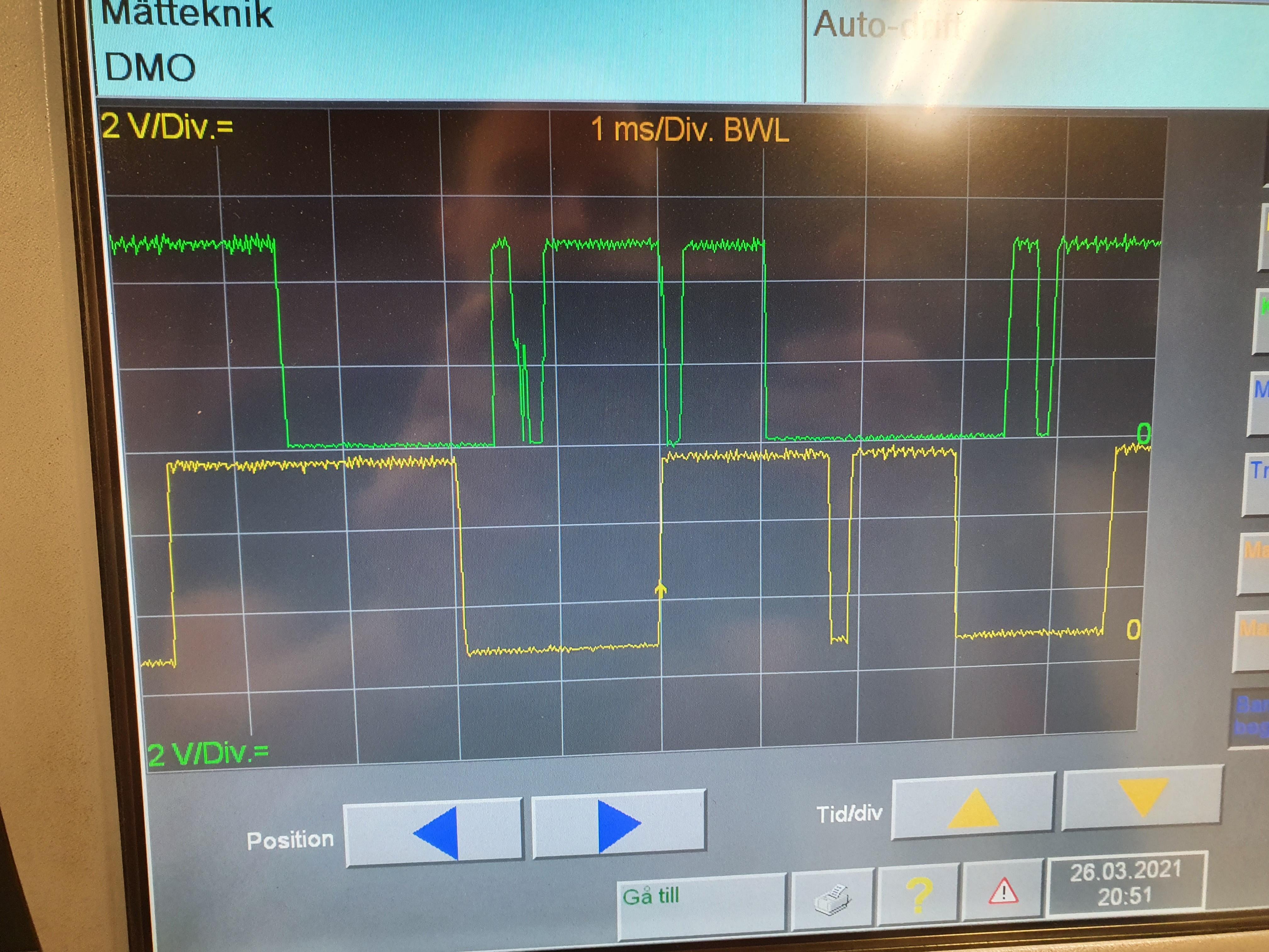

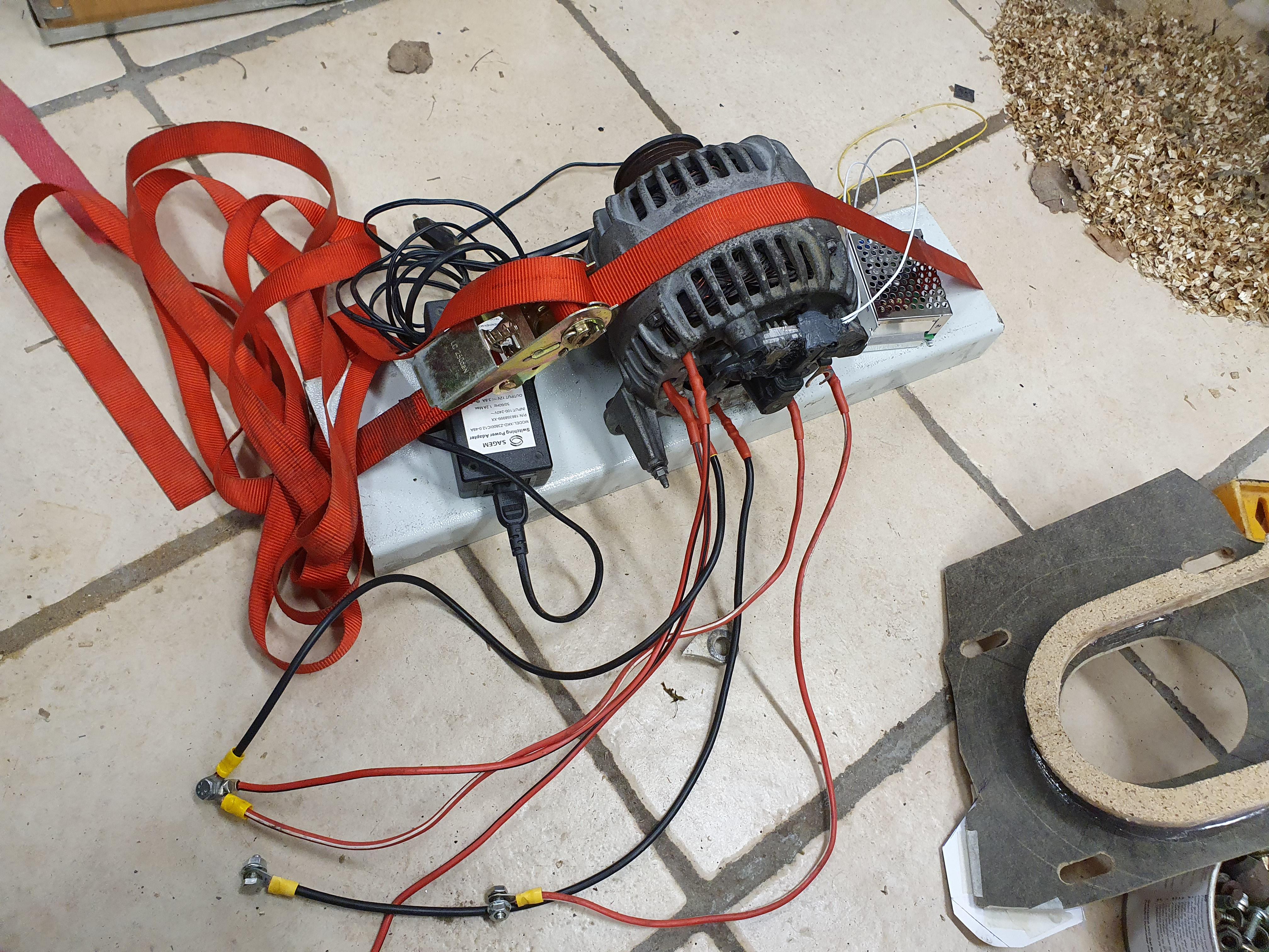

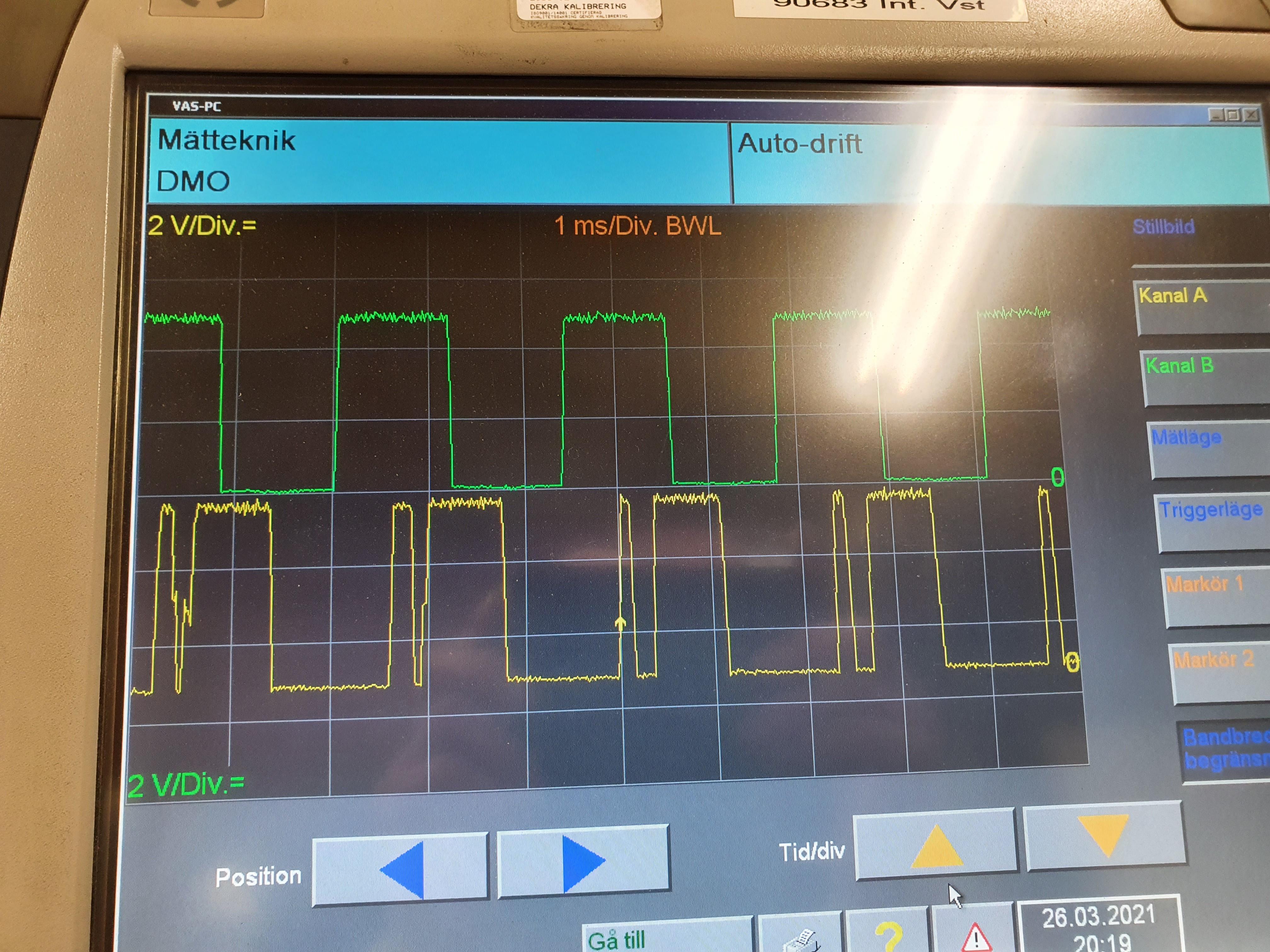

I have ran it with a nucular, motor setup works fine. It starts fine from standstill, runs smooth in both high and low rpm. But if I am quick on the throttle it seems to loose sync. It jerks and makes noises. I dont get any fault when it happens.
I think it is the higher currents or magnetic field in the stator that affect the hall sensors.
*Would getting a third sensor in a better position than the one to the right or left make a difference?
*The wiring from the sensors. It is very tight, and if i run it under the windings it hits the fan on the rotor. I wasent able to run all 3 wires through one slot, so I ran two on one side and one to the other side. It just happened to be the + and - to one side, and signal to the other. Should I try to run the - and signal together instead, maybe try to twist them a little if possible? You can see the wiring from the sensors in the picture.
*Is it just too much interference from the lamination's so close to the face of the sensors even if I get them perfectly strait?
*I dont have anything "extra" in the wiring now, should I add resistors or capacitors?

Yeah, you NEED 3 sensors, and its better to keep them at the same level in the middle
Check Austiwawa's Channel for a hall tester schematic, so that you will know if the sensors are working as they should, then after comparing your LED signals with his, then you can test on the controller

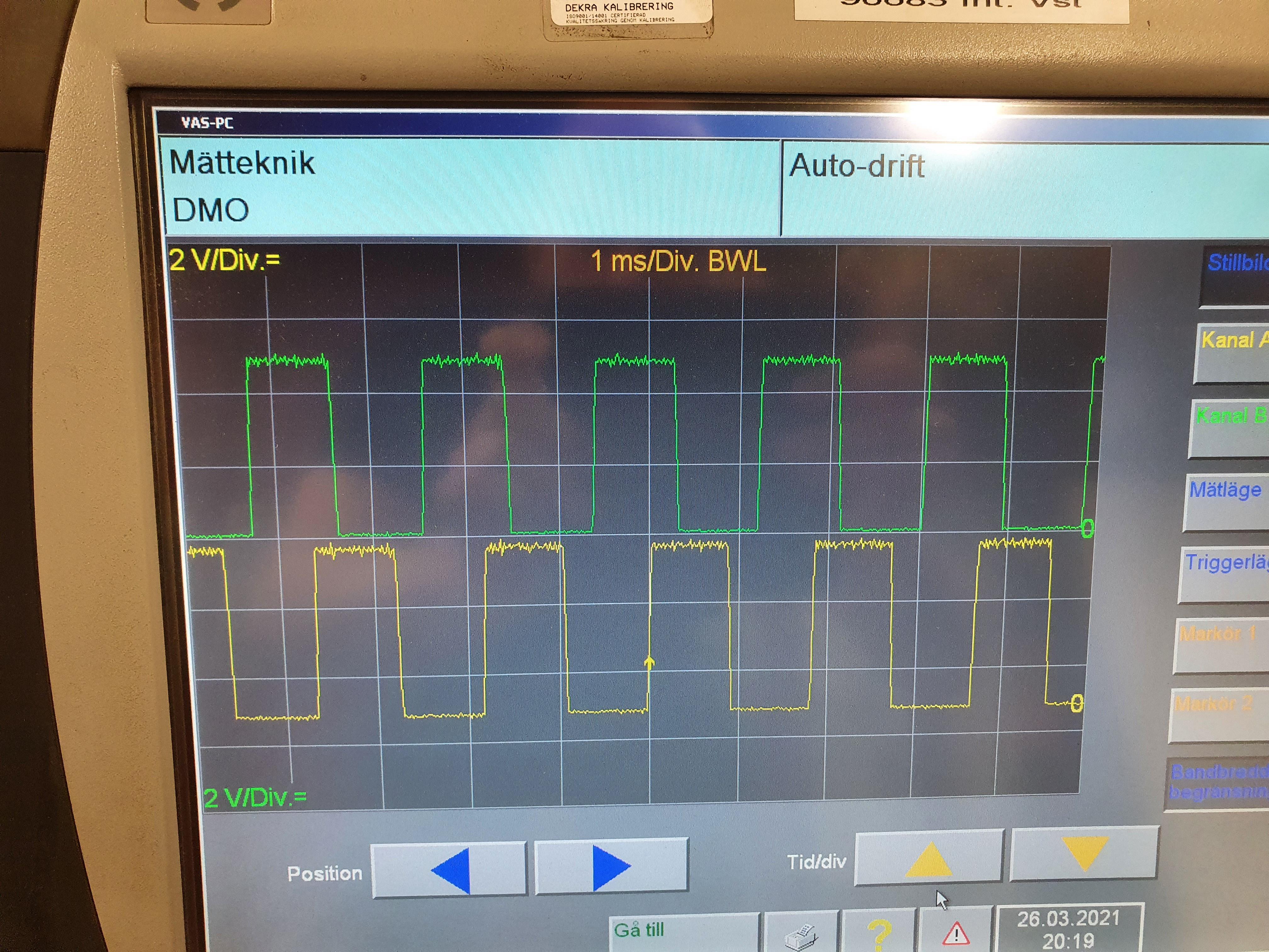

I found a way to put about 25A trough one phase at a time. The rotor dosent really lock in a position, I can move it easy a little in each direction. And in that little movement one led on my tester turns on and off for each phase.
So I guess that means the positions should be ok, but I think I should get an oscilloscope and look at the signals.
Maybe I can determine if one or all go bad under load, or what the problem is.
