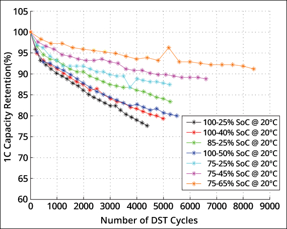

What's the mileage lifespan of the typical battery on an electric car?
With or without Thermal management? Climate and average SOC also important questions. Saw a Model 3 drivers posting pack capacity of his with 200K miles with better than 80% of initial stock capacity. I have not heard of any of the leaf packs doing as well. At least from the warmer areas of the country. Not sure if this is tallied anywhere.
Battery university did some summary of various charge discharge cycle scenarios.
batteryuniversity.com/img/content/DST-cycles-web2.jpg
for some reason image is not posting?
Figure 6 illustrates dynamic stress tests (DST) reflecting capacity loss when cycling Li-ion at various charge and discharge bandwidths. The largest capacity loss occurs when discharging a fully charged Li-ion to 25 percent SoC (black); the loss would be higher if fully discharged. Cycling between 85 and 25 percent (green) provides a longer service life than charging to 100 percent and discharging to 50 percent (dark blue). The smallest capacity loss is attained by charging Li-ion to 75 percent and discharging to 65 percent. This, however, does not fully utilize the battery. High voltages and exposure to elevated temperature is said to degrade the battery quicker than cycling under normal condition. (Nissan Leaf case)

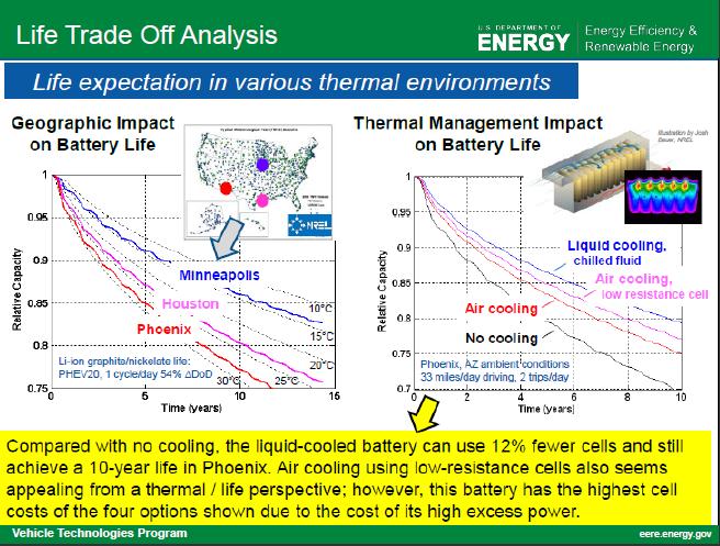

Here is one on region - cooling from green car rep...
When looking at EV's need to look at the battery data. How much the battery is charging up to. They don't publish this only miles. Don't go by miles. You want a used car that is charging up to 80-90%. 70% they claim you need to change the battery. Life of a battery we all know is how it was treated and cycles. So don't depend on miles.
