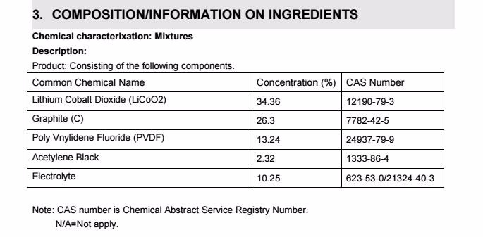

Ok so these are claimed 3000 MAH 15 AH continuous and 30 AMP peak per cell. They are listed as IMR batteries which are Lithium Manganese Oxide (LMO). Now I have been testing these and they come out to around 2000 MAH per cell. I have used other clones about 2 years back (probably same battery) for a power wheels upgraded pack no problems at all and those dual motors can pull some peak amps (60A/120A peak BMS protected). I used them in a 6P6S pack. Now the seller doesnt know the chemical composition of these cells much but they sent me a PDF from the factory which mainly has them at Lithium Cobalt Oxide(LiCoO2) which are usually 1c rated. Picture of what they are made of below and the PDF if I can attach it.

Did you notice that the PDF they sent you, "admit" that the cells are only 2200mah?
The 3000mah on aliexpress is just sales inflation.
