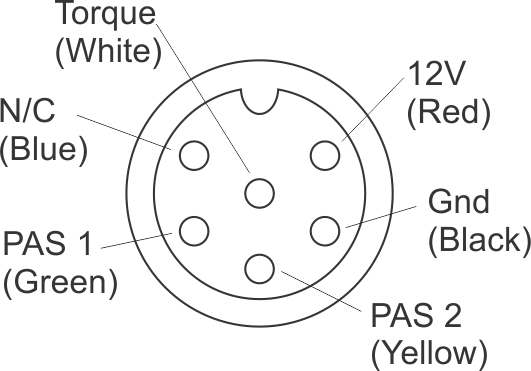

What happens if you directly connect the torque sensor to the PR and configure the PR to respond direclty to it, disconnecting the CA's throttle input entirely? (this would eliminate all delays / etc caused by any CA functions).
At least some Sempus have a torque output that approximately corresponds to a throttle voltage range, so if you need to you can configure the PR's throttle input voltage range to match what you actually see on the Sempu, and use it as a "pedal throttle". This method skips the cadence sensor entirely, and would have no delays other than whatever delay the PR itself has to it's own throttle input.
Alternately you can use the TS and cadence inputs on the PR to do it if yours has one, and then tune the PR similarly to how you have tuned the CA to see how it's response works out.
PAS Connector: A 6 pin HiGo plug provides an input for the direct hookup of either PAS or Torque sensors to the motor controller. This is required for pedalec ebikes that don't use a Cycle Analyst. With a Cycle Analyst system this plug is not used as the PAS sensors, throttles, and all accessories plug into the CA3 instead.
I have a PRv2 I believe, which does not have the PAS sensor. I'll double check the torque voltage signal and see if I can plug that in -- thanks for the suggestion (I remember reading something like this long ago but did not think about it anymore).
Ah. I use the PRv6, but just got a slighly used PRv1 (I think); not yet worked with (just powered up and verified it can talk with the PRSS over serial). it doens't have the PAS / torque input either...the v6 does but I haven't played with it yet.
