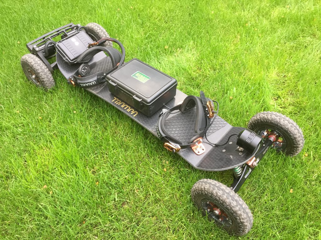

IT'S ALLIIIIVEEEEEE! Received VESCs from @chaka yesterday. Today I made myself one of the best birthday gifts ever ;) Trampa is up and running again!

I just came back from 14km long ride, I charged each cell to 4.18V, and after this distance I finished with 45.5V on a display so arround 3.8V per cell. Max reached speed 66.6km/h :twisted: ...decent stats :D

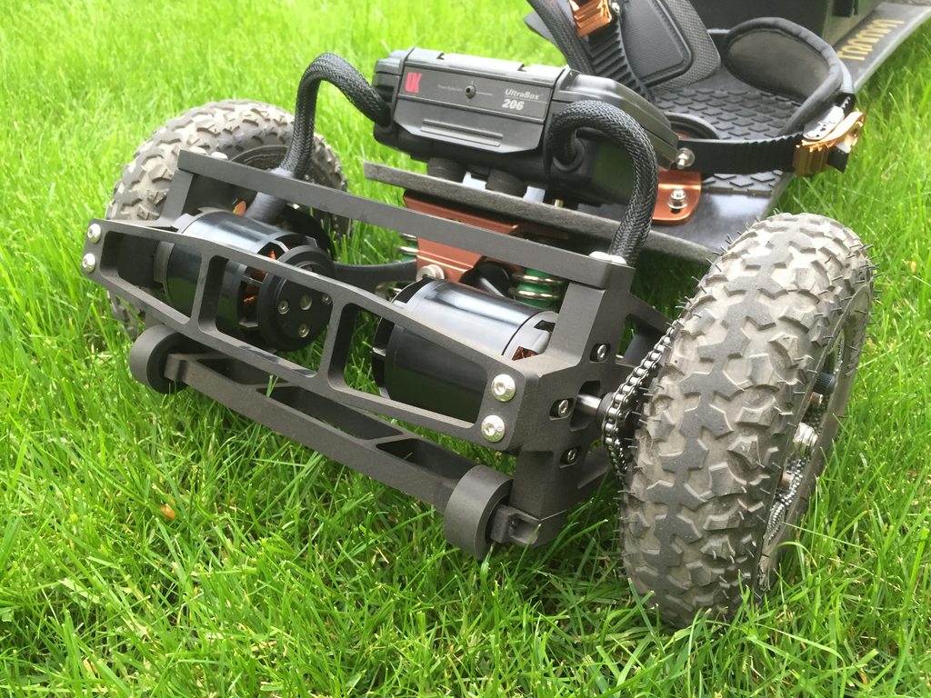

Thanks man! I milled everything by hand, and have some sketches I made. Chaka from ollinboardco is super helpfull and his VESC customer care service is the best! He took care of my burned one and I recently send him another VESC this time with probably DRV chip failure (probably caused by FOC). If You're interested send me PM with You email and I'll send You my sketches, but please keep in mind I strongly based my desing on Jenso idea.

Thanks! Later I realized that there is an internal 200A diode in the mosfet... (as in most mosfets on the market, it's hard to get one without it), the e-switch itself works flawless, mosfet blew up just because VESC failed first and caused short in the circuit.
Hybrid mode means that until Your motor hits set electric RPM limit it's controlled in sensored mode (which requires obviously sensored motor) and then switches to sensorless comutation, so You get best of both, high torque with no cogging at startup and efficiency of sensorless operation at high erpm.
Motor sprockets teets show some wear but nothing tragic, chains seem to hold on decently too.
Can't give You any specific values of amp draw at certain speeds as I did not memorize it, but I don't remember this value to exceed 160A while climbing offroad REALLY steep hill. Normally while cruising it's arround 20-40A.

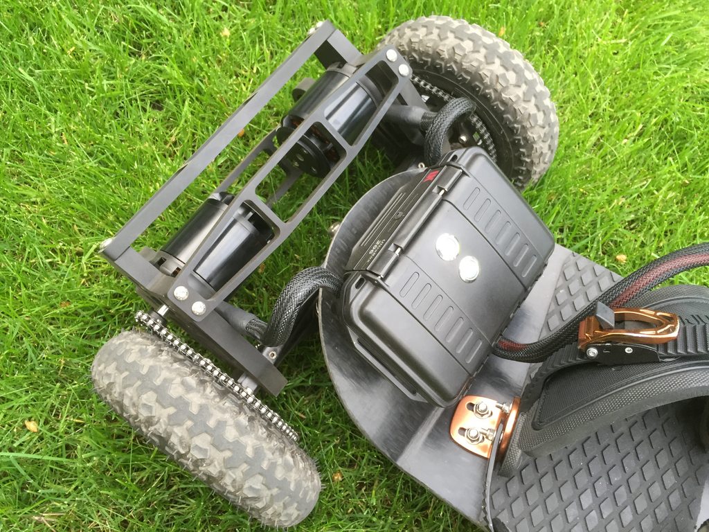

Been wanting to ask, where'd you find those power bottons for your ultrabox?
Squad said:
Mine turns on when board draws power, it's automatic. Thanks, I made some changes and almost all updates are in my thread on electric-skateboard.builders which is named almost the same.
