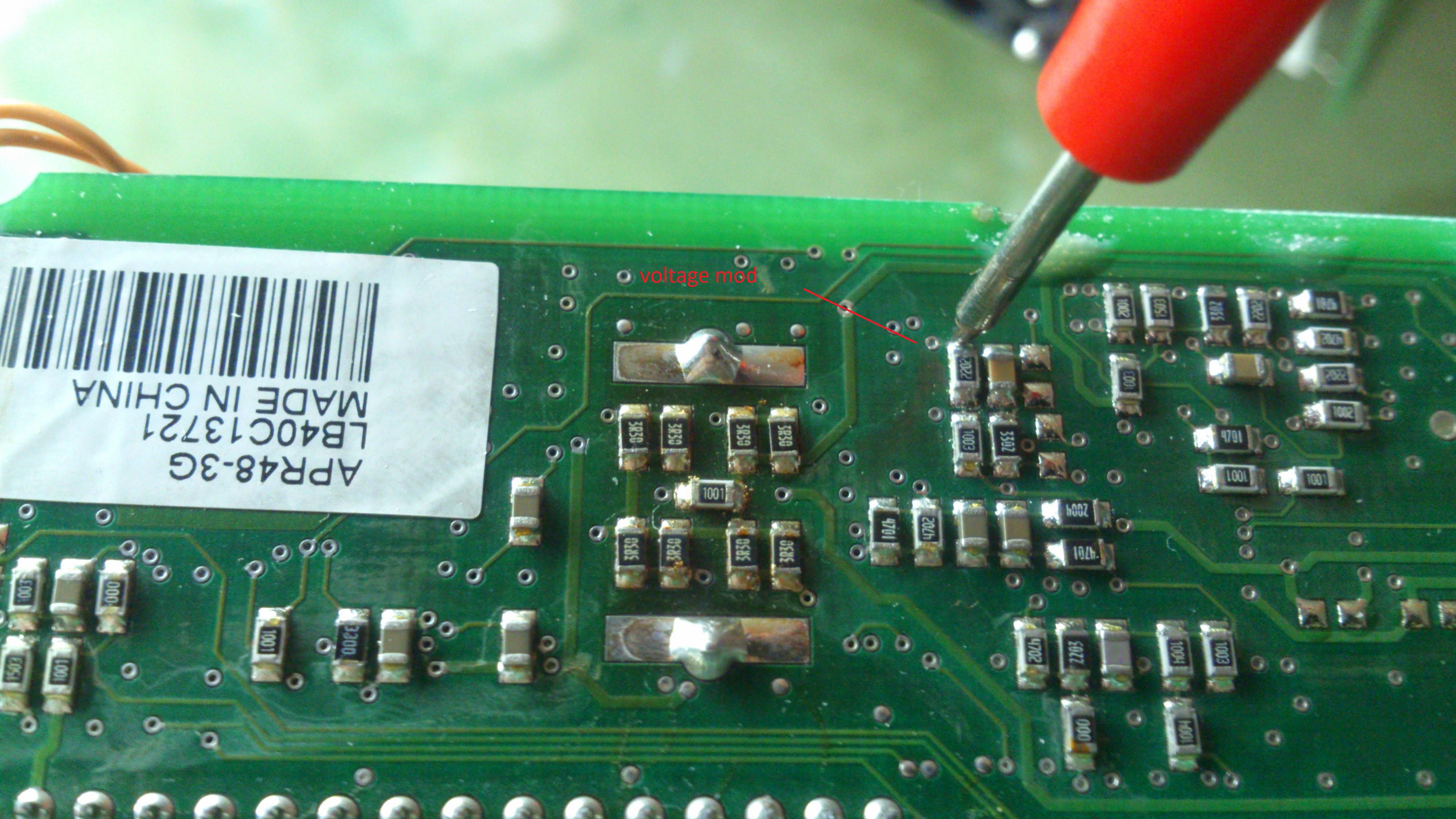

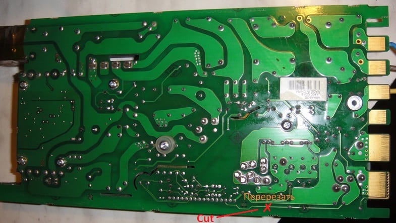

current can be adjusted by hardware, 0 ~ 38A
Think I found our friend video for the hardware adjustable current modification of the APR48-3G.
Unfortunately it's in Chinese...
Even if I don't understand anything it does not seem to be easy anyway...
https://www.youtube.com/watch?v=uhPeFq1HjHM
I found a schematic for the electronic of the FlatPack 2.
There are some similarities with the APR48-3G but the quality of the file is quite low
Difficult to read everything but if it cant help to find how to change current via an hardware mod it would be awesome :)
