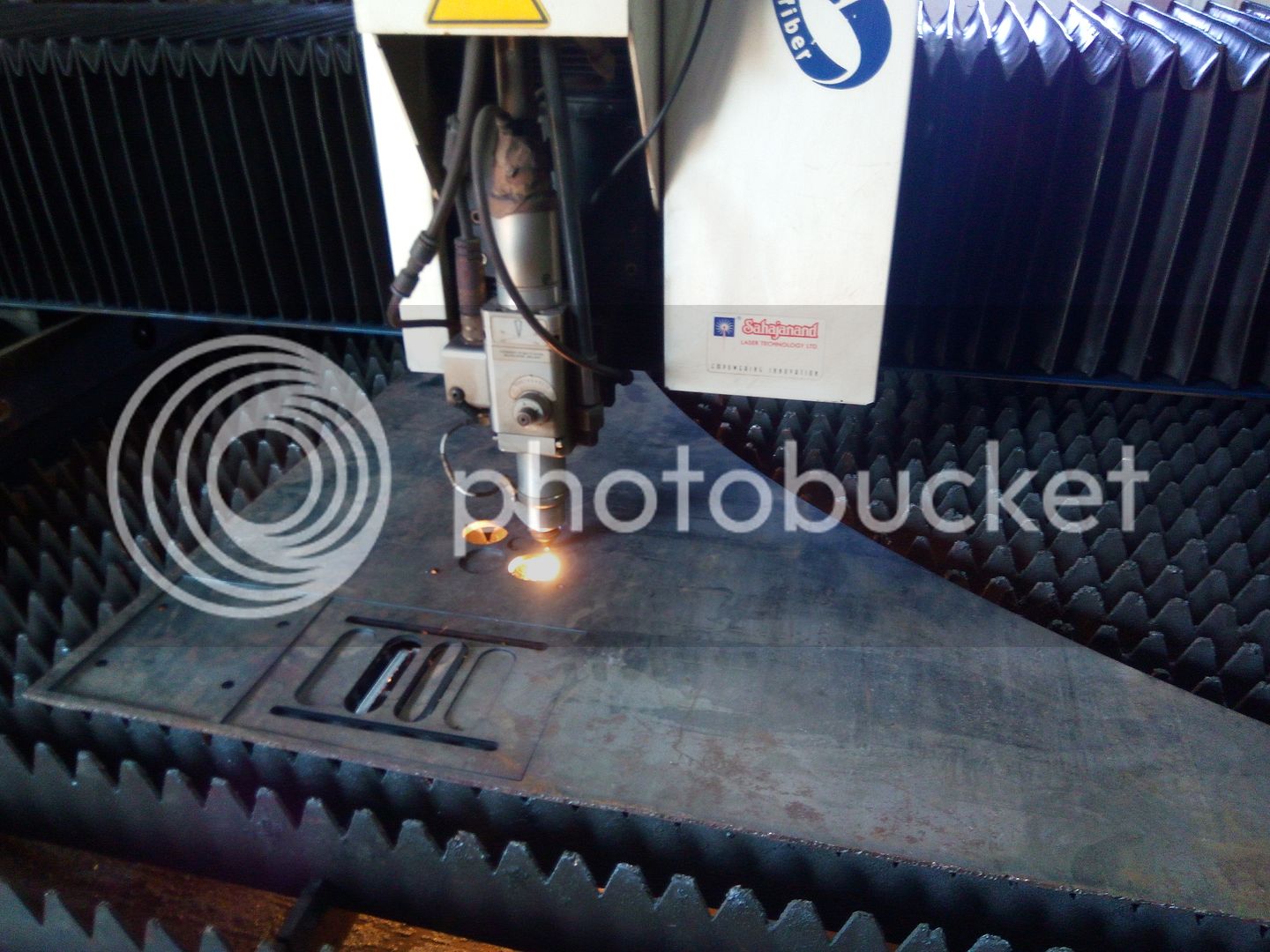

Finally after a long period of inactivity i got some time to work on the designing of motor mounts this weekend.
i finally decided not to mount the motor on the swing arm. though its easy implementation i realised that for the shape of my frame the motor mounted swing arm wasnt looking good. it had an odd look so i decided to mount the motor inside the frame cradle in the more conventional fashion. though it may be a little difficult to impliment ill still attempt to make the bushes of the swing arm concentric with the motor shaft to avoid chain slacking issues during shock compression.
i designed the motor mount in onshape. it has a removable back plate design to dismount the motor when the mount is attacted to the frame.
the mount itself can be moved laterally ina slot on the bed plate for correct sprocket to drive alignment
the mount and the base plate which has slots for lateral movement of the bolts of the mount
decided not to hand cut the plates for the parts for the mount and went to a nearby laser cutting services and got the parts cut in 5 mm Mild steel
it took hardly ten mins for the cut . 5 mm was the max thickness their machine could cut
since i dont have a welding machine i went to my local guy to help me weld it . attached a small clamp on the rear plate which can be removed for motor removal
