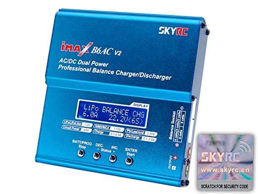

Charger - did you forget a power supply? I don't see that is one of the "v2 AC" versions. You will need an AC to DC power supply to give that charger 12-18v DC. There are some that have a small laptop power brick built in - usually very slow compared to a nicer dedicated power supply. What this actually equals is slower (not terrible for smaller packs) charging. If you get bigger battery packs down the road your 5-6A max charging is going to equal longer and longer charge times.
I would suggest either getting a decent'ish power supply (i'm a fan of the Dell Server power supplies on ebay that are converted to RC charging w/ 12v out (usually 50-60A!) and are only around $35). OR get one of the AC/DC chargers like:
http://www.amazon.com/Genuine-SKYRC-Power-6Amps-50Watts/dp/B00ND7J38C

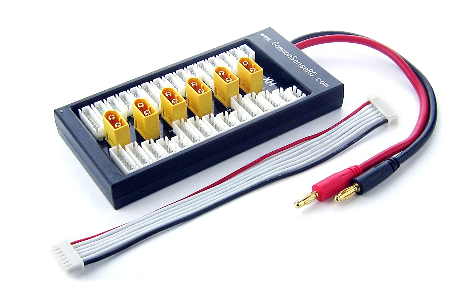

Also worth having, but not needed to start - get a parallel charging board like this:
Get the right one w/ your correct battery connectors. What this lets you do is charge multiple batteries at the same time. You connect the single power and balance plug to the charger, then plug in up to six batteries (or just two) power and balance plugs at the same time and it will charge/balance them all at the same time. Instead of charging one at a time (which also works to start).
