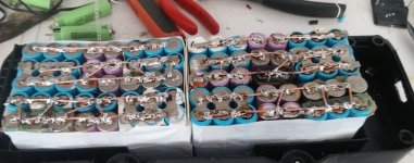

Just build a home made pack from recycled cells from some military batteries I had laying around. A mix of two types, I tried to balance the capacities in my strings while also trying to keep the original pre welded groups for stability. Then I soldered 12gauge wire connecting them. I got 10s8p so about 19Ah @36v which fits nicely in the battery box that used to hold 2 12ah12v SLA batteries. Tight fit in one dimension and enough room above them to put the BMS. I built it as 2 groups ov 5s8p, which basically replace 1 SLA each. In building I used tie-wraps to keep the pack tight as I did the soldering. Grinding the nickel tabs and tinning each before I added the connecting 12-gauge wire. Plenty of cross connects in the serial direction. After soldering each brick is very stable.
I started the build after buying a used amped bike kit (36v front hub). It included a bottle battery with BMS. Unfortunately, absolutely none of the 40 batteries from that system were usable. All would charge to 4.2 a dozen or so would stay stable at 4.1X few days while other self-discharged to 3.8 or so with 2-d days. (and after 3 weeks some discharged to 2.3). None had a capacity of mote than 500mah despite being pansonics rated at 2.5ah (the green ones in the photos below). Given the system had a BMS I was puzzled as to why none were working and did lots of reading here. I gave up on them and built the pack without them. Eventually I found out why, the kit I bought (which the owner said only lasted a few weeks before the battery would not longer work), was supplied with a 44v lifepo charger not at 42v lion charger. I had initially hand-=charged all the cells before the build, did some testing then pugged it in to the charger to test the BMS. Luckily Id did not leave it alone too long, as after 30min the batteries were at 4.3v.. and the BMS was super hot. Of course I should have check things, but somehow expected the "kit" had the right charger. Learned once again to Check Check Check. And its a clear lesson that BMSs are not a bullet proof solution.. could have easily caused problem (on my pack or the original) if left plugged in for days.
In the end I leaned a lot from this (and other) threads. Thanks for all the advice/experience of the group. A few pics below.. I'm still learning, so would appreciate any feedback on the build.
Not shown in picks, but I wired the BMS so that it is for charge only (it was only 10A and I wanted to be able to use more current while riding. I can monitor imbalance by hand and expect I'll not get near LVC anyhow and will be setting up for a celllog8.
One last question.. any advice on setting up so I can have a Celllog monitor 10s? I was thinking I could do 2 connectors and check both, but from an alarm view I wondered if it could handle skipping cells (so monitor 2 at a time) and then just leave it hooked up?
Tips on soldering onto cells:
Fold and solder to excess tab
My preferred method.
Least chance of heat damage with good solid contact!
pre"tin" tab:
flux, solder small bead of solder to tab
flux and pre-solder wire at connection point
re-flux
place wire against battery solder point
use probe (small chromed screwdriver?) to hold together
heat wire only until solder collapses together
continue to hold solder connection steady until fully set.
I prefer to use tinned copper braid.
Seems more durable ... holds up to flex and abuse better
Wrapping battery build tightly with clear boxing tape stabilizes cells and minimizes flex and cell sheathing wear.
Allows visual inspection and multimeter probes easily poke through for diagnosis-testing
