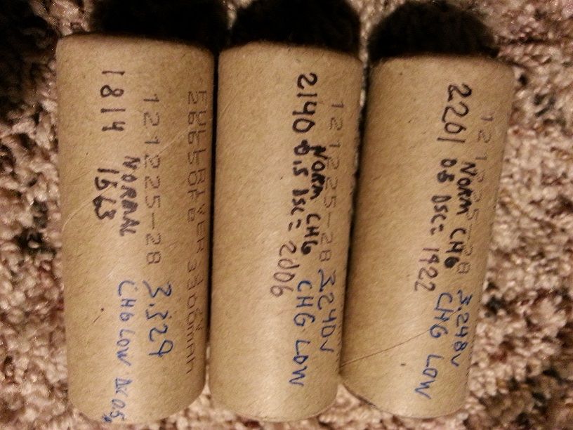

I've bought and tested the fullriver LiFePO4's recently and came up with some pretty inconsistent results
I wasn't able to get close to 3300mAh capacity (by a long shot) about 85% of the time.
Some ratings came up between 1000 to 2500.
I was charging at 0.25A to 0.375A and discharging 1A first like I do with 18650's but these batteries seemed to like a 0.5A discharge (imax b6) to get much more capacity.
I'm going to further test with consistent results to see if I can get some consistent capacities or if these are just bad quality/damaged cells which would be a good reason why they're selling for cheap (near $1/cell) and the company seems to be non-existent I cannot even find a spec sheet on them!
But at your own risk
Similarly disappointed with the Fullriver LiFe.
Preliminary iMax cycle test (3.6V >> 2.0V) proved out near 2000mAh. (3.65V is recommended charge)
Experimented with LiFe charge 3.6V >> LiIo discharge 3.0V with poor results.
Accidentally ran a cycle at LiIo 3.0V >> 4.10 and got 3000+ mAh!

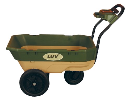

Electric Wheel Barrel-Snow Plow
New Winter project!
Found an electric wheel barrel in the dumpster behind my store.
2 larger drive wheels and a smaller bogie wheel.
(Dual motors for posi-traction)
Motors engage with handlebar lever.
I traced problems to a dead 12V 22Ah SLA and a faulty 40A relay.
Replaced relay and tested with 3sRC LiPo but was disappointed at the 2 mph top speed.
Fun begins ...
At 1st I considered running at 4s for a near 3mph but ... too simple and limited.
So, Why not run at 22.2V (6s 14p 22.2V 30.24Ah fits nicely!) with a pot controlled brush controller.
Will maintain handlebar oem relay function or replace with controller on\off circuit?
Variable <1mph - >3mph
50V brush.jpg - $8
Now ... I don't have much use for a wheel barrel, but adding a plow to the front would be a great snow moving utensil!
Torque and speed should be appropriate.
Just have to add some weight. Sand or bags of salt? ... Rated for 200lb loads.
Chains?
Summer use
Mount rear 2 wheeled platform for standing on and cruising, with load, down the street.
Upper (green potion) removable by screws or add sideboards to upper portion ...
Battery compartment and motors-drivetrains remove as single component for alternate use!

Electric Wheelbarrel Battery Upgrade - Update
Moved about 4 cubic yards of topsoil, about 30 x 150' round trips, half with ~200lb, half empty.
12.3V full to 11.6V, about 50% of 25.92Ah pack.
25.92Ah is oem new rated, actual probably still greater than 20Ah, even with moderated charge voltage.
Wheel barrel with "new" lipo battery, certainly, a very usable tool!
