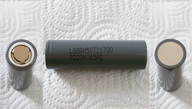

LG INR21700 M50T is a 5000mAh Li-ion cell of 21700 size (also known as 2170).
LG M50T was previously known as M50 (without T) and even in the tentative version of the datasheet the model name was M50. More than a year ago i tested it (Grade B) and compared with Samsung 48G but then i was using v2.5 of my battery holder. This time i've tested a Grade A cell with the latest v3.0 holder.

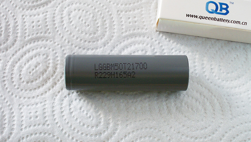

The battery was bought from my reliable supplier (Queen Battery) and tested with ZKETECH EBC-A20 and a self-made battery holder. It's a PC-connected battery tester supporting 4-wire measuring and discharging at up to 20A.
I've used version 3.0 of my battery holder based on 0.5mm thick pure copper terminals
I've followed all the prescriptions of the IEC61960-2003 standard concerning battery's capacity measurement. Before each discharging cycle each battery was charged at standard charge current mentioned in its datasheet to charge end voltage. Before each discharging or charging i've held a 1-1.5hrs pause. The environment temperature was 25±2°C. To be sure in results i've done each test minimum twice (usually 3-7 times).
LG INR21700 M50T
The marking on the heat shrink tube of the tested cell is LGGBM50T21700 R229H165A2

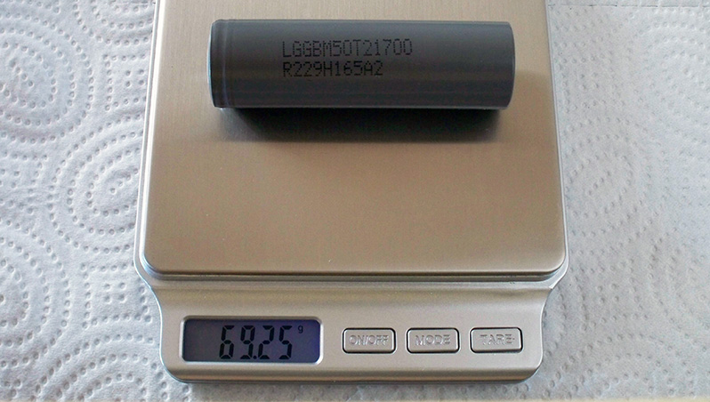

Measured dimensions: 21.2mm (diameter) × 70.5mm (length).
Measured weight: 69.25g

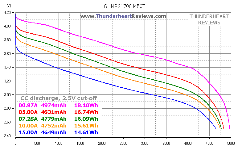

LG M50T Grade A capacity test results:
At 0.2C M50T's capacity is 26mAh lower than 5000mAh (which is not declared directly). Whatever, 4974mAh is not a bad result. The curves look good at up to 10A but at 15A the sag goes too deep so i'd consider 10A as the maximum for this cell.
Verdict
So, no surprise this time... Nothing special to say about this guy. LG M50T can be marked as a good 4950mAh / 10A cell and many sellers list it as a 10A cell, not a 15A one.
