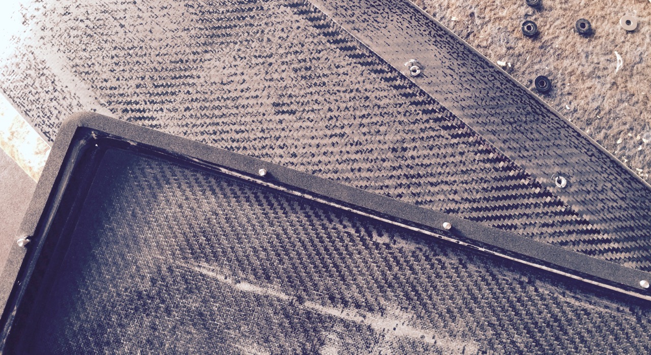

I didnt have too much time today and sadly my finish didnt work out so well due to the air bubbles I couldnt get rid of. sanded the bubbles off today ... probably shouldnt have used my 24hour cure-time air grade epoxy for coating and instead get a gelcoat thats actually made for finishing laminate surfaces. what do you use as finishing layer cause yours look really great? :)

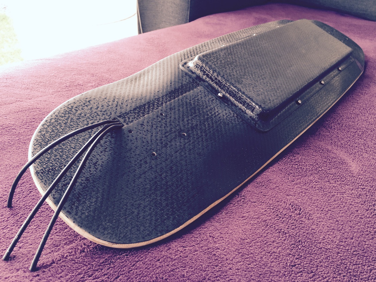

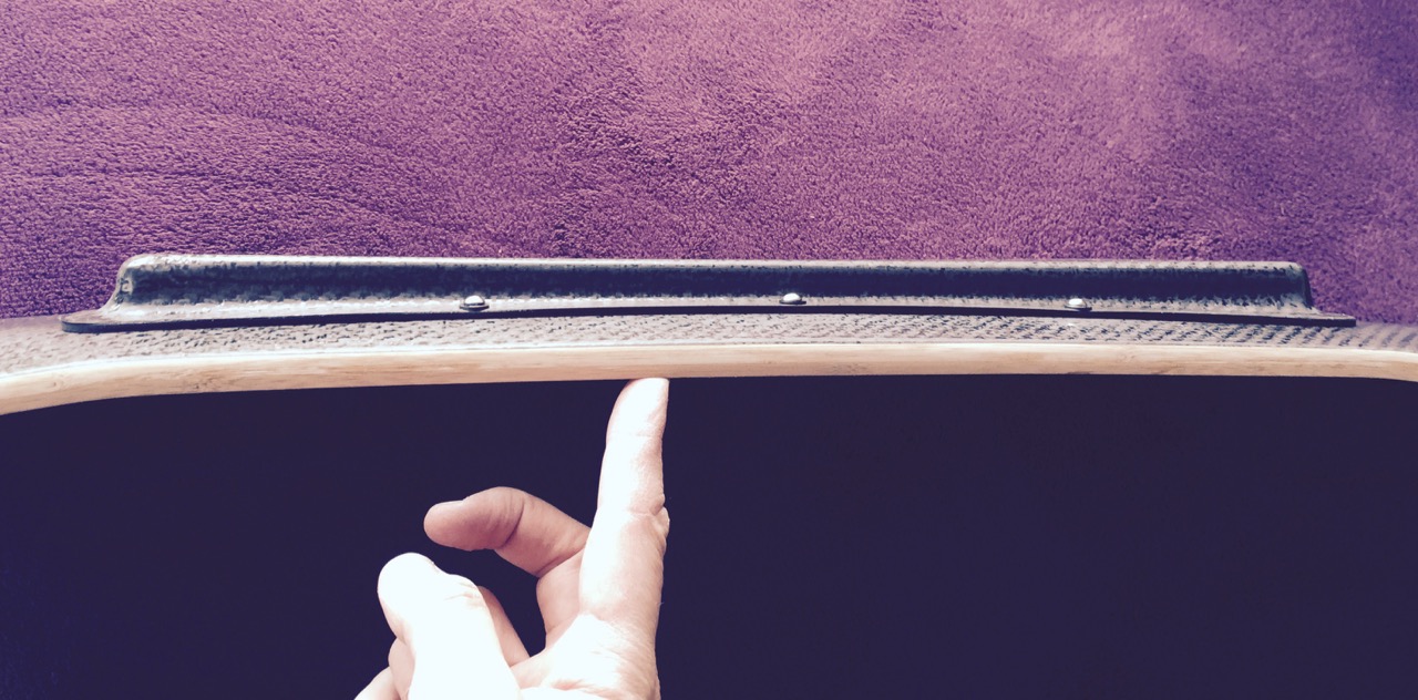

with my last bit of time today, I managed to sink in 7 m4 inserts and fixate the case. pretty happy about how slim it is, you can barely see the case from a police officer perspective :lol:
I dont even want to post these pictures because they simply dont do the carbon quality justice. its all partially sanded and partially glossy, which gives it a very rugged look but i know that I wont do a proper finish very soon, so ill have to live with it for a few days or weeks. got also cool black and orange eloxated aluminum screws incoming with extra slim washers. :)
great job ! don't worry for the rough surface; just sand it with 180/240 and once you are happy; apply standard epoxy resin (no gel coat or whatsoever) that you hot with an hairdryer. this will work fine and make this a mirror. if you want a matte finish, just use a spray can varnish from a graffiti shop

you also have to use a brush , as you were painting but with a ultra little amount resin from one side to the other
you also need to ensure that you don't put any finger on the deck or stuff like that; I usually clean the deck with acetone or white spirit or alcool...

basically thats what I did, but then lots of small air bubbles came up. :/
Best way I have found it to mix up the resin (don't worry too much about bubbles in it at this stage) and then hold it high above the workpiece and slowly pour the resin on. By holding it up high, you are letting the resin form a very thin line to the deck, effectively lowering surface tension and removing any air bubbles. I've found this to be as or more effective as degassing in a chamber, as it is instant and doesn't create heat. Then move it around gently with a fine, CLEAN brush. Leave it away from dust and bugs to cure and you are done. A hair dryer can be used on high heat, low speed to expand bubbles and pop them, but generally isn't needed.

that heat gun air popping thing didnt work well for me. think ill just give it a try some other day when I have more time. :)
think both of our cases are VERY thin. okp used 1x GFK, 2x Carbon and thats what I did too (just following his experience). my case is so light that wind blew it away when it was laying in the sun outside. :lol:
the reason why we have "thick" looking material is, that okp seemed to have used VERY thick rubber/neoprene style band, probably to get the motor wires through between board and case (at least I can see the receiver antenna, its a cool idea but makes the case appear quite thick).
I used a 3mm neoprene band, so make sure that I will never ever hear any enclosure vs board rattling and its waterproofing the enclosure (where otherwise there would be small air gaps, that would suck in fluids with the neat capillary effect).
see here: m4 inserts & 10x3mm adhesive neoprene band:
hihi, I leanrt sonething new about epoxy resin: its an exothermic reaction with the hardener, that much I knew. So i went heating up the mix up to about 40*C, coated the board & case again the mix started smoking, then boiling, i brought the cup with resin outside quickly and 2min later it was fully crystallized and blazing hot. think the thermodynamics werent in balance anymore, couldnt get rid of the exothermic reaction heat.
so yea, not very high hopes for this resin coat either, should just go for matte clear coating. :p
normally there's no need to heat this up to 40 deg. otherwise the energy from the exothermic reaction will be added on top of the 40 deg. and then it gets too hot.
roomtemp is enough.
try that on an extra piece and see how that works. in case it still gets too hot, use less hardener.

this finishing business is annoying. I wish I didnt watch youtube videos about air bubbles in resin surfaces - I tried the heat gun, didnt work so well ... another thing that looked great in the video was to spray an acetone mist on the resin surface to kill all bubbles. well, it killed the bubbles, but probably the acetone mist wasnt fine enough, so there are "islands" of no resin now which looks bad too. :(
problem is that I dont want to hurt the carbon, so I always have to sand very carefully which means it takes a lot of time. think Im done with resin coating. maybe I should test on some practice samples first before I have to sand my board & enclosure over and over.
apart from the finish, Im pretty much done. the enclosure is a perfect fit on the 8 M4 inserts, my triple 4mm gold connector charge/on-off-"switch" is installed on the enclosure, the motor is connected to the vesc via the motor wire channel with 3 12AWG cables, VESC is in place and cables are installed. but something in me just couldnt go skating and leave the surface sanded and ugly. :p

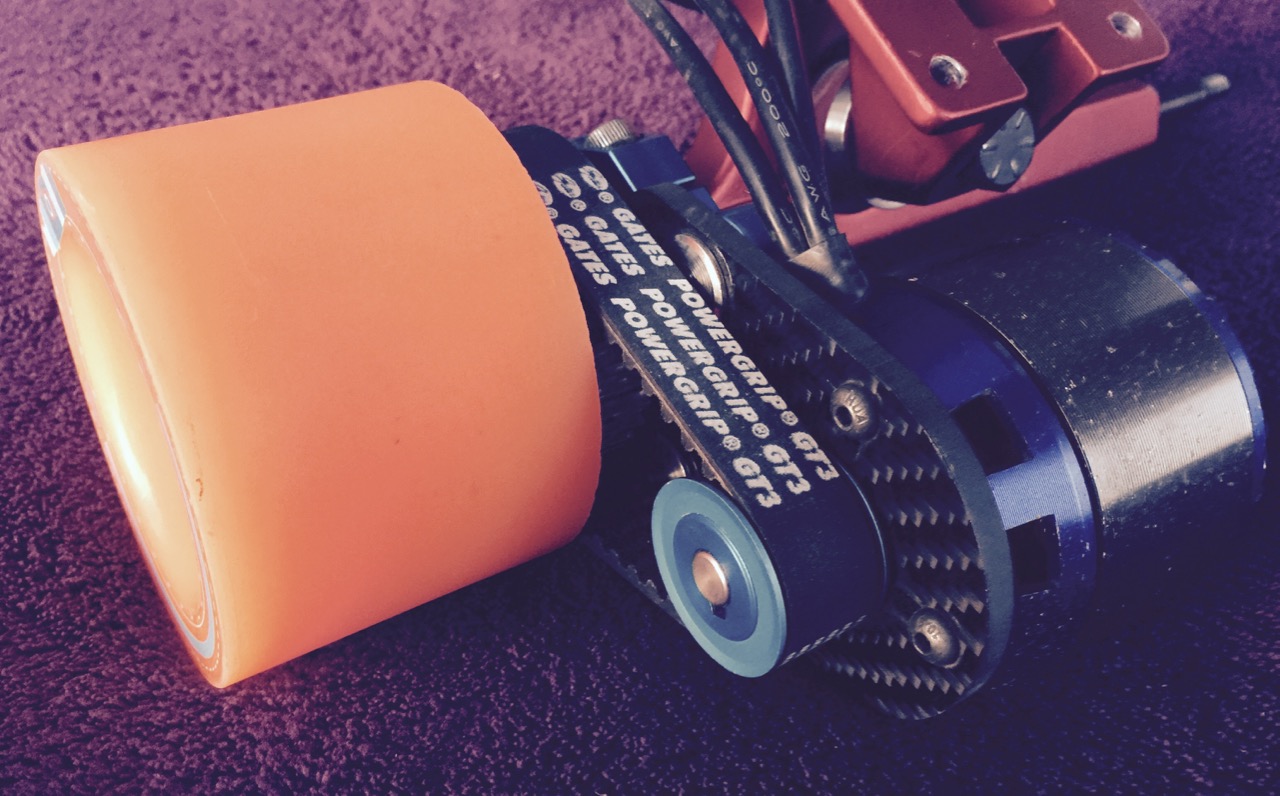

meanwhile my 15mm drive gear arrived from aliendrivesystems (still had a nicely anodized motor pulley from torqueboards). a few people can now throw a "told you so" in my face :lol: with my dual rear setup, I never had belt slip issues, with the single and a fresh belt, I didnt have much trouble with belt slip either, BUT: the older it got and the less tension it had, the more of an issue it was while breaking. must say, 15mm looks pretty smooth: :D
Hi Whitepony, Concerning your GT3 Belt,...I had called Gates Company about these belts ,and was informed these Belts are indeed superior to HTD,... BUT only when used with Gears above 18Teeth i think, had to do with the (GT3 Bend limits), I was told anything under 18T, HTD was better.
That's what a Gates employee told me????
interesting, superior in what category though? I found gates gt3 to be super sturdy. ive lost quite a few enertion standard belts by stones that get between belt & drive wheel -> stone works itself in, belt tears in one spot, belt is a goner very soon.
with the gates belt Ive had stones working themselves in, had a superhard time removing them, but when I did, the belt just held up. so far ive never had to change a gates gt3 belt (used them on topspeed and on my evolve).
