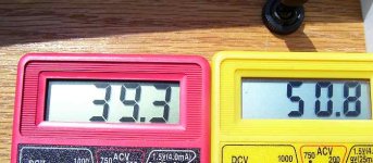

-took some time today to travel the route with not-quite-fully-charged LiPo batteries 10S3P (5S 5000ma each) for 41V15AH and the fully charged 8 AGM (SLA) batteries (6S 12AH each) 24S2P for 54V24AH for fun and games and a weigh-in at the weigh-in station.
First off, the range of the LiPo batteries vs the SLA batteries was similar but not equal. This wasn't a distance run as I stopped at all the coastal viewpoints to, ah, view stuff...
Roads into and out of viewpoints tend to be rugged, for lack of a better description.
results:
The SLA batteries sagged like my grandma's petticoats and could hardly pull their own weight up a moderate hill (4% grade) They were completely discharged in 2 hours even though I kept speeds to 10 MPH most the distance.
(except checking top speed once on the flat to verify what I thought was my top speed @ 54V)8 sla for 48v nom.jpg
ending voltages showed the sla batteries recovered an additional 0.8 volts after resting for two hours
The LiPo batteries brought me back home with capacity of ~40% left. LiPo weight-in is, duh I dunno because I haven't weighed the bat box with or without the batteries installed. But the batteries themselves weigh about 666 grams each per manufacturer's specs x6 for ~4kg or 8lbs 13 ozView attachment 3you remove the black knobs to open the hood...
