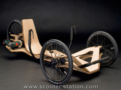

while looking at some ideas for a children go kart, I came along this thing and though about yours :
congrats for your work, it's awesome
