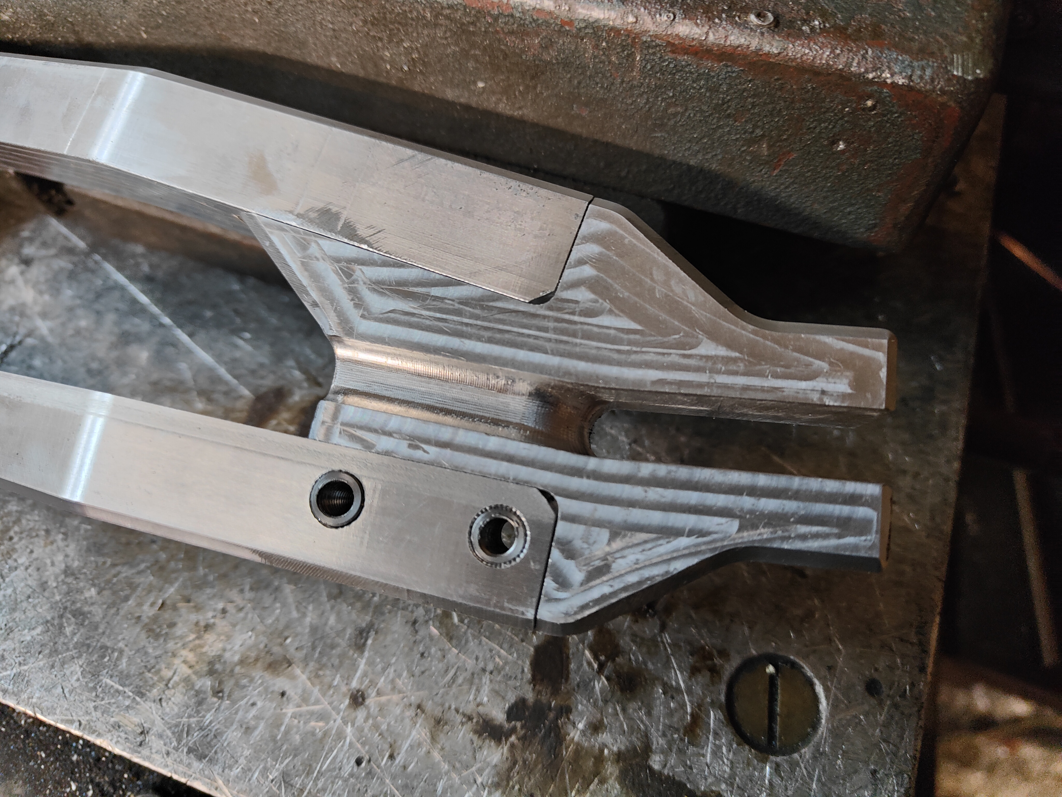

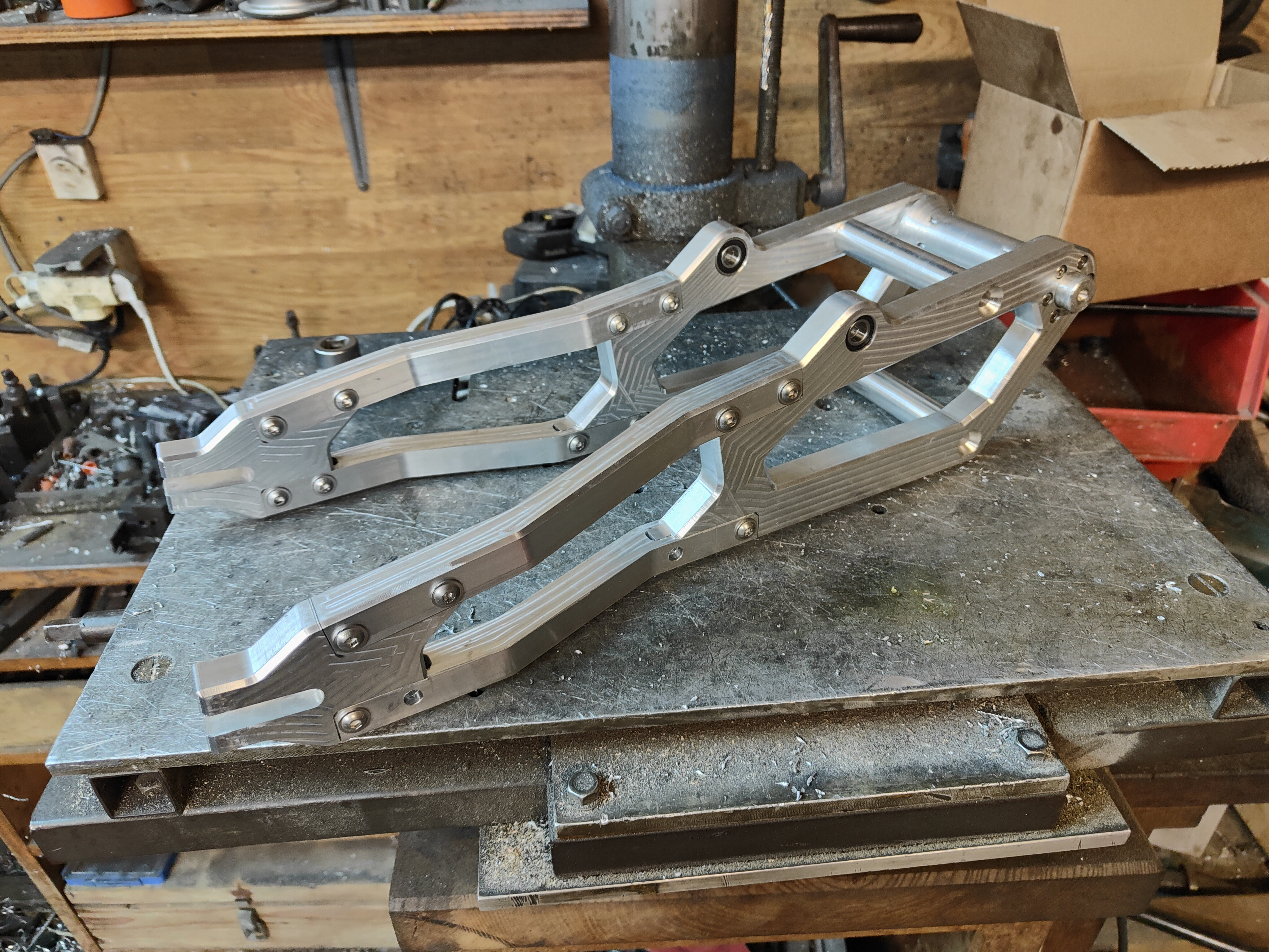

Hi,
started to mill the swing arm with my diy cnc rooter, still impressed by the work of this machine, reached 0.01mm précision for the bearing holes, part are ffitting well, but it take time to assemble it.
here some pictures:

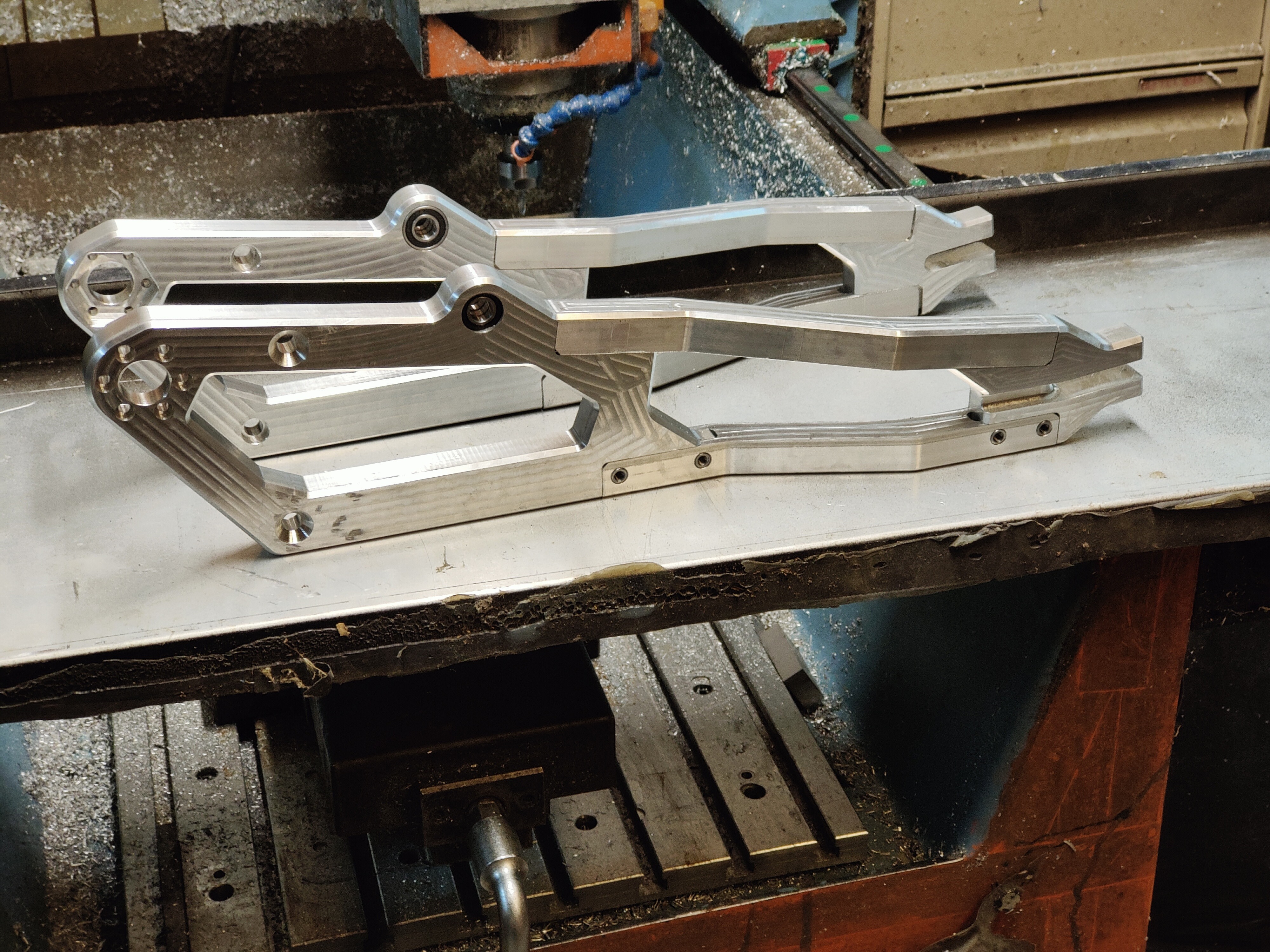

I made some mistakes making the linkage rod between the two side of swing arm so made a new one, it fit better:
bearing spacer
also add the two screw for pinch the wheel axle

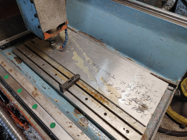

next step, the sides of the frame:
at first drilling the holes to hold the sheet:

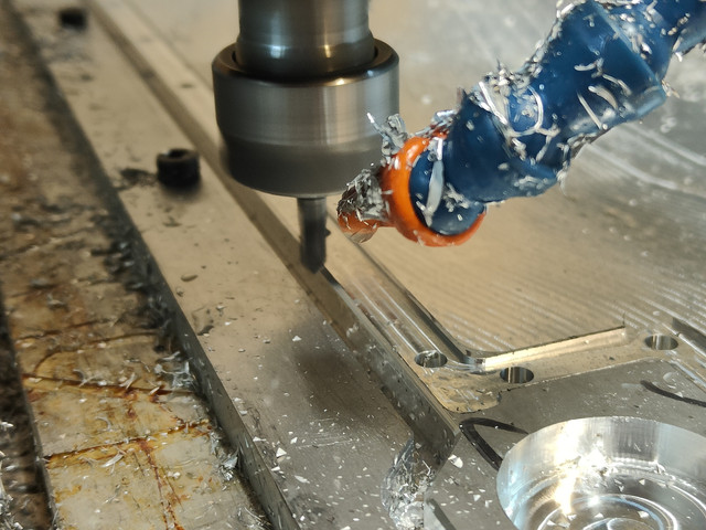

next big pocket milling:
cutting:
rounding the edge:
chanfering:
fisrt side finished:
