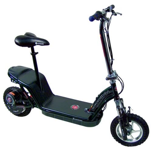

Hello everyone!
I'm not a 100% newbie but I know there are a bunch of smart people here and I'm not afraid to ask for your ideas and help. I checked all over the place and I haven't found any info regarding one of these style scooters being converted over to a brushless ourtrunner so I thought I'd get everyone's opinions and as much info as possible before going at it.
What I'm starting with:
Schwinn S750 as pictured below (not my actual scooter, just for reference).. I'll be taking many pics when the build starts though.
I got this used off craigslist for $100 with dead batts.... The next day I got a couple 8AH SLA's ($30 brand new, again off craigslist) that matched one I already had and slapped them in the scooter to just get it running. It's in pretty good condition for the price I paid, the tires still have plenty of life left on them. This thing is a BLAST and it's everything I thought it would be. However as everyone knows here SLA's are lame, and I want more speed and distance.
My wants:
Speed:30mph cruise speed so I'm guessing 35mph or so max speed
Distance: 15 hard miles
Brushless outrunner.
Hardware I think will get me there (off the top of my head without much thought put into it):
-Motor: Turnigy TR80-100-a http://hobbyking.com/hobbyking/stor...0-100-A_180Kv_Brushless_Outrunner_(eq:_70-55)
-Speed Control: Turnigy Monster 2000 http://hobbyking.com/hobbyking/stor...Turnigy_Monster-2000_200A_4-12S_Brushless_ESC
-Throttle: Would love opinions on this! Wouldn't mind making a thumb throttle.
BEC: Turnigy http://hobbyking.com/hobbyking/store/uh_viewItem.asp?idProduct=6320 (I already have one)
-Battery: I don't know, but I'm guessing hoping 20Ah will get me the spces I'm looking for.
Other MISC stuff to think about:
-motor sprocket (it'd be nice but not needing a freewheel sprocket) (I'd like to keep the stock chain size)
-Have a watts up meter to mount and use
-mounting the motor to the existing motor plate looks easy enough
Uses: I'll be using the scooter around town mainly to grab meals, going to the beach in the summer (don't have to fight to get a parking spot here in Southern CA, Los Angeles), and possibly visiting a couple of my clients that are close to where I live (I'm a computer consultant).
That's about it! I'm looking forward to hearing from anyone that is willing to give their input! Oh, and of course the info I provided above is just off the top of my head and I'm totally open to everyone's suggestions. That's the reason I've started this post!
Thanks in advance!

Do you want to have to kick start this scooter?
If the answer is no then may I suggest the following - look at outfitting an RC motor with hall sensors and think 6 fet infineon (plenty of room under the deck) for a reliable sensored controller in a good price range (they run about 30-50.00 avg).
Next look into how that motor you specified is terminated (check the rc forums or google) my guess is delta based on the kV and currents - I would personally convert that motor to wye which would increase the torque by 1.73:1 and decrease the kV of 180 RPM per volt by the same factor resulting in a new kV = 104.04 RPM per volt.
(honestly that motor is far too big for this scooter, you would be better off looking into the 3hp range like the tower pro 5330)
Now for 35mph on a 10" wheel (I think the S750 is a 10" wheel) we can do the following quick math:
35 (mph) * 336 = 11,760 RPM / 10 (" wheels) = 1176 RPM Required to sustain 35mph on a 10" wheel.
Now I am usually wrong but I have a scooter very similar so I will assume the onboard (default) reduction is somthing like 13t to 76t (I think that's my goPed ESR 750 gearing)... or 5.846:1 ratio reduction...
This means we need that motor to spin up to 1176 * 5.846 RPM or 6875 RPM minimum at pack LVC and under load.
Since you have the motor RPM you will need for 35mph travel - you can factor the rest of the build up:
Assuming the motor in stock delta termination is about 80% efficient (doubtful, maybe) we would need to take that into account to ensure proper RPM is available under load with losses so 6875 * 1.20 = 8250 RPM is actually the minimum no load RPM we are trying to acheive.
8250 / 180 = 45.83v
Since 48v is the max you are supposed to spin this motor up with... changes to your drive line will be required (more than just a simple swap up build).
Again I think that motor is way too much for the scooter... even with 4kw peaks and minor (5:1) reduction you would be hard pressed to keep the front wheel on the ground at anything below the maximum speed.
If your stuck on that motor for a specific reason, then the reduction needs to change...
if 48v is the maximum voltage it's calling for a 12S pack of Lipo (12 * 4.15v = 49.8v)... I'm assuming (it's specified as MAX afterall - not nominal)... so LVC for a 12S pack (conservative so the lipos last) would be 3.3v per cell or 39.6v at pack level.
Now reverse calculate the reduction required using the known kV (stock termination):
Motor Minimum RPM (no load): 7128 RPM
Motor Minimum RPM (assuming 80% efficient): 5702.4
So 5702.4 RPM under load for 35mph on a 10" tire is: 5702.4 / 1176 = 4.8489:1
Basically you need to count the large teeth on your 10" drive sprocket and see if you can acheive the 4.8489:1 or how close you can get - you could look at belt drive if you wanted to quiet things up, the hxt belts that recumpence uses in his drive systems are quiet.... you could also just source an appropriate motor sprocket and rig a bolt up frame mount.
The reason I recommended adding halls to the RC and using the infineon - now you don't care about freewheeling so much because you can regen brake (built in) and they are small enough for your purposes... they also have some advanced features for ev use that normal RC controllers just dont and finally the only area where I know of issues with these controllers on RC motors is in high RPM situations > 8 or 9K which are a non-issue for you.
Range is another thing all together... what peak currents do you expect or want to run, nominal?
-Mike

I think it's a 12" tire then...
Is this the model you have?
http://urbanscooters.com/P/Electric-Scooters/Schwinn/Schwinn-S-750-Scooter.html
Higher voltage is always better than higher current for the same power, that said... your scoot holds 3 SLAs in series for 36v right? That should provide plenty of space for a 12S/10S at 2-3P weighing about 9-12lbs total but able to deliver 200a or bursts of 300a.
That said... with proper gearing and an fairly efficient outrunner (I think Jermey Harris posted he gets upwards of 88% efficiency from a Tower pro 5330) the numbers need to be refactored for 12" diameter tires but otherwise... I see ZERO issue with going from your current setup to a whopper with 3x the power - doing a delta to wye conversion would add torque and reduce kv and no load current accordingly (and sometimes much more than 1.73 with regards to idle currents).
With regard to the controllers i suggested... doing hall mods is covered all over this forum so I will leave that for you to seek out, also converting many motor types from delta to wye and vice versa is also covered so I won't expand on that now but in your situation there would be very signifigant advantages.
One other issue those turnigy controllers, the general concensus (as far as I have been able to surmise) is they are not quite dependable with the types of loads we (and you) apply to them.
But the infineon specifically would be well suited as it has 3 programmable speed (current) limits... now stock I think they are configured for about 22 amps but can be programmed up to 35a or so without mod, with a second shunt in parallel - and you double the possible current... or just beef it up with solderwick.
In either case... S%2 is the default selection on power up so... Perhaps if you have 3hp on tap (at minimums) then I would say use 1hp for the normal mode (on 12S and 3.3v cutout you need to allow for 19 Amps - 18.93 a) and set Speed %2 for 33%, Speed %1 could be extra power mode at 66% and about 2hp and from 100-125% for 3hp.
There are other tricks you can use but... in terms of range, assume in 1hp mode (equal to your current motor) with average riding I would assume you will see between 18-20wh a mile consumption with pulse and go - this is a guesstimate not a calculated fact.... just somthing to think on... now a 12S2P pack (4 6S 5AH packs) would be 49.8v fully charged and 10AH of capacity in about 8lbs (or the weight of a single SLA) with a power density of 498wh and a range of 24mi at 20wh per mile and the physical space of about 1.5 of your SLAs but in 3 seperate sections... you could break this up any way you want... pull the deck off, hold up a yard stick and snap a shot... I don't know how your SLAs are laid out or their own dimensions - that will explain alot more in terms of internal clearances than anything else...
Given your estimated 30mph cruising but 35mph guaranteed minimum (passing and manuevers and such) I think avg wh per mi on such small tires will be pretty low... maybe even less than 30wh per mile and that's without accounting for eBraking (if it even works worth squat on 12" tires) - at 30wh per mi (I get this with a hub motor, geared running at 27mph) your pack would have about 16.6 miles - it would likely be more and you should be able to double the parallel packs up for a 12s 20AH pack and greater than 33.2 mi range.
