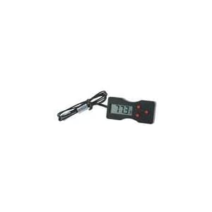

I'm about to install the hobby king VT temp sensor in my hub:
1) What epoxy to use? I've got some locally with a max temp rating of 150c. That's the limit for my hub as far as I'm concerned, so I'm not too worried.
2) Where do I glue the sensor? It's kinda big, and I don't want to worry about it rubbing on the cover.
3) I was thinking of installing one of these LEDS inside the hub just for fun. http://hobbyking.com/hobbyking/store/uh_viewItem.asp?idProduct=8941
They should run off 5v. I was going to epoxy it in with the sensor. If it dies, it dies. No biggie. Can I run it off the hall sensor, or the temp sensor voltage?

I'm still using the HK VT - http://www.hobbyking.com/hobbyking/store/uh_viewitem.asp?idproduct=9744
It works great. Only thing I don't like is that it cycles between temp and voltage. The alarm is loud enough and the blue LED alarm lights are a nice touch. The 150c limit hasn't been an issue because by the time the motor hits 120c, it's a boggy ride anyways. Really no point in pushing the motor harder than that.
I've found out that the sensor itself is a $1 LM35
Which opens up fun options for installing multiple sensors on the controller or battery pack. Just wire them up to a switch to change the temp sensor source.

I ended up ditching the hobbyking vt sensor because you can only read it in sunlight if you cup you hand around the display and peek through the little hole.
This is very frustrating if you are on a bumpy road.
As an added bonus TG3 is really light weight, so instead of having to zip tie it or something, you can simply sticky velcro it to your handlebars.
