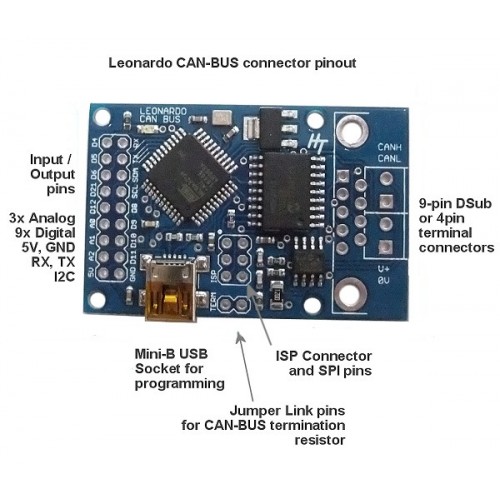

Good news !
I can confirm that just sending the 2 messages from the previous post every few seconds is enough to keep the rectifier logged in and keeping the set current limit.
I started with 2 seconds interval which worked fine. 10 second intervals were also fine. 15 seconds proved to be too long :lol:
This makes it very easy to make a microcontroller with CANbus interface and program it with just those 2 commands and a 5 second loop
I think this board may be a very good oppertunity.
http://www.hobbytronics.co.uk/leonardo-canbus
It has a 12 to 5V converter, arduino compatible microcontroller with bootloader, CAN-bus interface and a mini USB connection for programming.
The Flatpack S uses a 12 Volt Fan with 4 wires to keep itself cool. The Fan is powered by a continous 12V supply and uses a third wire to set the speed. I think the fourth wire is for speed detection but that's not important. The 12V supply for the fan can be used to power this microcontroller board (because it has the 12 to 5V converter). I just have to check whether the negative of the fan is the compatible with the negative of the can-bus.
There is also some small room next to the Fan of the Flatpack S (in the housing) to place that little board.
The full size of the board is 51x33mm but it looks like you can cut of the connectors on both sides (DB9 and header) to end up with something like 33x33 mm. That would fit perfect inside the Flatpack S.
The can bus connection points are in the back of the unit (the fan is in the front) but a small twisted pair wire, protected by shrinksleeve can be run from front to back to the little board.
That way the microcontroller board keeps setting the voltage and the current and you wouldn't see it because it is inside the Flatpack.
Thinking further you can put potmeters or pushbuttons on the microcontroller board to set the voltage or the current on the fly.
I think i'm going to order a board and maybe a small oled display as well to see if it works and if it fits inside the flatpack S.

I've gotten the Leonardo CANBUS board board in the mail today.
It's nice and small and the connectors are packaged seperately like they say on the website. Very Flatpackfriendly :D
This is how to connect it to the flatpack :
1. solder a twisted pair to the CANL and CANH solder pads on the right side of the board. There are screw terminals supplied in the kit but to keep the board low profile I chose to solder the CAN wires directly onto the board.
2. make a bridge on the TERM solder connections to terminate the RS-485 with 120 Ohms. The 2 TERM solder pads are on the mini-USB side of the board.
3. connect the other side of the can bus wires to the canbus on the flatpack
3. Install the arduino software (available for free from Arduino.cc)
4. Connect the leonardo CANbus board with a USB to mini-USB cable
5. Copy paste the code into a (arduino) sketch.
5a. At the top of the sketch there a 5 lines of code to set the : current limit, output voltage, overprotection voltage,5 or 60 seconds walk-in and the step the current limit takes as you push a pushbutton connected to D11 and GND. Change these as you see fit.
6. Select the appropriate settings in the arduino program (board : leonardo)
7. activate the serial monitor at 115200 baud in the arduino program
8. hit the upload button (to upload the code into the can board)
9. The LED on the board lights up every time a message is received or transmitted
10. The serial monitor shows all received and transmitted data and gives an explanation of what is sent or received
11. build the board into the flatpack
12. enjoy a adjustable voltage (43.5 - 57.6 Volt) and adjustable current limited (0-41.7 Amps for the flatpack 2HE, 0-37.5 Amps for the Flatpack S) powersupply
13. if you connect a pushbutton switch to D11 and GND the current is adjustable in steps of 10 Amps
OLED display version to follow :)
Also to follow is whether the 12V from the fan can be used to power the board, this way it can act fully stand-alone, but you can monitor it through the mini-usb. Now it is powered through the usb.
